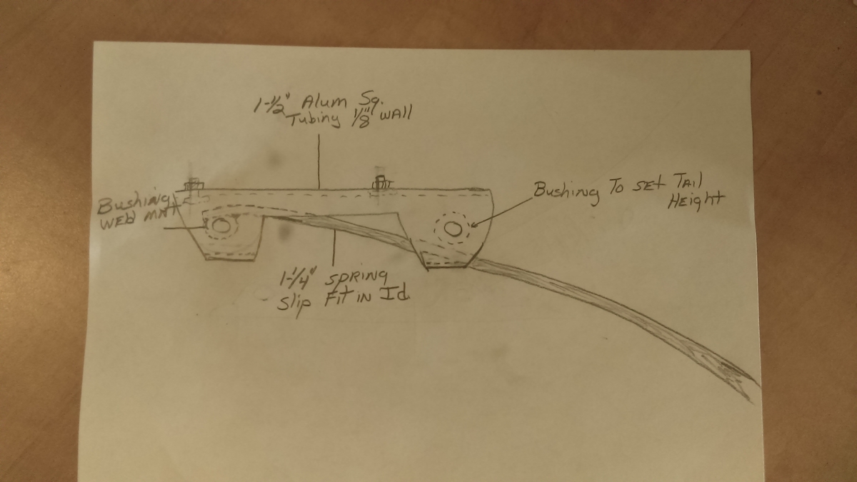

end design and getting it mounted. Stayed with something light and simple and with bushing thickness I can gain or lose height from rudder base to ground by nearly 2 inches.
  • 3 weeks later...

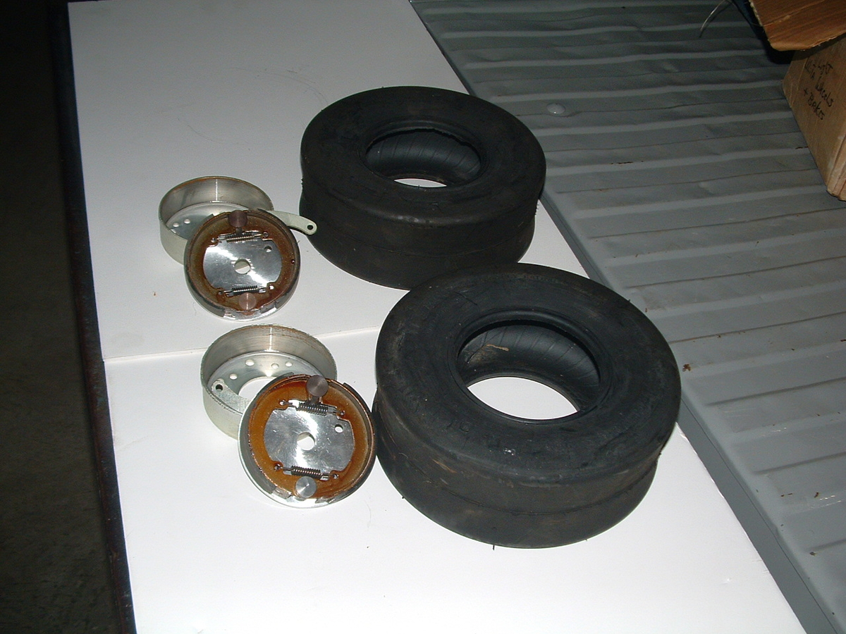

Well got the tail wheel mounted and picked up some tires and brake shoes and hubs. Will order Azusa rims soon and get busy on the mains. I came up with my own tail wheel mount and it really works good and found no need for a added shock and weight. I'm plugging along on a very fun build.

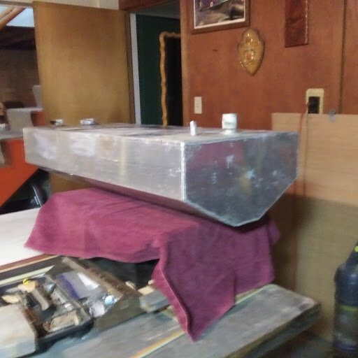

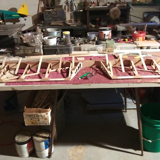

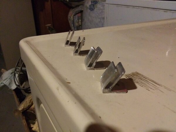

Still working away on the t-mono started to tackle the wings and fuel tank and the 1000 other things yet to come. came up with some tabs for mounting wind screen from an old bug deflector from my truck. Fuel tank is twice of what I need but a fellow T-mono builder in Florida will use the other half. I trying to shift the tank back towards the main spar closer to CG mounting just under the upper longerons front of tank will be about 8" from fire wall and run back to instrument panel. Talk about having the fuel sitting on your lap :yikes: I may drop from 10.5' DEPTH TO 7.5 or tapper from 10.5" back to 3" aft. I think that would fit the mission better. One thing fella's I'm still having fun just hoping I don't mess up those Diehl wing skins for one the cost and second I don't think they can be bought any more.

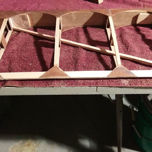

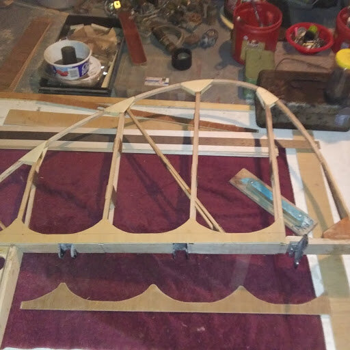

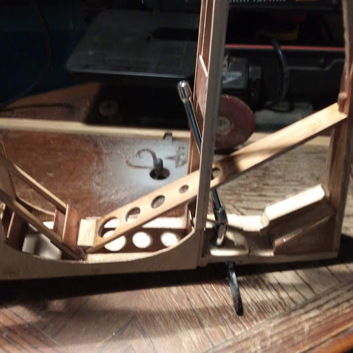

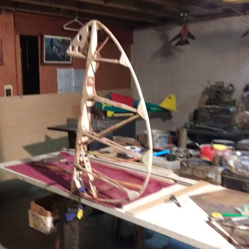

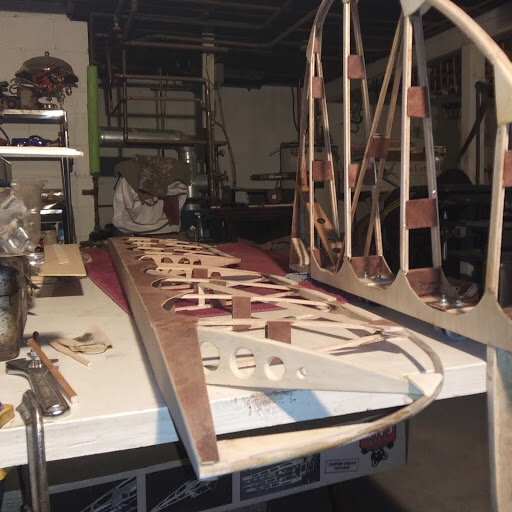

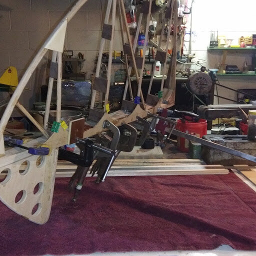

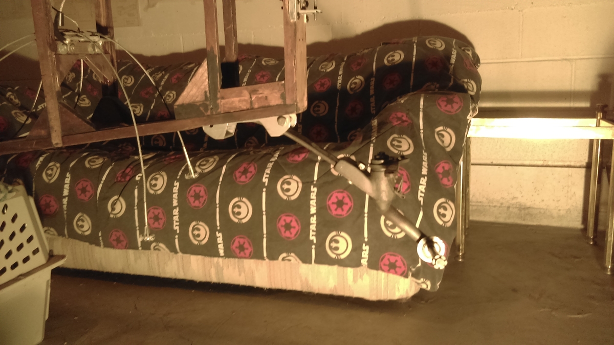

I have gained ground in the tail feather part of the build by detailing the rudder and elevator by adding balsa and getting the surface flat on the same plain as the fabric will lay. The one picture that has a socket extension is to show how I drilled a access hole to get to bolt heads once the bottom part of rudder is covered with ply. Build has still remained a enjoyment and plenty work left to have fun. :thumb up:

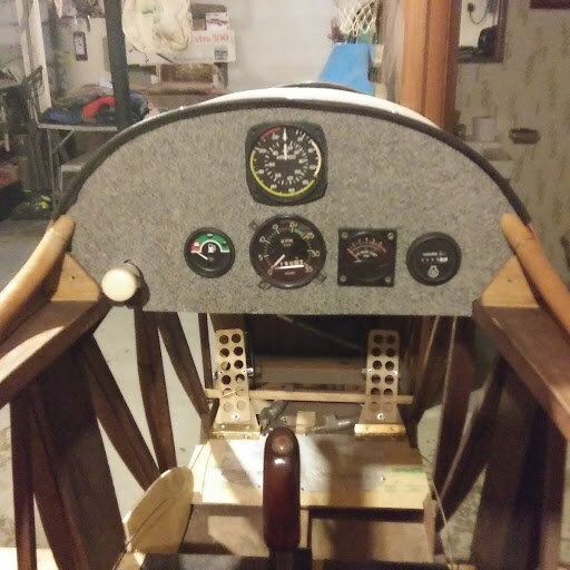

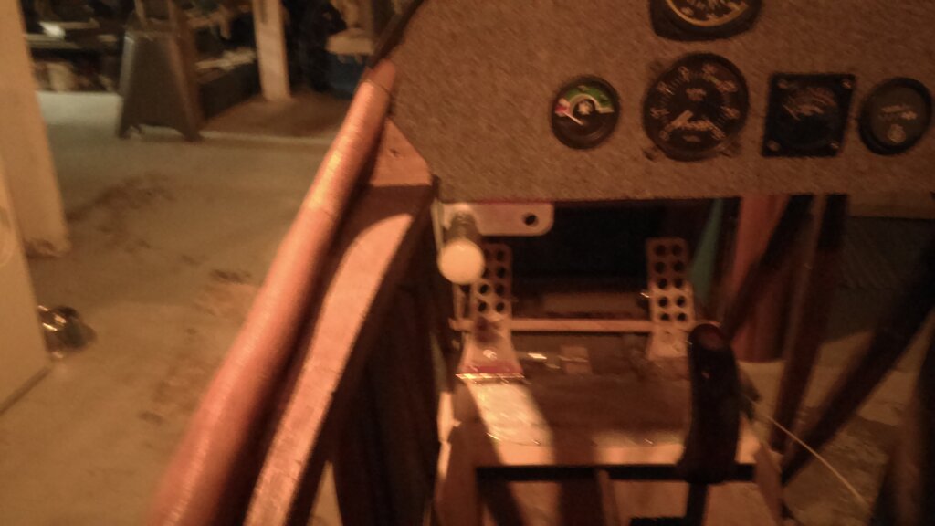

I believe your absolutely correct Nev. first was the Taylor-mono then the Taylor-Titch. Tho they are common across the pond but here in the states there rather  rare . I would love to post all my project pictures here but I imagine the forum has limits? I try and post pictures of any changes I made concerning the Technic of the build and how I changed some of the cable routing for elevator. One thing I did lately was to move my throttle knob up in the bottom left corner of dash to allow clearance of the back of header tank. It was a easy fix because I was able to use the same holes for Alum angle that is used for the throttle cable mount. As any builder knows a person must be patient when building a plane. Pictures are of the throttle position change and the other hole in Alum angle mount will be for Carb  heat control. I have plenty room left in instrument panel for other planned items yet to be installed.

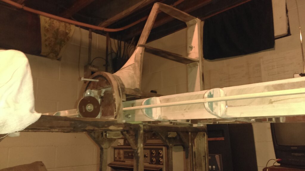

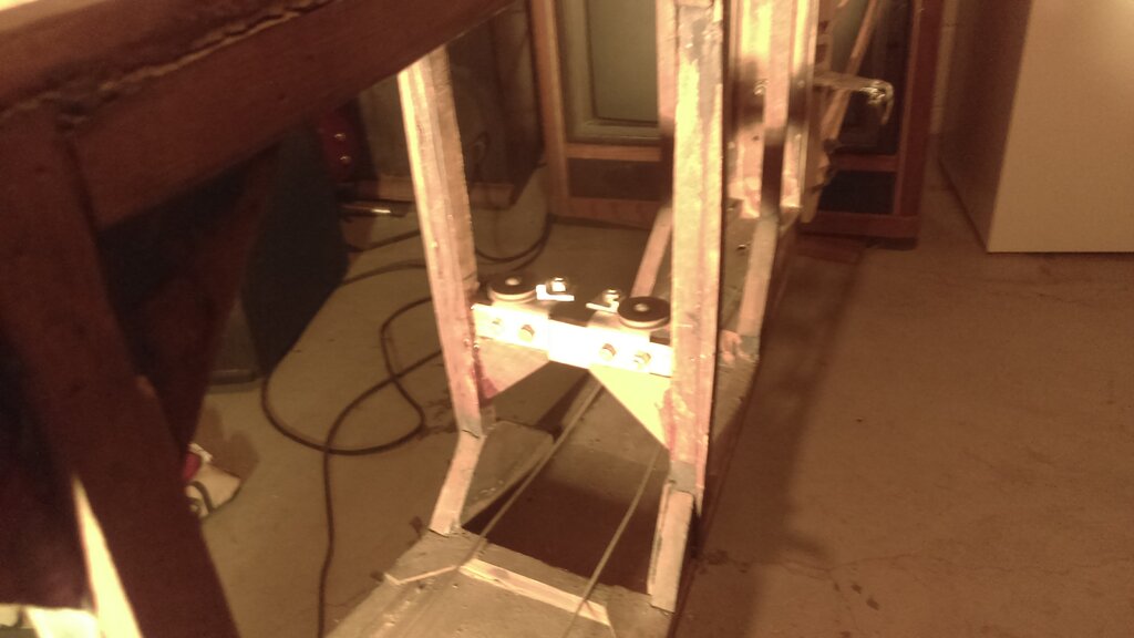

Nev. I've been researching a way to get trim for the elevator beings there is no trim on any of the controls. The rudder I can add a external hand adjustable tab but the elevator is another matter especially with CG issues with fuel burn off. I have a  duel pulley behind the rear root spar as poor picture shows and kicking around an idea by using a cam type system or jack screw to get at least up trim or possibly both  on elevator. the print call for two sets of cables for elevator one set running internally down each side of Fus. Besides if I loose elevator control I'll just roll it on it's side and land with the rudder. :black eye: JK JK  :yikes:

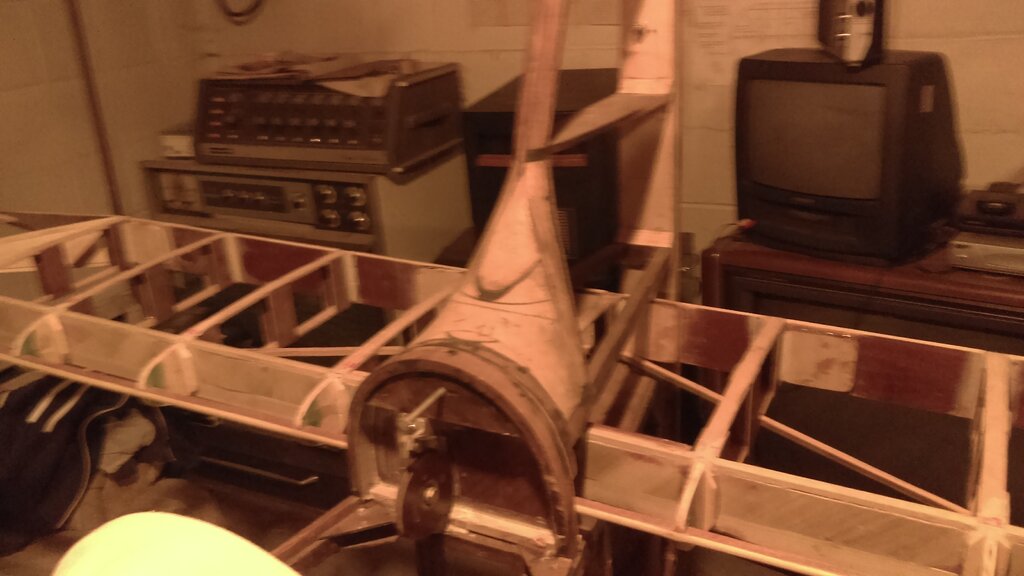

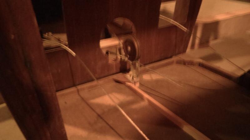

As it stand right now I plan NOT to have any electrical in the plane mainly because of the limited room FWF. We all have access to some amazing hand held GPS and radios. The airbag idea was just that. I was thinking of a way to raise and lower the leading edge of the Horz stab for in flight pitch trim instead of having a trim tab but its way to complicated for this tiny bird not to mention the weight and risk involved. In the picture you can see how I mounted a pulley in front of the Fin for the elevator cable. The prints show the cable's running threw a fair- leed and once that wears threw you start cutting wood because at that area the cable changes direction about 30 degrees. The last picture is of the pulleys I added for rudder cables before they exit the Fus. again on the prints the cables are actually ran threw the vertical uprights near the rear root spar and also with fair- leeds.
