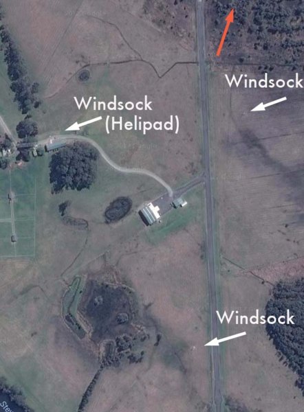

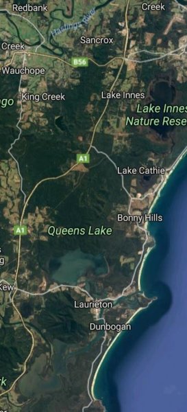

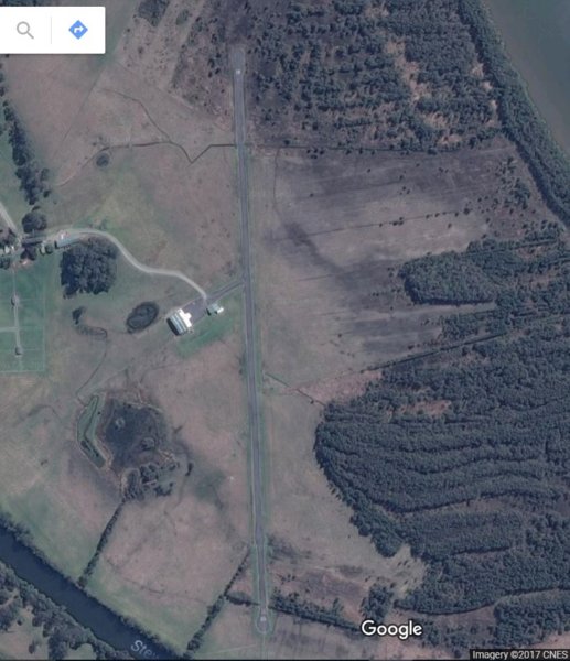

turboplanner Posted November 1, 2017 Posted November 1, 2017 The crash is reported 400 north of the airfield in the left photo near Johns River. South of the clubrooms, close to the strip is a white dot, which could be the wind sock. In the second photo, this strip is down at the bottom left corner of the photo and the Port MacQuarie airport can be seen at the top right corner of the photo. To have hit that windsock (if that's what it is, could indicate pilot incapacitation, or maybe the partner trying to get it on the strip (pure speculation I know).

pylon500 Posted November 2, 2017 Posted November 2, 2017 Have heard now from different sources regarding a windsock being at the crash site. There is a lot of bushland around the airstrip, and although I think I remember there being fences around the strip, there may well have been an animal problem on the strip. Scenario; On approach pilot see animals, initiates go'round, pulls to right of strip to observe animal movement and inadvertently hits windsock? Totally speculation. 1

pylon500 Posted December 15, 2017 Posted December 15, 2017 Makes it seem as if it was a "straight in" but no time stated for when radar was lost. That would tell if he did a low pass and come around again or lost it coming straight in.Lost the left engine on late final in the end? Some more speculation and assumed facts; I'd only met the pilot, and flown into his strip a few times. Runway preference was usually 34, as approaching 16 tended to be down the face of the local hills. Circuit direction onto 34 was usually right hand, once again due to close proximity of the local hills. The approach profile could be interpreted as joining a R/H circuit for 34. Fuel mismanagement would seem unlikely for a pilot that made a hobby of international ferry flying, but... *No mention in the report of the presence of the windsock at the crash site. Hopefully his GPS systems may shed more light on what happened. * Will have to keep following the investigation.
