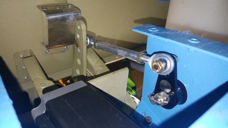

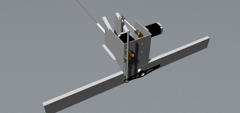

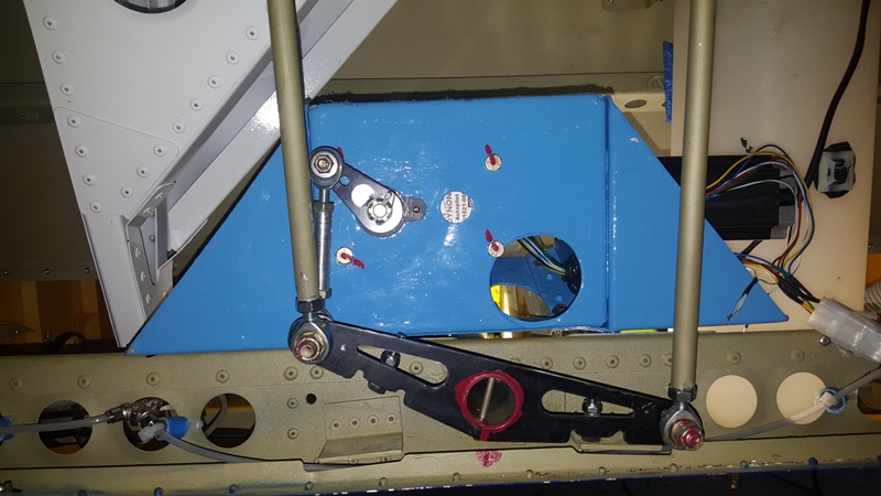

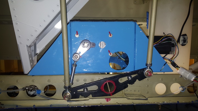

I am in process to install Dynon EFIS D10A with AP74 and SV52 servos. My Idea is to install the servos as per below photo. Any comments will be much appreciated.

  • 3 weeks later...
Bummer....I wonder what the issue was....maybe thats a project I need to look at in the future. We have the technology
So how is your prototype coming along?
  • 1 month later...
Steve...too many prototypes around the workshop now...maybe when i get a few of them squared away
