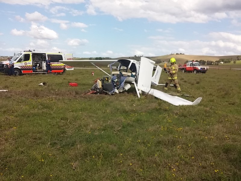

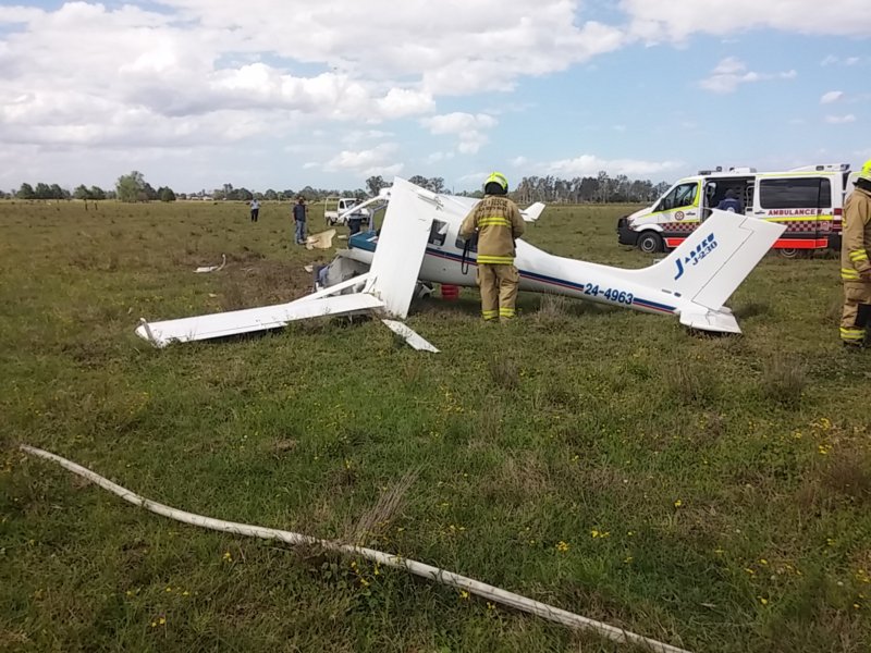

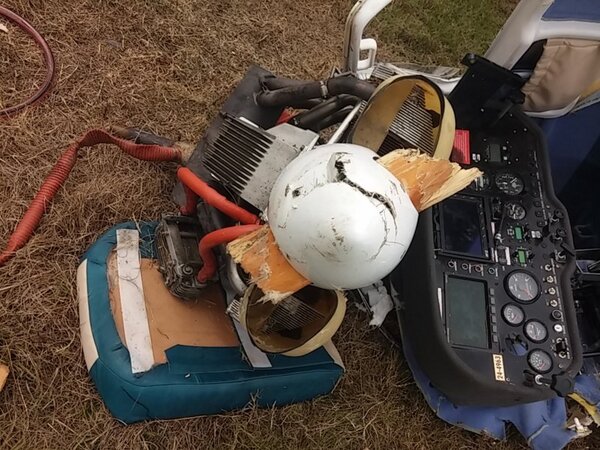

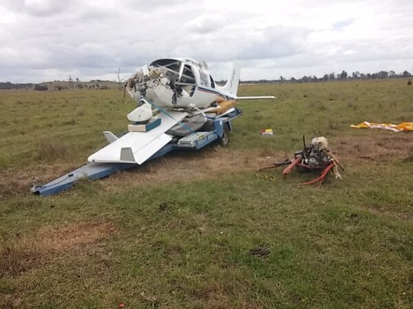

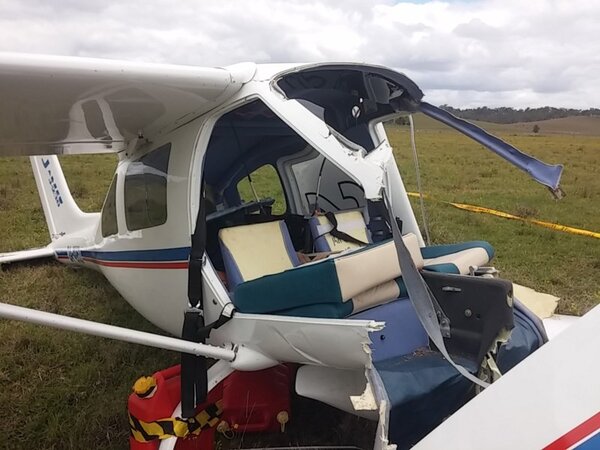

kgwilson Posted October 12, 2016 Posted October 12, 2016 A Jabiru 230 crashed shortly after takeoff from Runway 26 this afternoon. Two people were on board and were injured. They were both walking when the ambulance got there so that is very good news. The aircraft is a writeoff. The engine bay area was destroyed. The firewall peeled back and was under the aircraft so the occupants were looking out onto the empty paddock when it finally came to a halt. The left wing was destroyed but the right was untouched. At this stage we do not know what happened but the wind was east to north east and fairly light so the takeoff was down wind. One possible explanation and I stress that this is purely speculative, is that the aircraft stalled in the turn and there was insufficient height to recover. The flaps were retracted. The spinner was intact but there was only about an inch or 2 of wood left of the prop indicating the engine was reving pretty high at impact and it impacted fairly flat. This is another example of the strength of the Jabiru airframe. 3
cooperplace Posted October 12, 2016 Posted October 12, 2016 fabulous that they walked away, and good to hear that it's not an engine failure. Someone will use the right wing!
Guy s Posted October 12, 2016 Posted October 12, 2016 Crikey there's not much left of the front end and luckily the motor peel underneath and didn't end up on their laps, glad to hear the 2 people in the Jab were walking and not too seriously hurt I hope.
alf jessup Posted October 12, 2016 Posted October 12, 2016 A testament to probably the best survivable airframe in the recreational aviation fleet Cannot doubt how many have survived Jab incidents 5
