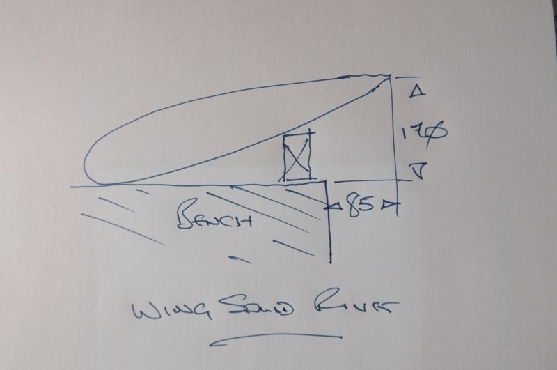

Solid riveting:The solid riveting relies, amongst other things, on holding the tool straight for every rivet. Unfortunately, I have never been overly good at eyeballing 'straight' with tools. To even the odds:
I borrowed a good squeeze from a local LAME, and bought the correct AN470 AD3-3 die to go in it.
I bought 1/4lb (gotta love those imperial measures!) of AN470 AD3-3 rivets. That's them on the right, with head shape to fit squeeze.
First I set up the tool to give correct amount of squeeze: this one just screws in and out.
I then set up the wing raised and over the edge of the bench, so that the bench edge acted as a guide for the squeeze.
This way, with the squeeze rested on the bench edge, the 'fore and aft' angle of the tool was the same for every rivet. All I had to do then was ensure the tool was straight up and down when viewed from behind.
Cleko every 3rd hole. I did not clamp or support the trailing edge, but checked very carefully as I went. The TE is dead straight.
It went easily, with no misfires, and I am very happy with the result.

Wing position for solid riveting:
