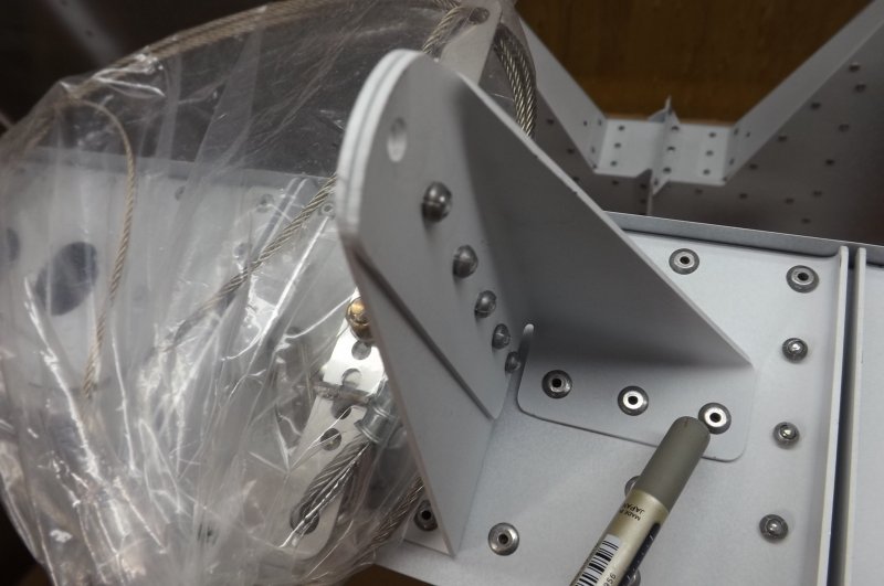

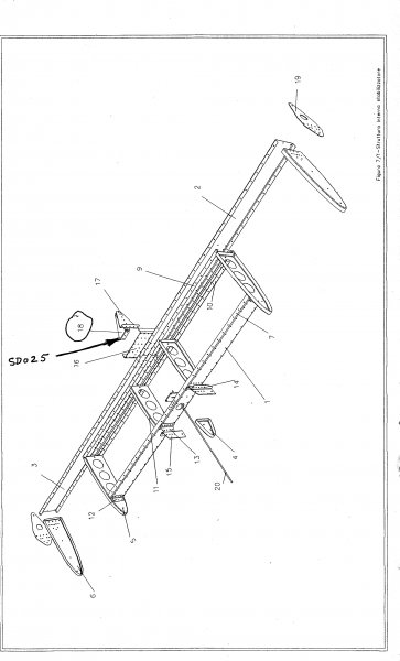

JG3 Posted June 12, 2016 Posted June 12, 2016 Awhile ago Bill Grieve mentioned that someone had noticed a missing rivet head on the Elevator Hinge Reinforcement, part # SD025, and a couple of other aircraft were found with the black stains around the rivet heads that indicates movement.... I checked my aircraft and found all three rivet heads missing altogether, allowing the elevator to wobble sideways about 20mm! The purpose of that bracket is precisely to stop sideways movement of the elevator. The movement didn't show up in pre-flights because I just worked the elevator up and down for free movement but didn't push-pull sideways.... You can see those rivets by peering upward from under the right side of the elevator. There are three rivets in a horizontal row. It wasn't difficult to replace the rivets. Just needed to cut away a small tab of the skin on the underside of the elevator, and needed a close fit right-angle drill to drill out the old rivet cores. Then could just reach in with a slim model riveter. I used 3/16" stainless rivets time, and will be keeping a close watch on them and their supporting structure. Can't figure how those rivets could have felt the stress needed to break them..... But also checked a Zenith 701, which is identical construction, and found one rivet sheared, so it's a common issue. Everyone with Savannah and 701 aircraft need to keep a close eye on those rivets..... I don't know if anyone has informed ICP yet, but there should be an AD in that regard. JG 1 1

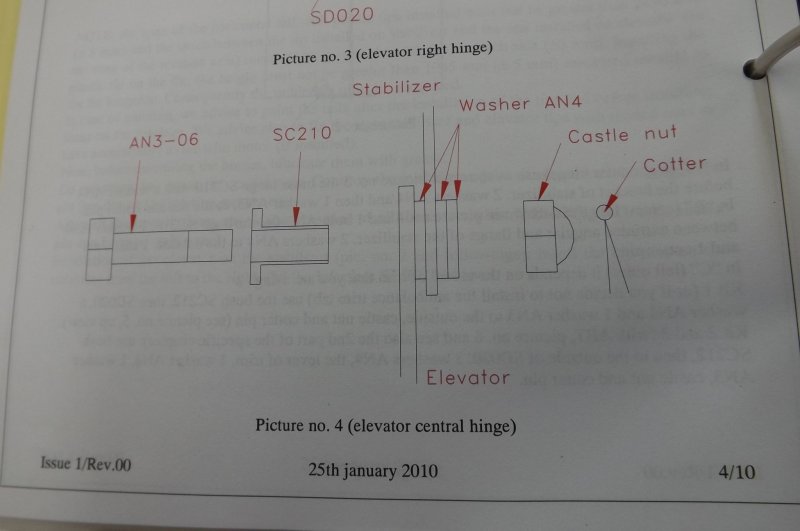

IBob Posted June 13, 2016 Posted June 13, 2016 For what it's worth, the centre hinge on my S can be set up, by the book, with little or no clearance. In fact you could probably discard one of the two RH washers. The drawing itself is not quite correct, as the Stabiliser is two thicknesses at that point, being SD024 and SD025 riveted together.
rankamateur Posted June 13, 2016 Posted June 13, 2016 Maybe two or three of the rivets could be replaced with bolts for peace of mind. 2
IBob Posted June 13, 2016 Posted June 13, 2016 Hindsight being 20/20, you can see with that setup that most of the lateral load will be taken by the end rivet, rather than shared between them...still, it's not easy to understand how there could be that much lateral load. Since Facthunter (I think) recently pointed out that you can fly without roll and yaw, but you cannot fly without pitch, I find myself very focused on this elevator! 2
Nobody Posted June 14, 2016 Posted June 14, 2016 Maybe two or three of the rivets could be replaced with bolts for peace of mind. Or you could use a solid rivet with its higher strength.... 1
IBob Posted June 14, 2016 Posted June 14, 2016 I would think a first step is to ensure that the central pivot is set up to be free of lateral movement or slop. It would be interesting to know if aircraft where this has occurred are set up this way; also the condition and slop of trim tab pivots and linkages. This is speculation about possible causes, but far better to fix the cause, if at all possible. After that, regular preflight checks of the outer rivet for signs of movement, and prompt action should that occur should be enough: it seems highly unlikely that the setup could go from all rivets secure to all rivets failed in one flight. Beyond that, one 'correct' fix would be to mirror SD025 on the other side of SD024. That way, the forces currently working as a tension (and primarily on the outer rivet) would become a sheer force working on all rivets in the mirrored bracket. Yes, I know, more bits, more weight...
rankamateur Posted June 14, 2016 Posted June 14, 2016 it seems highly unlikely that the setup could go from all rivets secure to all rivets failed in one flight. One rivet can't move without all the rivets on that half moving so there would be movement for months or years before the heads come right off the rivets. The grey halo around the heads of the rivets would be the first sign. 1
