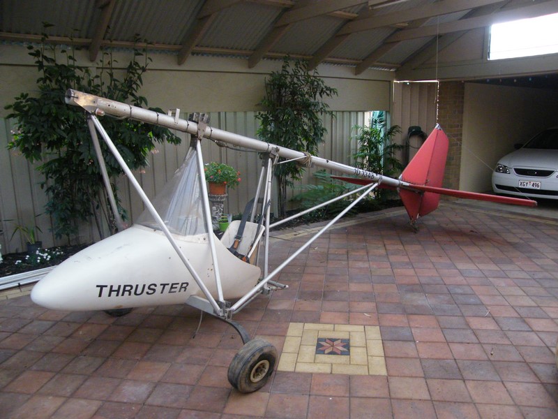

Deskpilot Posted February 17, 2018 Author Posted February 17, 2018 Today my Thruster saw the light of day once more. On 3 wheels again as I begin a huge clear out in my garage/workshop. As you can see, still a long, long way to go. 1

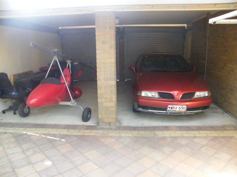

Deskpilot Posted February 19, 2018 Author Posted February 19, 2018 Almost a matching pair as a loan car sits in my garage. Smashed my Falcon into a wall (wide sandals covered throttle and brake simultaneously). I reckon the number plate should be on another make of car. 2

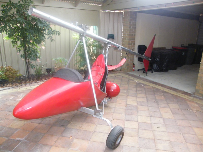

Deskpilot Posted August 5, 2018 Author Posted August 5, 2018 Ah, now it's looking more like a hairy plane Only problem is, that muffler never came off the plane. The rear location bracket is way out of position. To make it fit I'll have to drill out the rivet on the boom and move the mounting bracket to fit the muffler. Still trying to source a 1 mtr square piece of poly-carbonate sheet at 1.5 mm thick. Local price has been quoted at $130. Bex tells me it's $13 in china, but how to transport it. I think I'll be going with the 1 mm stuff at about $40. 1
