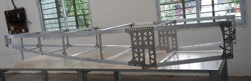

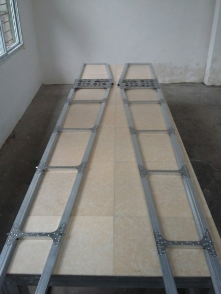

Marty_d Posted May 27, 2016 Posted May 27, 2016 Well based on some of my posts immediately above, this was today's proceedings .. [ATTACH=full]43259[/ATTACH] [ATTACH=full]43260[/ATTACH] [ATTACH=full]43262[/ATTACH] [ATTACH=full]43263[/ATTACH] [ATTACH=full]43264[/ATTACH] [ATTACH=full]43265[/ATTACH] Are they 1/8" rivets or 5/32"?

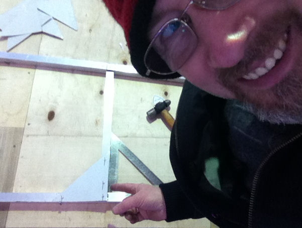

pylon500 Posted May 27, 2016 Posted May 27, 2016 If you're going to metal skin the sides of the fuse, it's not worth making steel (or whatever) fitting to hold the vertical stiffeners. A small aluminium triangle bracket on the inside would be plenty. It could include the locating tag for the cross member. Truth be known, the square tube stiffener is overkill as well, even if you only intend to skin with 0.016 thou.
bexrbetter Posted May 27, 2016 Author Posted May 27, 2016 If you're going to metal skin the sides of the fuse, it's not worth making steel (or whatever) fitting to hold the vertical stiffeners.A small aluminium triangle bracket on the inside would be plenty. No, thanks, a small aluminium triangle is not suitable for my goals. There is more than just engineering reasons to pool methodology choices from. I have built a Morgan, I know all about small aluminium triangle gussets and here is the very first one I did.. "WARNING: Horrible image will appear next, those with heart or nervous disorders please look away now* 1 1

Marty_d Posted May 27, 2016 Posted May 27, 2016 Well based on some of my posts immediately above, this was today's proceedings .. [ATTACH=full]43259[/ATTACH] [ATTACH=full]43260[/ATTACH] [ATTACH=full]43262[/ATTACH] [ATTACH=full]43263[/ATTACH] [ATTACH=full]43264[/ATTACH] [ATTACH=full]43265[/ATTACH] I'm guessing you've already picked up on this... would it be worth moving the rivets near the tab so that the cross member end doesn't go right on them?
bexrbetter Posted May 28, 2016 Author Posted May 28, 2016 I'm guessing you've already picked up on this... would it be worth moving the rivets near the tab so that the cross member end doesn't go right on them? Yes, a few things need to be juggled, this is just first test run stuff. It's only 5 minutes work to rectify it later.

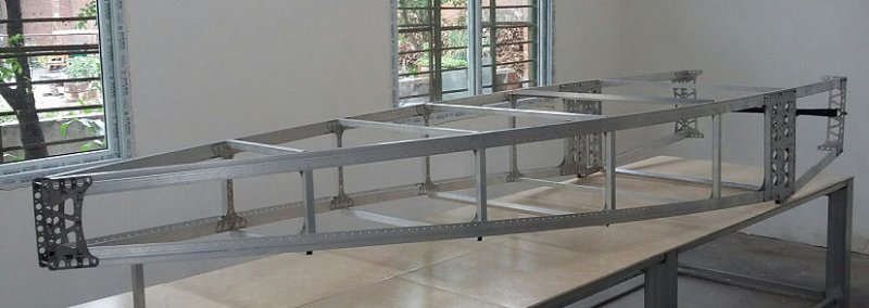

bexrbetter Posted May 28, 2016 Author Posted May 28, 2016 ...and then there were 2 sides. Almost time to make a boat. 3
rgmwa Posted May 29, 2016 Posted May 29, 2016 Almost time to make a boat. A ladder looks doable too ... rgmwa 1

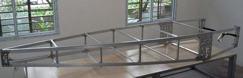

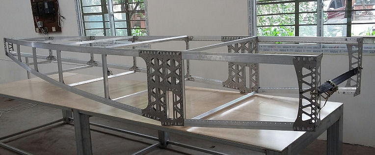

bexrbetter Posted May 30, 2016 Author Posted May 30, 2016 Row, row, row your boat gently down the stream ... A single bolt is holding the tail together otherwise nothing but the strap at the front, no rivets or fasteners otherwise holding the basic boat together, just geometry. 9 1 1

Old Koreelah Posted May 30, 2016 Posted May 30, 2016 Looks intriguing, Bex. How does the weight compare to traditional airframes?
bexrbetter Posted May 30, 2016 Author Posted May 30, 2016 Looks intriguing, Bex. How does the weight compare to traditional airframes? I'm not sure what a "traditional" weight is, all I can say is that if I don't have a craft that's low 300kgs and 6g's then I'm probably not in the game, competitively priced or not. I am currently under target but there's always stuff missed so we will see. If it's a bit heavy I'll just take Marty's lead and drill holes in the wings. 1 1
gandalph Posted May 30, 2016 Posted May 30, 2016 You'll need to watch out for the onset of flutter on that front strap..... 6 1
Marty_d Posted May 31, 2016 Posted May 31, 2016 You'll need to watch out for the onset of flutter on that front strap..... Strap? That's the new Bex engine... hook the prop on it and wind it back 2000 times before flight... 9
