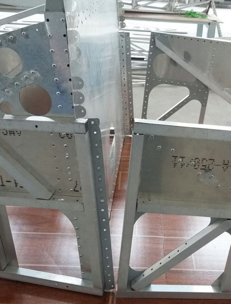

Nothing overly special today, just fitting up the turtle deck and tail to the new sides and some internal bracing in the tail ...

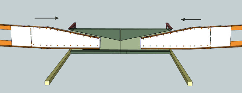

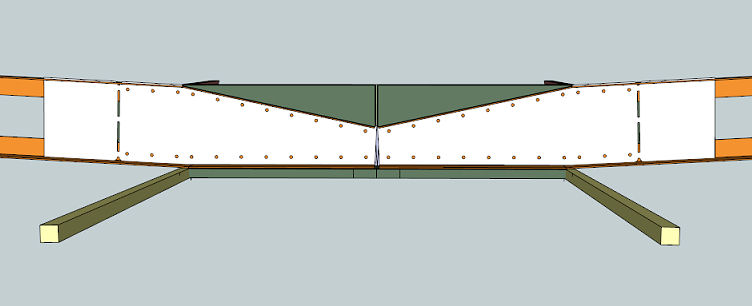

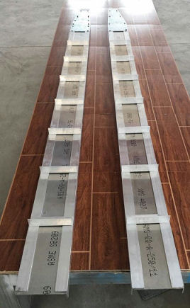

Soooo....

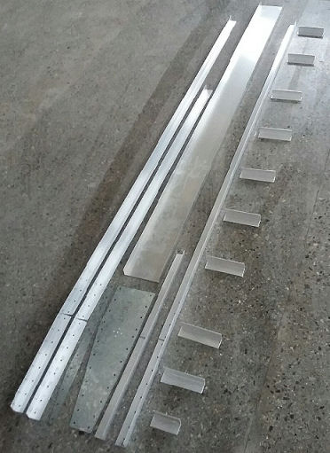

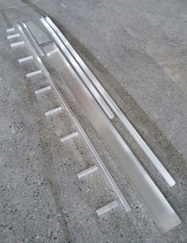

Over the weekend I redesigned the wing box for some good reasons, as well as ever, simplicity, speed and cost.
Yesterday and today busy building it.
The theory is simple, tapered wing ends into a tapered, self locating and aligning. I just got enough of one partial wing finished tonight and it works a treat, fits so damn good that I actually am concerned about taper stiction, I had to wiggle it quite a bit to get it back out!

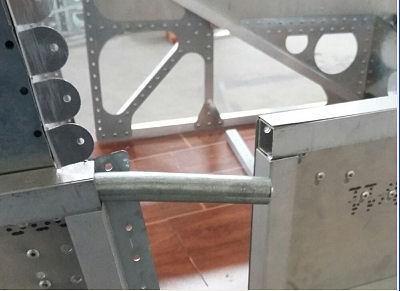

.. and also putting the front half back onto the rear half, note the carry through tubes that someone was concerned about. Also note there is a substantial outer joining plate not shown yet.
  • Like 4

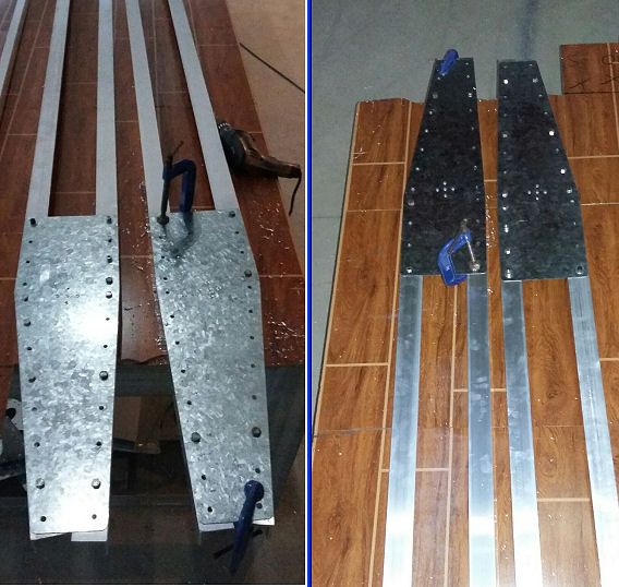

A question re the wing box - given that the box itself is full spar height over its length, wouldn't the spars be stronger being full height all the way to their end? Or is there no strength difference because the sum of the spar and box heights anywhere along the taper is the same as the spar being full height?
  • More 1
There is no loss of strength tapering.
Besides ease of locating, you gain secure, zero clearance fit that strengthens the sum as a whole, you can not have zero clearance fit with parallel spars (without mechanical devices).

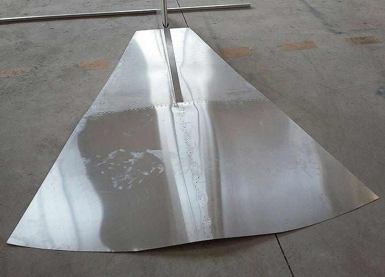

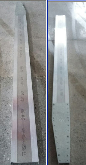

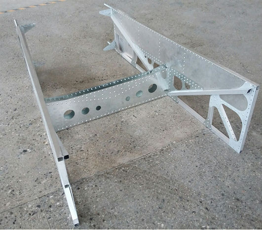

So this is what the wing is looking like (in progress), note I use a folded C channel shear web, besides a little added strength, it's main function is as a jigging entity that keeps the assembly dead straight ...

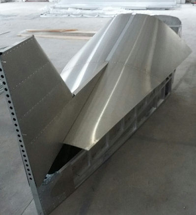

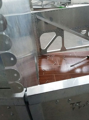

Annoyingly the rear turtle deck front skin was a little too short (25mm/1") and I had to make a new one. So I decided to make it just one piece and rivet to the spine as you can see here.
Good thing is the entire rear turtle decks and tail can be assembled on a flat bench or floor in one piece as you see here then simply added to the frame as the one piece, of course I've set it up so that's all also self jigging. It's darn easy.

How are you locking your wings in place Bex?
I have determined a number of ways, not critical thinking at this point.
