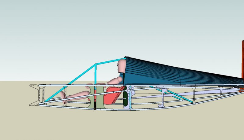

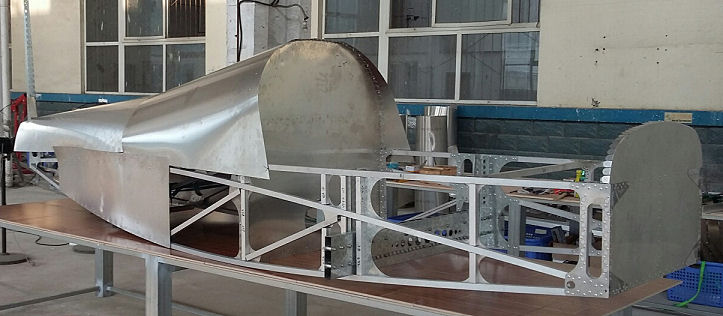

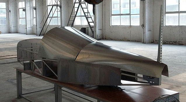

bexrbetter Posted September 9, 2016 Author Posted September 9, 2016 Funny, alerts says 3 new posts here but I can't see any of them. Anyway, still mapping out a bit of bodywork, this is not final nor possibly representative of final, just playing around to see what I like, what fits, etc ... and note the very rear turtle deck is unsecured, untrimmed, way too long and splayed out. In other words, don't judge based on this. 5
bexrbetter Posted September 9, 2016 Author Posted September 9, 2016 Let me explain part of the quick build system going on here. Obviously there's 3 longerons. The temporary short side panel is held in place on the lower 2 longerons with a few rivets but none in the top longeron. The turtledeck sheet is slipped inside the side panel inbetween the top longeron. The sidepanel has pilot holes already and you then merely drill all the holes through the side panel, turtledeck and longeron in one go, slip the turtledeck back out and onto the outside then rivet away. Simple eh! The pictures above still have the turtledeck slipped in the inside with just a couple of rivets either side solely for the purpose of testing. 3

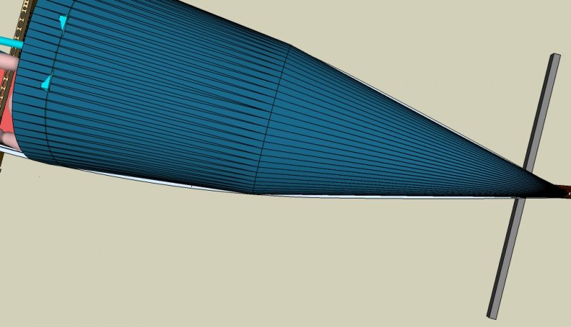

Marty_d Posted September 9, 2016 Posted September 9, 2016 I like your double angled turtledeck. At first I thought you were going to have a single one and couldn't see how that could work with the curvature of the side frames.
geoffreywh Posted September 10, 2016 Posted September 10, 2016 so where is the pilot's bum relative to the spar? The turtledeck has no formers or lengthways support? wood wood be nice....
bexrbetter Posted September 10, 2016 Author Posted September 10, 2016 couldn't see how that could work with the curvature of the side frames. The turtledeck has no formers or lengthways support? Go check out Morgan builds turtledecks, besides a number of others. As I said in your thread, aluminium more flexible than I think you imagine. The large 180 degree curved turtledeck is massively strong as a single entity without ribbing but will have a large rib for anti-buckling failure. so where is the pilot's bum relative to the spar? Still between the top of his legs and below his waist. 2

bexrbetter Posted September 10, 2016 Author Posted September 10, 2016 I like your double angled turtledeck. At first I thought you were going to have a single one and couldn't see how that could work with the curvature of the side frames. Actually Marty even the 3D doesn't agree with the double curvature either, a difference of what a computer knows compared to hands on experience. 2 1
