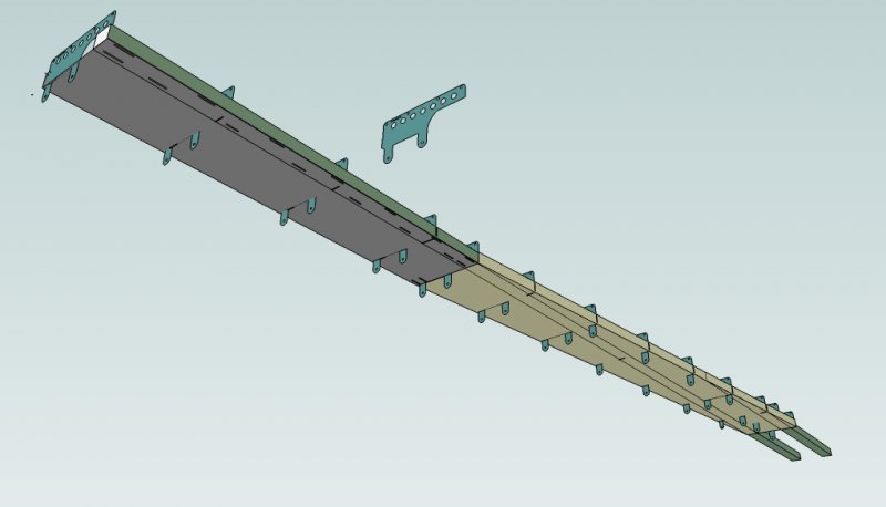

bexrbetter Posted August 16, 2016 Author Posted August 16, 2016 How many joins in that wing section, Bex? How are the joins made? Doesn't every added join weaken the member? Isn't it better to have one complete, untouched member for the section, for strength? There is only the yellow and grey sections with a continuous beam ("untouched section") through them and a short lower beam. The yellow spar is stock 2 x 1 meter sheet retaining it's 2 meter length as is the grey spar simply retaining the 1 meter width (as it's length) stock meter sheet. At this time for the proto it will be welded. I didn't think Bex said less effort. I thought it was the material list was no different It is less effort when using stock materials list. The yellow spar is simply cut, folded, and slips straight onto the spar beam, no measuring or critical alignment etc. required (note the red arrows). It works, it's foolproof and rough assembly of the whole wing spar takes only a couple of minutes (unsecured). There's more to it there that you can not see. 1

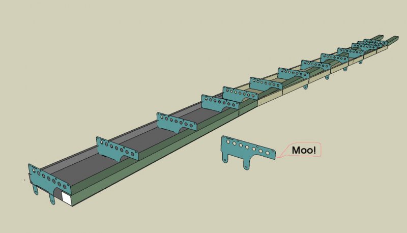

bexrbetter Posted August 16, 2016 Author Posted August 16, 2016 Then we have all these little braces that I call cows, cause they look like cows duh, that of course brace the assembly and go through the spar to carry the ribs on both sides ... I have to add a couple of rib tabs on the back side, or front side, I haven't decided which way 'round it goes yet. These are all done by the way. 3 1 1
