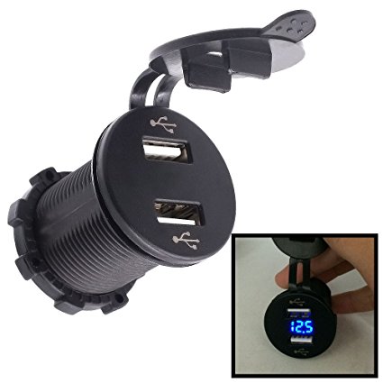

cscotthendry Posted October 28, 2017 Posted October 28, 2017 I found a neat gadget at the caravan sale on now at the Brisbane show grounds. It is a dual USB charger with a built in volt meter. $25 if anyone is interested. They're at the HardKorr stand. I think the show ends today and these items don't show up on Korr's website. You'll have to go into the caravan show but it's worth a look. Be quick! 1
