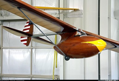

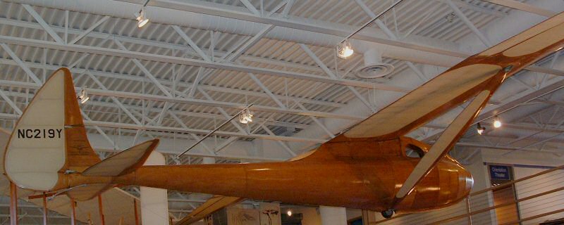

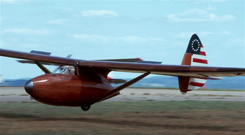

Deskpilot Posted March 3, 2016 Posted March 3, 2016 Not quite what you're thinking about but a 'wooden motor glider could look the 'bee's knees'
kasper Posted March 3, 2016 Posted March 3, 2016 Yes the Bowlus Baby Albatross is a lovely looking little glider ... but I prefer the Backstrom Plank for simplicity and there was 1 powered plank development ... less to build if you leave off 10 ft of fuselage and all the tail group :-P Sorry to derail the thread - back you your design for a powered motor glider ...

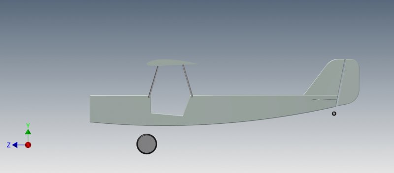

oldcrow Posted March 4, 2016 Author Posted March 4, 2016 interesting thoughts, thank you. constant chord is what I was going for because it is easier to construct. I know that hanging out in the wind will cost me glide performance but I am not looking at a completion glider. 20:1 would be outstanding. Here is a quick sketch of about what I am looking for; good point about the folding wing detachable wood be better. more input please Ken

diesel Posted March 6, 2016 Posted March 6, 2016 look up airchair. They have come a long way. Very active yahoo group. Yor drawing is way too boxy for me. Constant cord can be tidied up quite simply. ie tailwind or jodel. Chas
