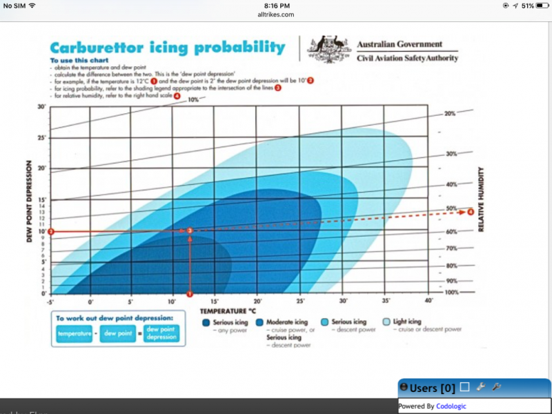

Teckair Posted March 6, 2016 Posted March 6, 2016 Damage to the propellor could indicate whether or not it was running - that is evidence. Not really a motor can run with reduced power due to carby ice.

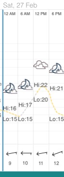

DrZoos Posted March 6, 2016 Posted March 6, 2016 Has anyone checked weather data for condioions that may be conducive to icing? seems a lower possibility with the conditions in NSW lately, but i havent checked data. According to the abc he took off at mdday 27th feb, which on face value wouldnt indicate icing.
dutchroll Posted March 6, 2016 Posted March 6, 2016 Damage to the propellor could indicate whether or not it was running - that is evidence. Not really a motor can run with reduced power due to carby ice. Both correct. You can certainly have a partial failure or power loss for a number of reasons, but also the damage to the propeller can indicate roughly how much power it was producing if any at all. 1
facthunter Posted March 6, 2016 Posted March 6, 2016 I'm not suggesting icing is related to this event. Merely that if icing caused a power loss after the ice has melted there is no evidence of it being there. If an engine is delivering power when the plane impacts the ground it will be reflected in the nature of the propeller damage. Therefore no need to dismantle the engine, if the propellor indicates it is still delivering power. If the Jabiru engine wasn't under a cloud would this have been mentioned at all? Nev 1
