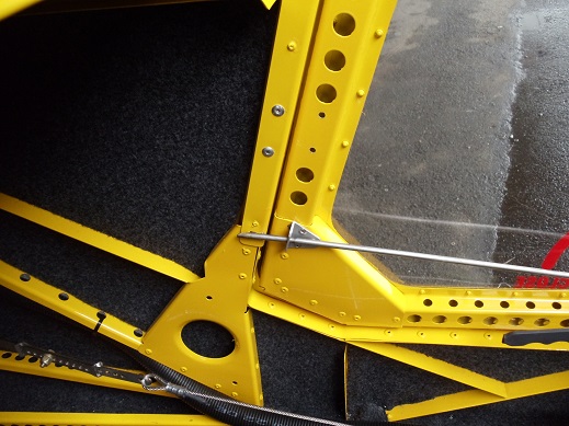

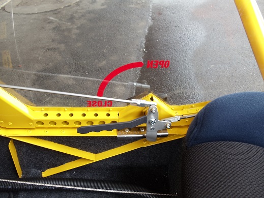

erd72 Posted November 16, 2015 Posted November 16, 2015 Hi, Like many savannah owner, i am not completly satisfied by the the door looking. Suction and opening (close to 1 cm) of the rear area of the door appear at 160 Km/h... So there is a air flow... Does somebody find a suitable solution for this ? Some of you use this device ? http://www.aerokits.net.au/prod02.htm Does it works well ? Is it suitable for Savannah S ? Thanks in advance !
Ultralights Posted November 16, 2015 Posted November 16, 2015 Pretty much every Savannah in Australia has that 3 point latch.. 1 1
rankamateur Posted November 16, 2015 Posted November 16, 2015 Haven't even hung my doors yet but the 3 point latches were installed before the painting, never thought of not using them. They do add a tiny little bit of weight but they do keep the doors shut reliably. 1
erd72 Posted November 16, 2015 Author Posted November 16, 2015 Thank you for your answer ! Does it suitable for S version ? Does somebody have a picture in situation ? Is it easy to install ? Is it come from Australia or could we find that in europe ? Thx
Skee Posted November 16, 2015 Posted November 16, 2015 I imported it from Australia to Sweden. Worked like a charm. Just Order it 1 1
rankamateur Posted November 16, 2015 Posted November 16, 2015 They are manufactured by the Australian ICP importer and he ships them all over Europe. 1
erd72 Posted November 16, 2015 Author Posted November 16, 2015 Thank you good to know, i will contact them !
rankamateur Posted November 16, 2015 Posted November 16, 2015 And there is also a picture here http://www.aerokits.net.au/prod02.htm 1
Kyle Communications Posted November 16, 2015 Posted November 16, 2015 I have it on my VG XL and it just works so well. Wouldnt have anything else
Skee Posted November 16, 2015 Posted November 16, 2015 [ATTACH=full]39403[/ATTACH] [ATTACH=full]39404[/ATTACH]And there is also a picture here http://www.aerokits.net.au/prod02.htm Anyone know where to get these open close stickers?
Kyle Communications Posted November 16, 2015 Posted November 16, 2015 Reg supplies them he gets them made
Kyle Communications Posted November 16, 2015 Posted November 16, 2015 Anyone with a vinyl sticker cutter can do it for you
