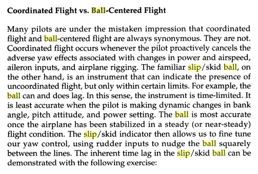

CASA's MOS has lots of specs on required flying tolerances but nought on balance that I can see apart from words like "balance and trim the aeroplane accurately". First of all the instrument has to be accurately mounted in the panel. Secondly, consideration of the behaviour of the ball in dynamic conditions - refer the text in the attached photo.
Worth repeating that first sentence: "Many pilots are under the mistaken impression that coordinated flight and ball-centered flight are always synonymous" with the result that, unless absolutely steady conditions, they fly down final in a state of perpetual uncoordination. The Pitts standard instrument package does not include a slip ball yet it can easily be flown accurately in balance - except normal landings when many of us prefer to sideslip just so that we can see the runway.
As for flying the approach in calm conditions or direct headwind vs a crosswind - the discussion is irrelevant as there is always a crosswind component, its just that sometimes it is NIL.

Secondly, consideration of the behaviour of the ball in dynamic conditions - refer the text in the attached photo.[ATTACH=full]39541[/ATTACH]
I had to google to find the context of that extract.
I hesitate to nitpick Rich Stowell, BUT he is describing an exercise rolling between 30 degrees bank each way while keeping the nose on a point on the horizon as coordinated flight.
I do not consider banking without turning - even temporarily - as truly coordinated. Rolling from 30 degrees one way to 30 degrees the other the nose SHOULD be moving across the horizon. As you roll through 15 degrees, the nose should be moving at the correct rate for a 15 degree banked turn etc. If you doubt it I am sure a glider or pusher aircraft with a yaw string would show it. I suspect the yaw string would show the ball to be surprisingly accurate.
The rate of turn for a particular bank angle increases with slower airspeeds, so the slower the aircraft, the more uncoordinated it will be if you hold the nose on a point as you roll into the turn. For a fast aircraft, it might be effectively undetectable.
