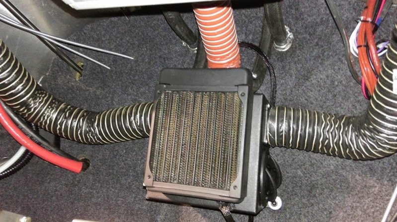

I have water system like this that I have not installed yet, got this foto from a Norwegian Savannah.

I have water system like this that I have not installed yet, got this foto from a Norwegian Savannah.T7design.co.uk
[ATTACH=full]38224[/ATTACH]
That is more like a car heater and is sure to be effective if you can get a good airflow through that little heat exchanger. A fan will be needed. the only negatives is that you are introducing hot water on your side of the firewall. You may want to check hose clamps every 50 or 100 hours of flight.
The fan is built in, can't see it on photo.
It is supposed to make 3,5kw of heat.
The fan is built in, can't see it on photo.It is supposed to make 3,5kw of heat.
That is a lot of heat for the two or three cubic metres of air in the cabin.

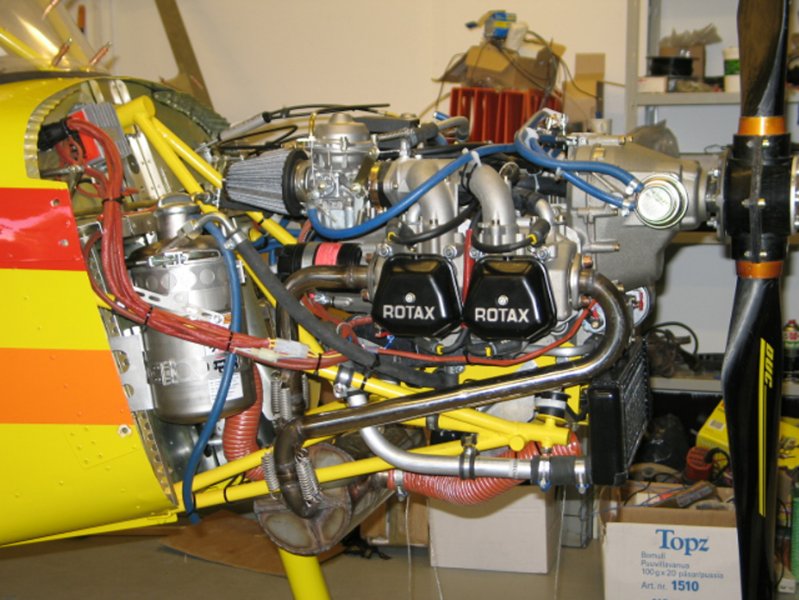

When I make my Savannah 912 (2003 - 2006) I install a selfmade funnel (15 cm x 15 cm) after water cooler and dia. 45 mm scat tube to muffler, stainless steel tube trough the muffler (it was ready installed by ICP) and 45 mm scat tube to cabin. After 15 min flight outside -15 C, inside +10C.

Hi Osteri,
I like the look of your system too. Do you remove the "funnel" for summer flying to keep sufficient airflow through the radiator (water cooler)?

Hi Bob
Not necesar remove, in winter must cover 1/4 - 1/2 part of cooler (not over the funnel).
Cooler preheat the air and funnel add pressure and air folw through the mufflertube. What in important, in cabin close air folw straight out for example with yoke cover. http://www.aerokits.net.au/Savannah%20Tip%20No%2024.pdf

Not plastic ducting, SCAT ducting temperature ranga to 550 °F ~ 288 °C, not problem connecting to muffler.

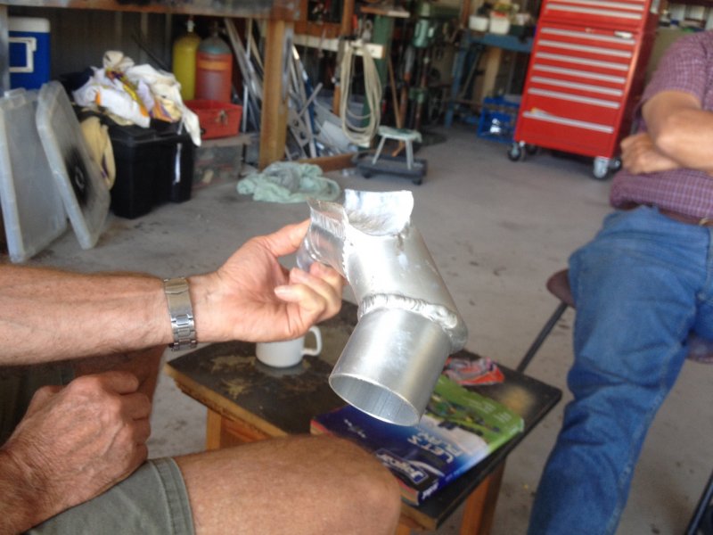

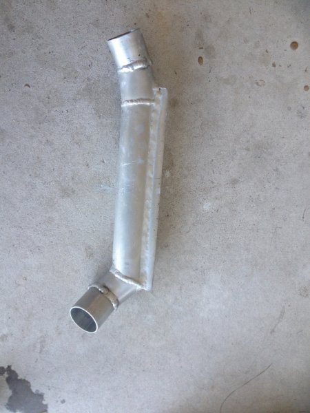

This is the one Roger has made. It just uses hose clamps to hold it against the exhaust pipe and there is silicone heat transfer compound in the semicircular section. then its just some scat tube to the front of the cowl and then into the standard Savannah input on the firewall. It is just welded up out of aluminium tube its very light
[ATTACH=full]38284[/ATTACH] [ATTACH=full]38285[/ATTACH] [ATTACH=full]38286[/ATTACH]
I like this in principle because carbon monoxide poisoning is almost non-existent due to the two layers between exhaust gasses and cabin gasses. But, I am still left wondering if there is enough heat transfer in 300-400 mm of pipe which only overlaps by half the circumference?
So my water system can transfer carbon monoxide 004_oh_yeah.gif.82b3078adb230b2d9519fd79c5873d7f.gif
Aluminium transfers heat very well and with the heat transfer compound in there it essentially makes the heater tube almost the same temp as the exhaust pipe so there would be a fair amount of heat coming in that pipe. Remember on the Sav there is no air duct to the front of the cowl either so not much airflow there. This one needs a airduct from the front getting some clear air then I think it would work really well
