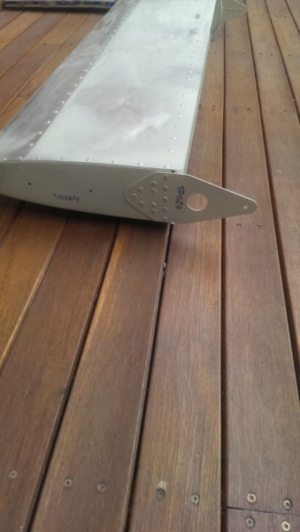

Lyndon Posted September 24, 2015 Posted September 24, 2015 The booked has not fitting the last end plate crossed out. So I fitted it. I take it there is no need to fit it when it's all hooked up to the elevator.
Skee Posted September 24, 2015 Posted September 24, 2015 I just attached one so i could paint the stab and elevator seperatly, when painting was done i attached the plate and elevator.
eightyknots Posted September 24, 2015 Posted September 24, 2015 The booked has not fitting the last end plate crossed out. So I fitted it. I take it there is no need to fit it when it's all hooked up to the elevator. Hi Lyndon, I take it you are building a Savannah? What have you constructed so far?
