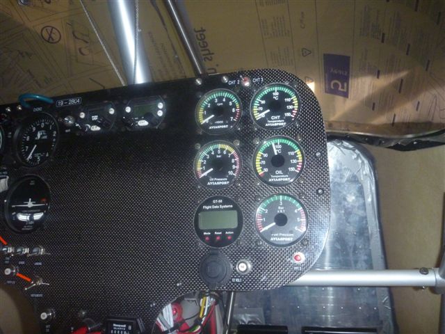

Blueadventures Posted July 20, 2015 Posted July 20, 2015 I put power on to my new build today and the 'AVIA' brand oil temp gauge is reading about 97 deg C. I have not run the engine yet and it's a new gauge. Every thing else looks ok. Any informtion about if this will be ok when I start the engine? Battery disconnected and gauge still showing 97 deg. Thanks Mike
Jabiru Phil Posted July 20, 2015 Posted July 20, 2015 Disconnect gauge, if still reading the same, probably a faulty gauge. PHIL.

Doug Evans Posted August 28, 2015 Posted August 28, 2015 Sound like it maybe faulty mate dose it cycle up when powered up ?
Blueadventures Posted August 28, 2015 Author Posted August 28, 2015 Sound like it maybe faulty mate dose it cycle up when powered up ? Hi Doug Was a faulty gauge. Replaced without any hassles by Rotax Gary at Bert Floods and the Avia man Roberto. Excellant service and all good now. Started last Sunday arvo, goes nice. Moving to hangar this Sunday all going well. Just need the trailer. A worst I'll get it out there early next Saturday. I'll let you know so you can plan a visit. Cheers Mike
