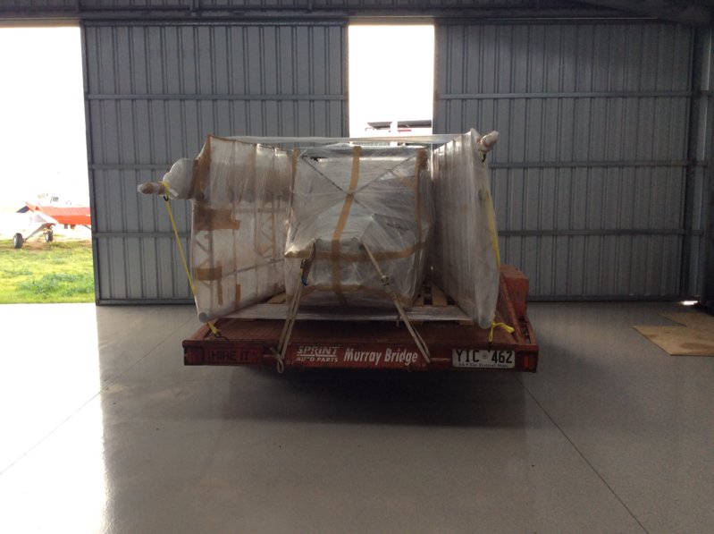

The kit has arrived, all unpacked and assembly has started. Cant believe how many parts there are, I'm sure KFA have sent me too much stuff. Looking at the parts inventory every
part, nut ,bolt and washer is part number tagged which corresponds to the assembly manual drawings very professional. I'm impressed even I cant get things mixed up. They have
done a excellent job.

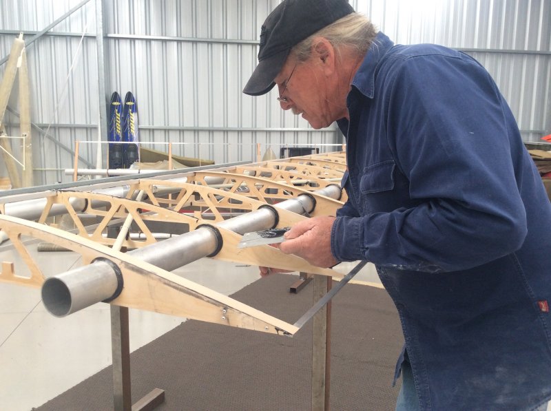

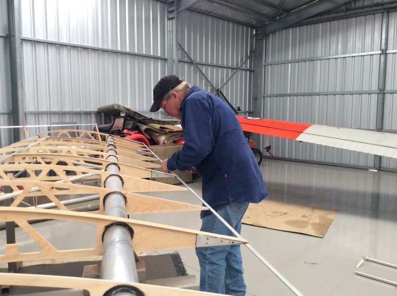

Been awhile since posting, near 3 weeks in the NT and now I'm off to QLD for a stint working, gotta pay the bills I guess. With all that time away I have still completed my 17th day on the Explorer. Working an average 5-6 hours per day it's coming along nicely. Today I removed the wings after dry fitting them, set one on a trestle and started sanding and epoxying the cap strips. Contemplating extra fuel tanks so now is the time to study and work out if more fuel is worth it. I'll also loose time sourcing resins and making temporary moulds but thems the breaks. Does anyone know composites available here in OZ that are suitable for mogas particularly ethanol? maybe I should start another thread on the resins.

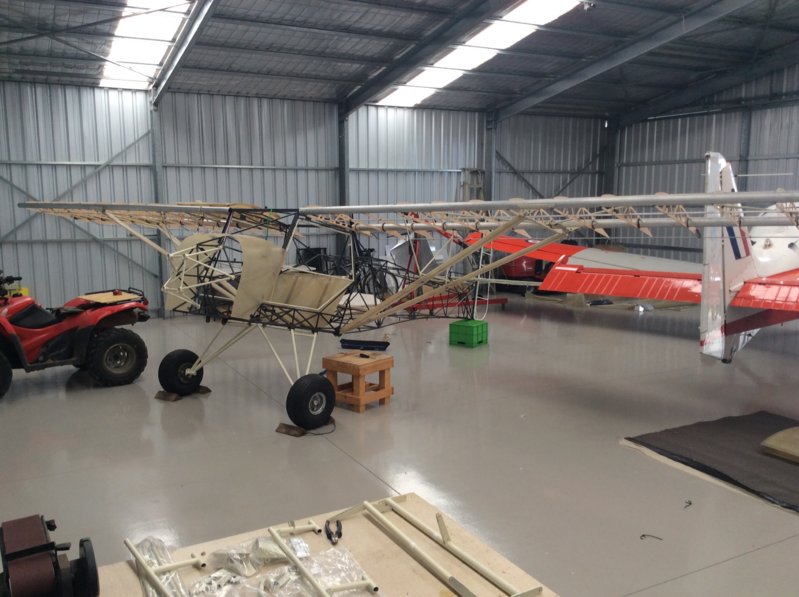

Nearly 6 weeks away working is doing nothing for my build. Just as well I didn't bet a carton on having it finished by Christmas. Anyway today is day 18 on the Explorer.
more pictures to come.

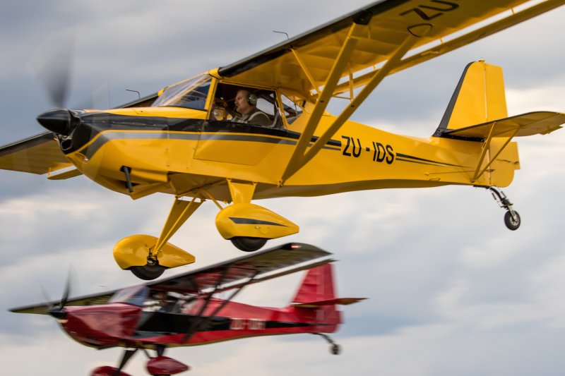

Hi Steve, keep at it. Your baby will soon look like this one

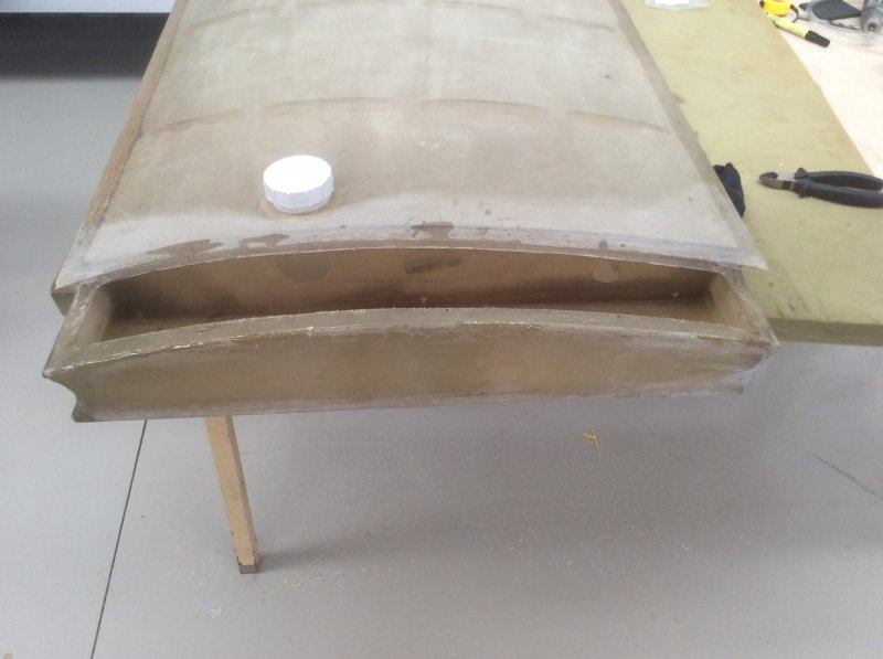

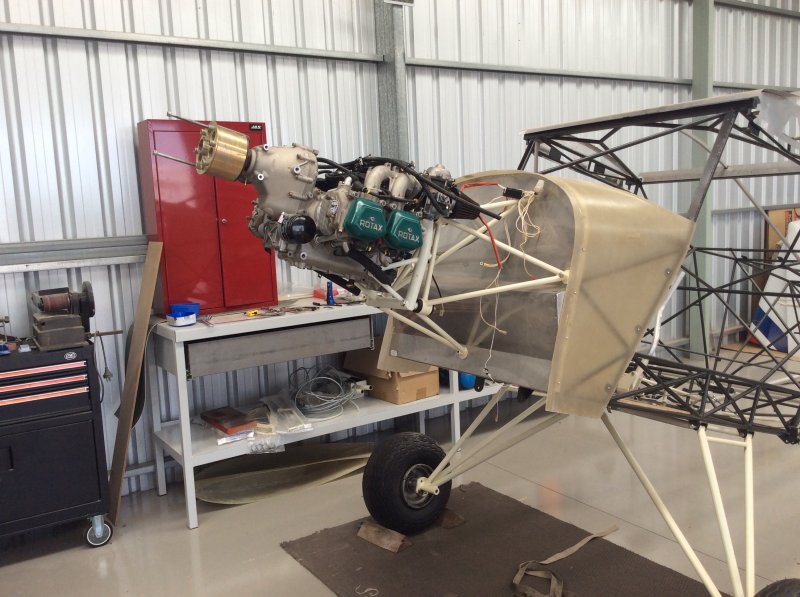

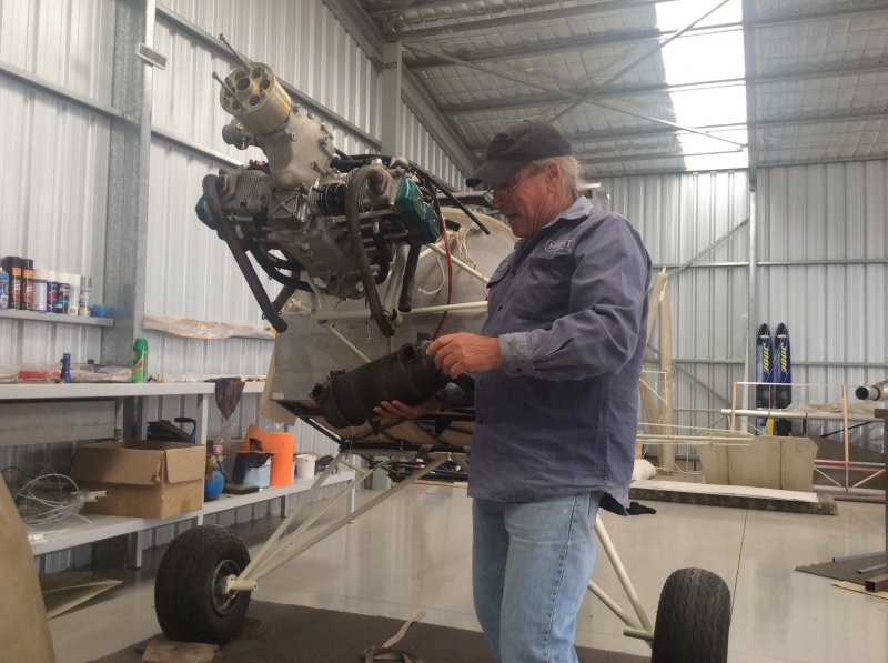

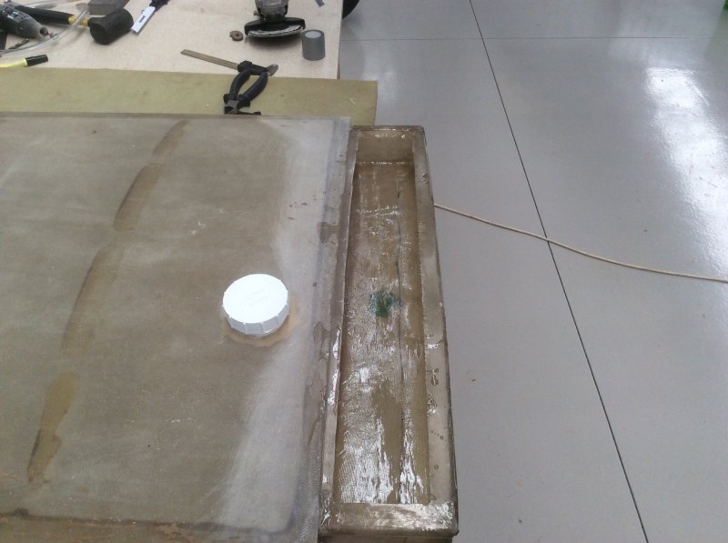

I'm back !!!! Hopefully for a couple of weeks this time. Day 20 and the tank extensions are nearly complete,
Dry fitted the Rotax today, sat in the Explorer and made plane noises for awhile. The nose is heaps high I'll
have to carry a milk crate to stand on to check the oil. ( and I'm six ft tall haha )

Thanks for the update and looking good Steve. No worries with prop clearance in the paddocks eh.
Not big enough haha! They r Carslisle turf guide 8.00 - 6 . . . 18" tall with 4 psi in them

Show us a pic of those tank extensions you are making..And what colour scheme are you thinking off?
I'll take some tank pics tomorrow, colour red over white similar to ZU FDP. love the radial 096_tongue_in_cheek.gif.d94cd15a1277d7bcd941bb5f4b93139c.gif

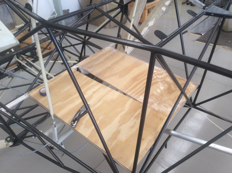

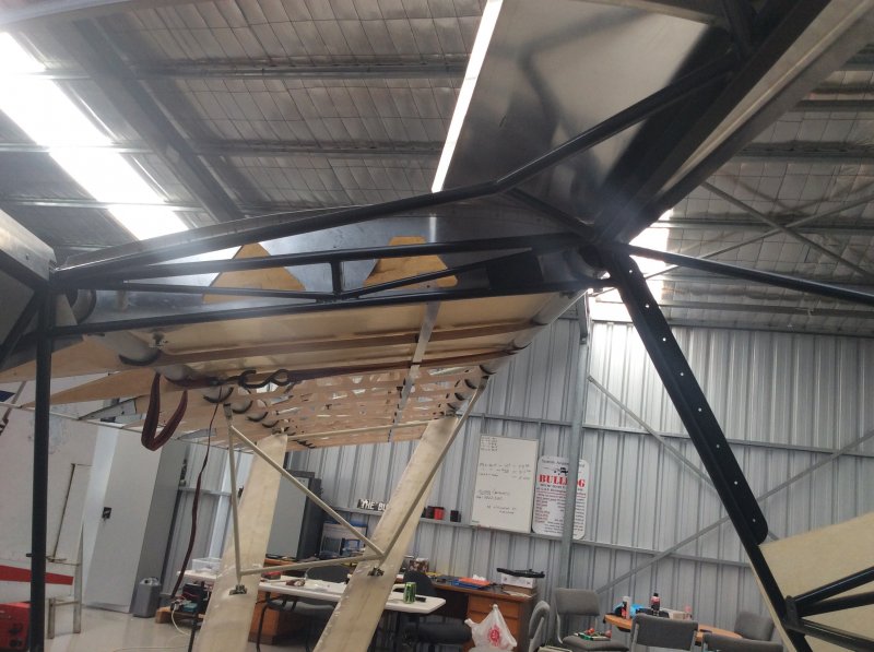

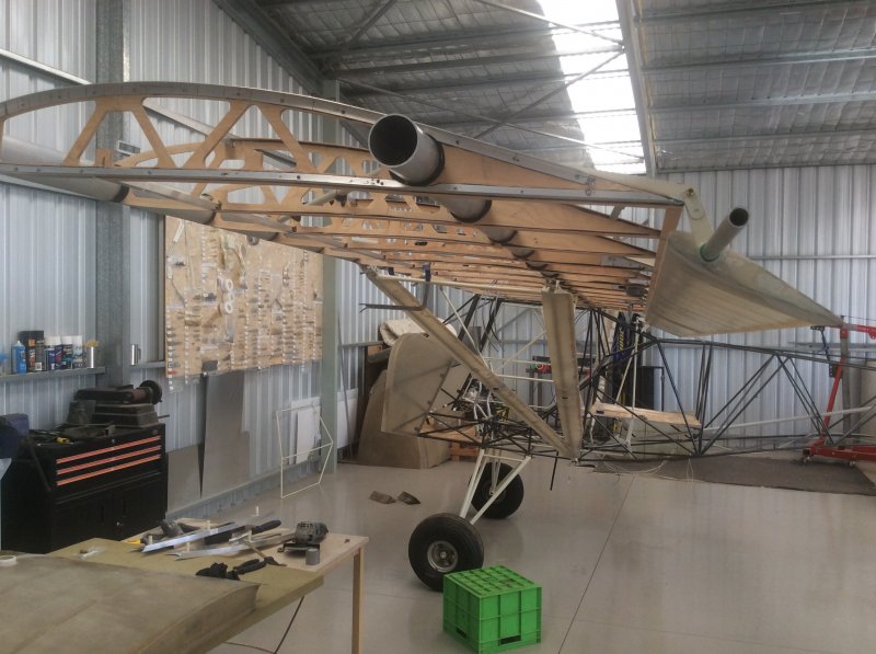

Has been awhile since posting. Tank extension pics below, still need to fit top covers and slosh them. Have dry fitted the wings for the last time to check the final pitot and fuel line routing and making sure the tank extensions work. Presently setting up the flapperon linkage, then wings are ready for covering.
Here's some more pictures. The baggage area is huge, was thinking how the hell am I going to fill that till my wife came by today with some lunch, " that will hold about 40 pairs of shoes " she said 037_yikes.gif.f44636559f7f2c4c52637b7ff2322907.gif. . . Bring on the brownie points haha!
