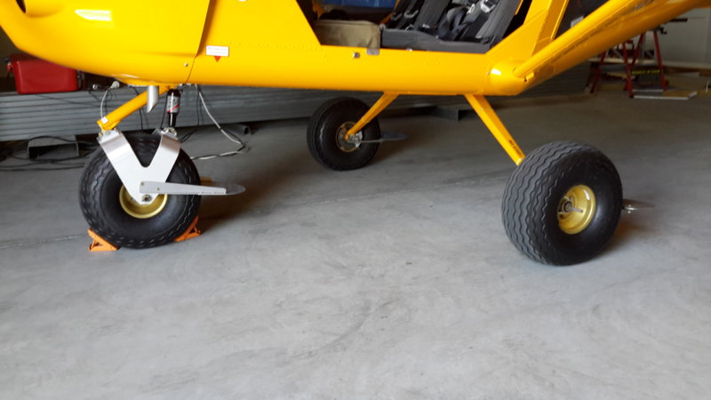

You were asking about the tundra tyres. Here's a pic. Don't get the impression they're massive, but I recon perfect for the aircraft size.

Foxbat Tundra Tyres....... Hows the steering on the CJ6? Nev
Fine, once you get used to it. The brakes operate from a handbrake mounted on the control stick much like the y-yoke Foxbats, but the rudder pedals play into the operation. Squeeze the handle, the plane stops; press a rudder pedal and squeeze the handle and the plane turns in that direction because only that brake will engage. The brakes are pneumatically operated so I can go across a ramp using my breaks with a lot of "whishing" noises. It usually grabs spectators' attention - both the plane and the swishing. Cessna drivers probably will run over a few things (hangars, automobiles, pedestrians, etc) until they get used to the handbrake operation. There are no toe-brakes. The CJ is heavy and tends to build speed during taxi (throttle creep), so it is best to keep one hand on the throttle and the other on the brake lever. Taxi speed control and situational awareness is important even when taxiing. Easy plane to fly though; just do not expect to approach the field at 40kts. I use 90kts in the pattern and land a mite faster than Foxbat pilots prefer.

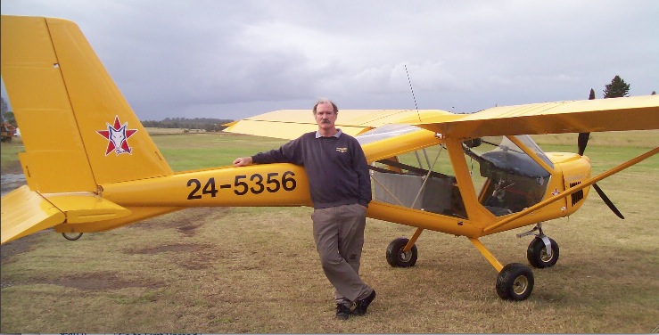

I've named this photo 'Foxbat_B', as this is an A22L, but the later model with smaller fin.

Nice photo. It that's the smaller fin, the big ones must look huge. I guess the tapered, narrow fuselage makes the vertical stabilizer look larger than it is.
No, it is big....double the size of a few aircraft around.....As the stall is so low, it's really good to be able to maintain decent control at these low speeds.
Same with the elevator.
With a lightish pilot and minimal fuel, the stall can drop well down into the twenties (knots).

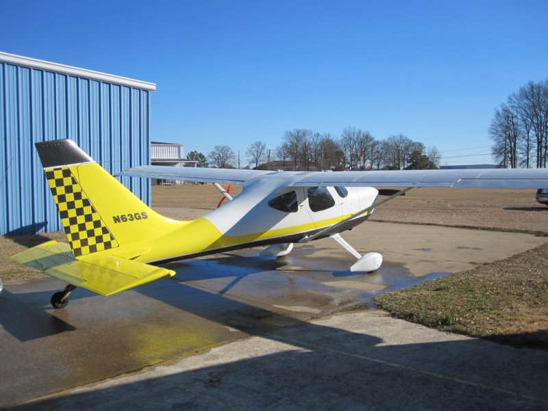

The GlaStar, an experimental homebuilt, also has a large vertical stabilizer and rudder. Makes it a rather stable aircraft and quite responsive if one has a spade on the aileron - only need one, not two. Neverthess, re stab size, everyone was always commenting on how big mine was. 059_whistling.gif.a3aa33bf4e30705b1ad8038eaab5a8f6.gif

As for the big/small fin variants, the rudder is the same size on both, so it becomes a percentage area thing where the big fin has less rudder authority than the small fin.
While I haven't spoken to Yuri, I assume the smaller fin was to get a better side slip capability, but it could also have been to get more rudder authority in crosswinds, less weather-cocking on the ground, or maybe just to save metal!
Believe it or not, the British authorities, when approving the early model as a kit, felt that the aircraft was over sensitive in rudder, and mandated that they be fitted with an anti-servo tab on the rudder!!
This caused at least one crash that I know of, and created a fatigue problem in a few others....?
Best to leave them as Yuri designed them. 014_spot_on.gif.1f3bdf64e5eb969e67a583c9d350cd1f.gif
