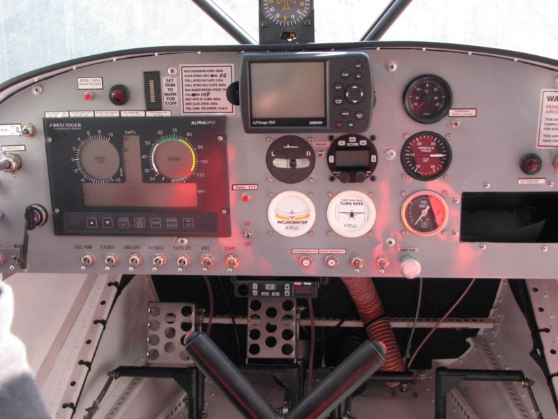

Kyle Communications Posted January 17, 2015 Posted January 17, 2015 Coop this is the dash I started with. I didn't use any of the instruments supplied in the kit except the fuel pressure gauge...it changed after some use to have the MGL Xtreme added. I liked it so much that is why I decided to add another one . reason was redundancy as both are EFIS so they can both do EMS as well This is how I have been flying it now for about 2 years and I will get some pics up of the new one..minus the second EFIS as it is in my aircraft of course 1

Kyle Communications Posted January 17, 2015 Posted January 17, 2015 I have a ASI it is digital but driven from the pitot and static as any normal system..the MGL has it in it the same as most other EFIS and also the Brauniger has one as well. The new dash has 2 of the MGL so I have 2 digital ones and as a last resort backup the new dash has a analogue ASI.....I would never suggest not having a ASI on board...that would be highly stupid. If you look on the left side of the MGL that is the airspeed in both digital and tape format.. the right side has height in digital and also vertical speed in digital at the bottom and a tape at the side...the Brauniger has both....I think I am covered
Captaincoop Posted January 18, 2015 Author Posted January 18, 2015 nice set up. I do find the PFD display easier then scanning multple dials.
