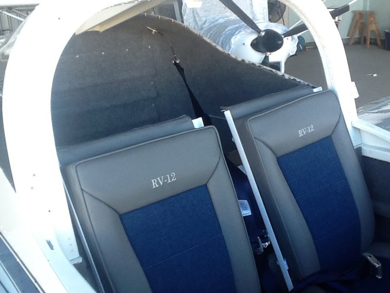

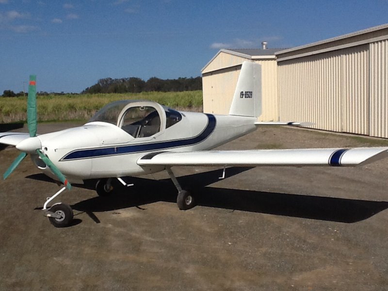

raizo Posted December 27, 2014 Posted December 27, 2014 Hi all,RPV12 19-8509is now up and flying,building commenced in March and she flew 5th November,now how 19hr on her and the only problem was a heavy right wing, we followed Vans instructions and flatted the trailing edge of the light wing and she flys perfect .Made a few mods. Fitted an alternative fuel tank which sits behind the two seats and above the wing spars, holds 85 liters,we got the plans from a few RV12 builders in the USA who have built this tank,much better than the original vans tank!also I did my own dash panel as I am not a fan of glass panels,also fitted a 3blade Bolly 4 3

Neil_S Posted December 27, 2014 Posted December 27, 2014 Hi all,RPV12 19-8509is now up and flying,building commenced in March and she flew 5th November,now how 19hr on her and the only problem was a heavy right wing, we followed Vans instructions and flatted the trailing edge of the light wing and she flys perfect .Made a few mods. Fitted an alternative fuel tank which sits behind the two seats and above the wing spars, holds 85 liters,we got the plans from a few RV12 builders in the USA who have built this tank,much better than the original vans tank!also I did my own dash panel as I am not a fan of glass panels,also fitted a 3blade Bolly [ATTACH]33330[/ATTACH][ATTACH]33331[/ATTACH][ATTACH]33332[/ATTACH] Hi Raizo, Good stuff! It looks very clean - and nice dash too! I am sure you will enjoy every moment flying her. Cheers, Neil
rgmwa Posted December 27, 2014 Posted December 27, 2014 Congratulations Raizo. Looks great. Was it Joe Gore's tank design that you used? rgmwa

raizo Posted December 28, 2014 Author Posted December 28, 2014 Hi all, yes I did use Joe Gores fuel tank design,I was able to get all the info I needed of his web site and my son made it for me,we made it slightly wider to get 85 liters Sorry guys my mistake calling it a dash panel and not an instrument panel Raizo
