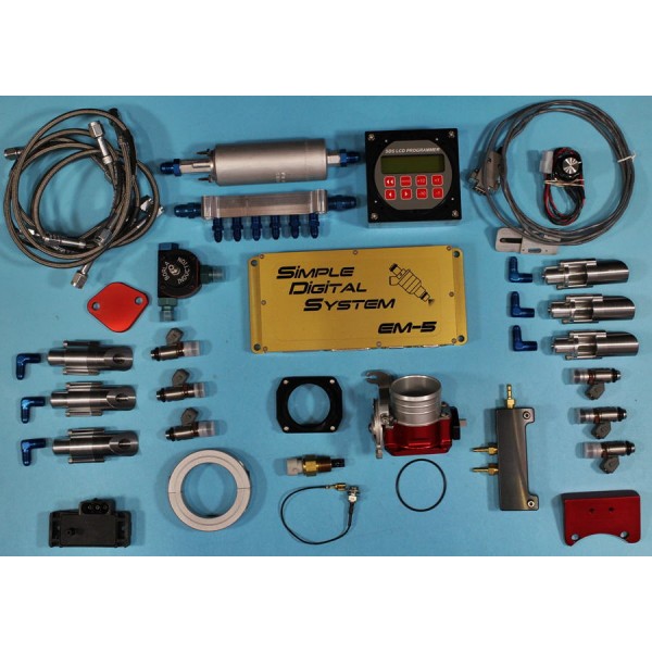

jetjr Posted November 16, 2014 Posted November 16, 2014 Yep SDS from Canada have a system. Kit from Edge performance in Norway?? http://www.avcom.co.za/phpBB3/viewtopic.php?f=59&t=137074&sid=926ae517c4ee47eae67830b78334a561 A good read here, finally has it going, numbers look really good He has also done a full EFIS,EMS and electrical rework so bit more complex than just EFI update Some guys in South Aus do sell and install more basic kit using same gear 1

Downunder Posted November 16, 2014 Posted November 16, 2014 http://webshop.edgeperformance.no/index.php?id_product=74&controller=product 1
jetjr Posted November 17, 2014 Posted November 17, 2014 The kit pictured is the whole deal, inc requiring dual pumps, new TBody and probably backup battery setup It can be done using Bong carb and single fuel pump Cheaper and inc full mechanical backup

jetjr Posted November 17, 2014 Posted November 17, 2014 yep, few stories aero injector not working that well, Rotec make one which would be nice throttle body but they are really just different carb's, Better no doubt. Lots of changes needed to cables etc too. Issues with uneven distribution still exist with TBI like these, port injection is the way to fix issue 1
