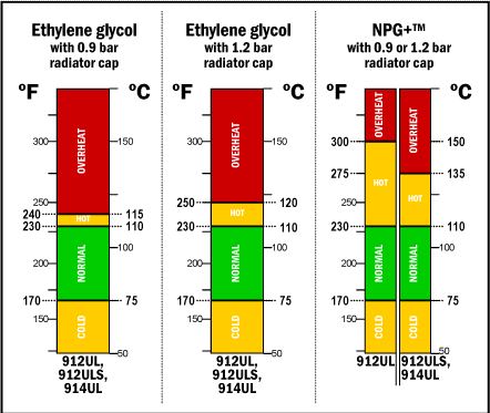

http://legacy.rotaxowner.com/si_tb_info/serviceb/sb-912-066ul-r1.pdfSo for anyone with a factory built aircraft by the look of it you must put 4 new cylinder heads on your engine. I see it is mandatory so I suppose it is for all engines or really is it just certified engines?
That doesn't tell you much, just refers you to sb-912-066 but from my reading sb-912-066 says if you have the new style cylinder heads, you need to change the instrument labels and temperature limits to match.
I think they just want the serial/data plate changed to easily identify if these new heads are on the engine.
The Cylinder Head Temperature probe is now effectively the Coolant temp probe.
The service note says that if you fit the new type heads you have to change the green yellow and red temp ranges on the cht guage because on the new heads the sensor is now mounted in the water jacket
