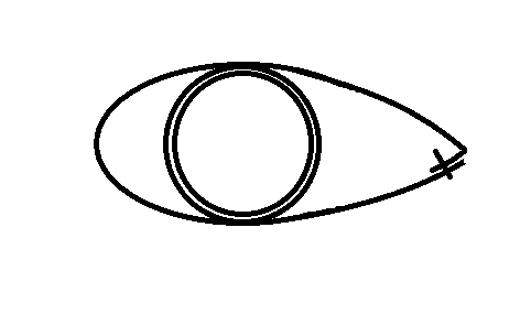

Nev, I've been considering streamlining the 701 struts (when I make them). Plan calls for round chrome moly which I've already bought, and I generally try to stick to the plan, but I also know there's a hell of a lot less drag if streamlined.
If I do fold a sleeve and rivet at the TE, what's the best method to fix to the tube? Does it only require a couple of rivets top and bottom, or should there be a full length row - if so, does that weaken the strut at all?
Rivets do weaken the tube, the best solution is to only rivet the fairing at the ends of the strut and use a high strength double sided tape where the fairing touches the strut tube top and bottom.
Having a rivet line at the Trailing edge is not much of a reduction in the section and the number doesn't affect the principle as it does in a stressed lap joint where the total number is significant in reducing cross sectional area. If you have a chrome molly tube why not use something like balsa or foam with a coating held on by straps. It's not load carrying, just streamlining. Nev
I thought of lapping the fairing at the TE so the body of the rivets are inside the fairing - like this:
Surely that would be a substantial drag reduction?
It will be a substantial drag reduction with a section like that. More so if the rest of the plane has a bit of a clean up, and you are cruising above say 60 knots. Don't put rivets into your main structural tube as it will weaken it and create failure points. Nev
I agree. A round section is terrible for drag. I have been told that a 1/4 inch diameter rod has the same drag as a Libelle wing.
If you make the section too blunt, the airflow will separate before the trailing edge. I used to see this on my early SK Jab with the round trailing-edge struts. You could see the separation point when a little light rain left a line of dust, and those struts left a separation wake of about 15mm.
