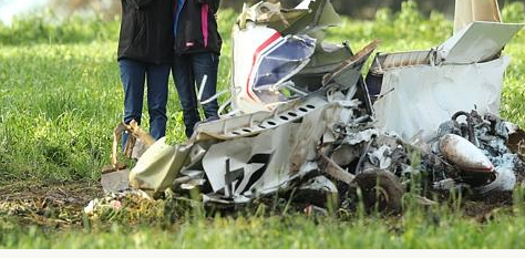

aj_richo Posted June 27, 2014 Posted June 27, 2014 Here is a better shot of the wing with the tail out of the way, doesn't look like it was carved off by a wire strike but I have no accident investigative skills..
Teckair Posted June 27, 2014 Posted June 27, 2014 Here is a better shot of the wing with the tail out of the way, doesn't look like it was carved off by a wire strikebut I have no accident investigative skills..[ATTACH=full]31010[/ATTACH] You can't tell from these photos.
Old Koreelah Posted June 27, 2014 Posted June 27, 2014 with half a wing (or 2/3 in this case) it will fly for 1km with a lot of rudder input...in fact several usaaf and raaf pilots rammed japs in P-40's off horn island and returned with half a wing, 200 miles out Amazing! The aircraft in the first pic is benefitting from a bit of extra leading edge... Maybe that confirms the old saying that the back of the wing is only streamlining for the spar...

acro Posted June 27, 2014 Posted June 27, 2014 Good to see such a strong response for NAIPS, and I agree it's not always user friendlyIf the NAIPS report was for moderate to severe turbulence then the question might be whether it was referenced, because the outcome of that report would pretty much produce the result. AJ it does look like a structural break rather than a wire strike I agree. Wings can develop a wave action under severe two way stress and can even break into several pieces. In turbulence it may have been possible to get some control over the aircraft for a short time before the inevitable final loss of control occurred. The other concerning factor with this flight is that it has been suggested it was commercial. naips always says mod/severe turb under 5000ft i didnt think it changed are you saying flutter was the cause? i believe if it was flutter the wing would be snapped at the root and bent backwards 1

acro Posted June 27, 2014 Posted June 27, 2014 I don't think the velocity would be enough in level flight. i have never seen flutter take a partial wing, it normally takes a whole wing or both or the tail. also the missing flaps are odd, if he has exceeded VFE you would think both wings would completely fail.
acro Posted June 27, 2014 Posted June 27, 2014 "Wing structure features a single spar torque box connected to fuselage via three pin attachments to each half wing" i guess it could quite possibly shear the outer wing then...hmm
acro Posted June 27, 2014 Posted June 27, 2014 what is that hanging off the vertical stab? headset? saw that in other pics, not nice 1
Guest ozzie Posted June 27, 2014 Posted June 27, 2014 ok look closer and i can make out the jack plugs. thought it may have been a guy wire or similar
pylon500 Posted June 27, 2014 Posted June 27, 2014 Many interesting (and odd?) comments here... I think we should all agree that part of the LEFT (PORT) wing is missing. The flaps appear to be missing. People are talking about 'struts'? The reports are calling the aircraft a Technam P-96, the rego on the RAAs site calls it a P-96... A Technam P-96 is a non strutted, LOW wing aircraft; Without knowing the distance the tip was found from the main wreckage, it is only speculation that there was a wirestrike. The weather reports tend to aim the cause more in the, loss of control / overspeed / flutter direction, as does the clean break of the outer panel. A sad and concerning thought. Those operating P-96's (and other Technams) might just have a closer look at aileron hinges, mass balance attachments, flap hinges, flap 'up' stops and general control system tightness at their next Daily Inspection, as I'm sure they do.... 3
