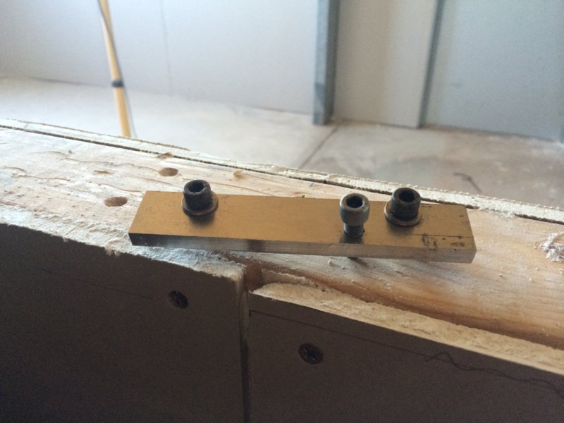

image.jpg.4098aae2f3409af53f70ce91dcd4ab8f.jpg I've had to bleed a couple of lifters to get them pumped .
you can make a tool that is just apiece of ally with holes that line up with the rocker cover screws . and a thread that you can screw down in the rocker ,
wind down til it goes hard ( expelled air ) & leave it done up for a few mins .
some times i had to do it twice .
now I've got hard & hydrolic .
cheers mike
