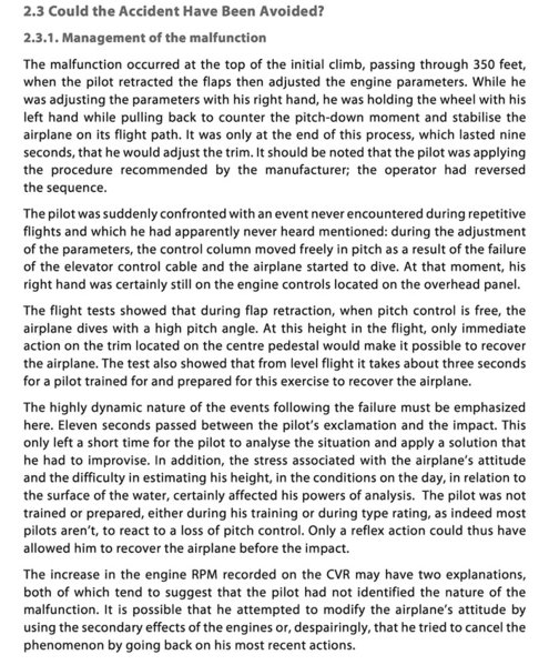

It's a great read but it's an almost 30Mb download so here's a screen shot of the bit related to your question.

Garfly, Thanks. The control should not snap to any limit, and if mass balanced should not flutter in any aircraft designed properly. Loss of pitch control is the most serious of all. Perhaps the use of beta range might have helped in the Otter but would have been tricky. Staying in trim at all times might be a good idea. I have had elevator failure in a largish plane and due to the trim system it was a total non event. I would not own a plane that doesn't have a duplicated control capability in the pitch mode, though I have flown many that don't I check things well before flight. Some trim systems are only a spring and if the main system malfunctions , the trim does too. Nev
Nev, there's one thing that caught my eye in that accident report that you might shed some more light on :
"2.3.1. Management of the malfunction
The malfunction occurred at the top of the initial climb, passing through 350 feet, when the pilot retracted the flaps then adjusted the engine parameters. While he was adjusting the parameters with his right hand, he was holding the wheel with his left hand while pulling back to counter the pitch-down moment and stabilise the airplane on its flight path. It was only at the end of this process, which lasted nine seconds, that he would adjust the trim. It should be noted that the pilot was applying the procedure recommended by the manufacturer; the operator had reversed the sequence."
What it seems to be saying is that this pilot's technique - the one recommended by the maker - was to forcefully hold the stick back against pitch change - due flaps up - whilst busy adjusting power for the climb. I think they're saying that this typically took fully nine seconds. (The report's precision seems to have lost something in translation.) Now, presumably, the other method - the one in the ops manual? - was to take some load off the elevator with trim before attending further to the thrust. Is that what they mean? As it happens, I suppose, had the pilot done it that way on the day, the flight may well have ended normally 8 minutes later. (Albeit, just postponing the inevitable.)
Anyway, are these alternative methods a point of debate in the industry? What's the thinking behind them?
I was also wondering if the preferred method in the DHC-6 might relate to the positioning of the controls. I believe the trim wheel is right down by the right side of the captain's seat while the thrust levers are way up in the ceiling.
But, in any case, Nev, I'm sure there'd be a lot of us here more than keen to hear the yarn about your own elevator failure in an airliner. You say it was a non-event … but how did you manage the approach and landing? They must have had the equipment standing by for you, at least, no?
P.S: While we're on about the old Twotter … herewith, shots of one in and out of St. Barth (where, famously, the final approach slope and the slope on final approach are pretty much the same thing ;-)
