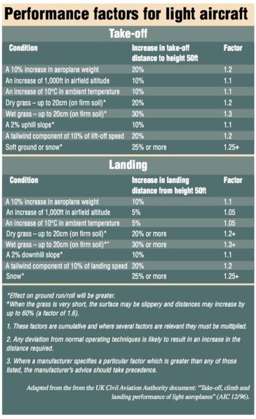

Phil Perry Posted January 1, 2014 Posted January 1, 2014 Hi Jet. . . . As you are aware there are quite a few people on this forum who have some very sound advice with regard to your proposed airstrip. I have many hours on the ubiquitous and wonderfully pleasant Cessna 172, ( mainly in and around Australia, in hot, low air density conditions. . .)and I have to say that, if you only have 450 metres of strip at an elevation of 3200 feet or so, then please consider the use of another aeroplane type, unless you are quite a small framed, lightweight person,. . .and you only ever want to fly solo, . . .or you only intend to fly on very cold, winter days when there's a strong cool wind blowing straight down your strip. . . ( ! ). Happy New Year Phil 1 1

djpacro Posted January 1, 2014 Posted January 1, 2014 A few years back I was re insuring the Lightwing with a reputable company. On receiving the policy I question the use of 'standard aviation wording and coverage.' .... which would include compliance with relevant regs. CAO 20.7.4 is worth a read here. eg definition of landing distance available cf the para on landing distance required and the consideration of grass plus landing distance factor. Note landing distance measured from 50 ft above the ground. Similar for take-off (for the airplanes that I fly, landing distance is more critical).
