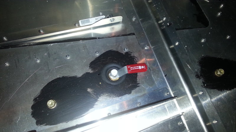

So i scraped the standard fuel valve, looked so stupid and with a mat it was no good, very hard to twist,

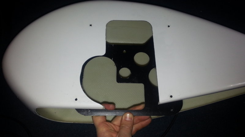

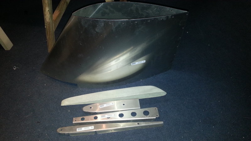

Plates for fairings if you wonder.

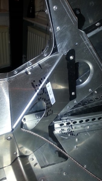

Rudder rods.

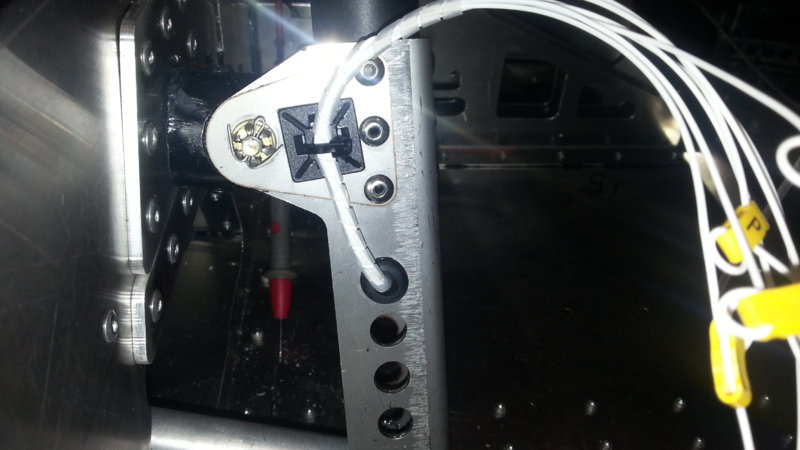

And cables for BMS.

what are the plates on the nose wheel fork at the side and the large plate behind the main undercarriage brakes
Its for the wheel pants=) (fairings)
BMS cable got sleeved =)

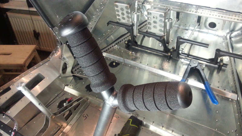

Ray allen handles are there but wires are not yet.

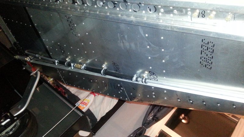

Fuel line is there to, really like the new fuel valve.

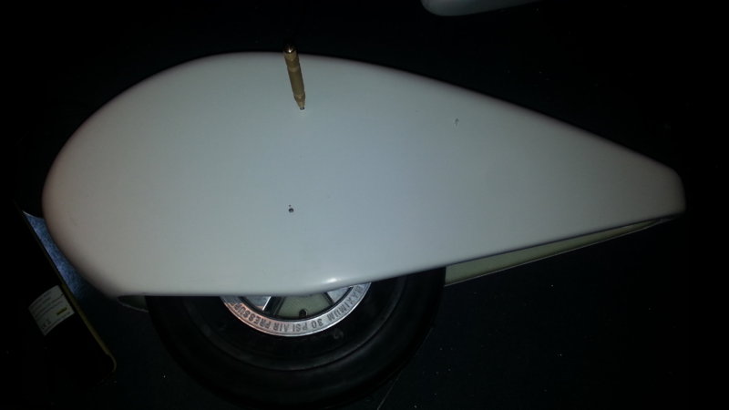

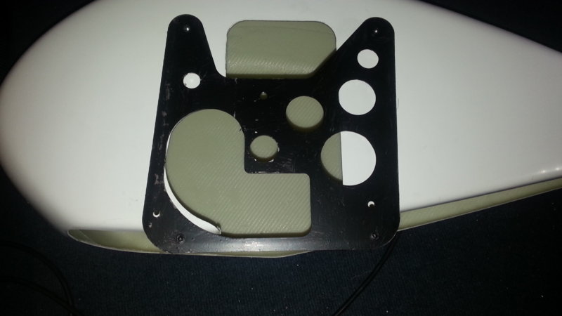

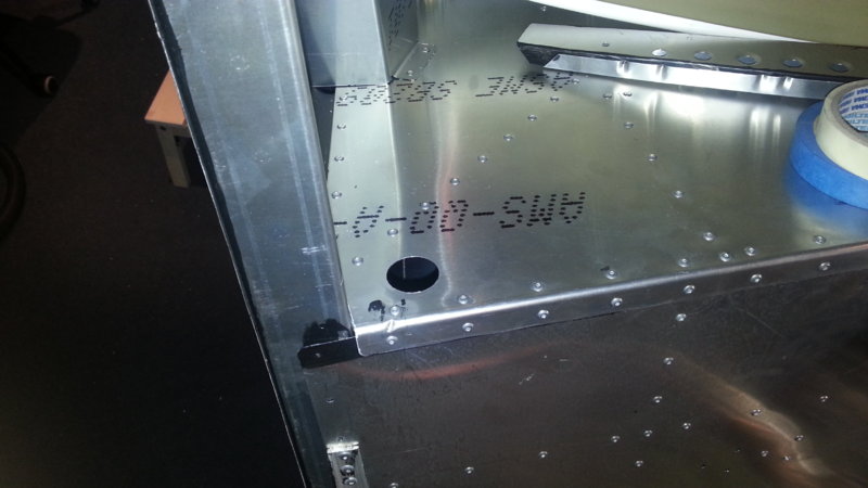

Farings fitment? how do they fit? i dont know, plate stick underneath faring, if it supposed to be like that then i have to grind on the plastic to get it right on. WHY!!

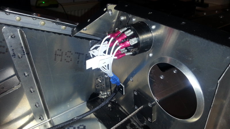

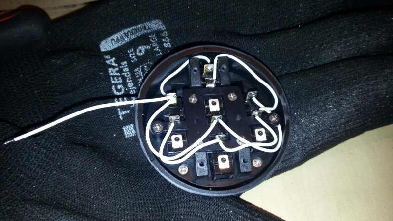

So i fixed the Ray allen handles, it was a long time since i did some soldering.

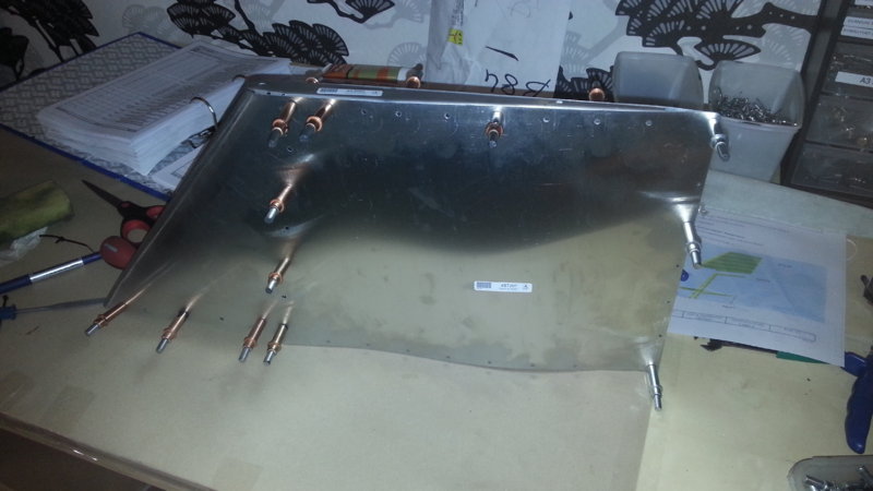

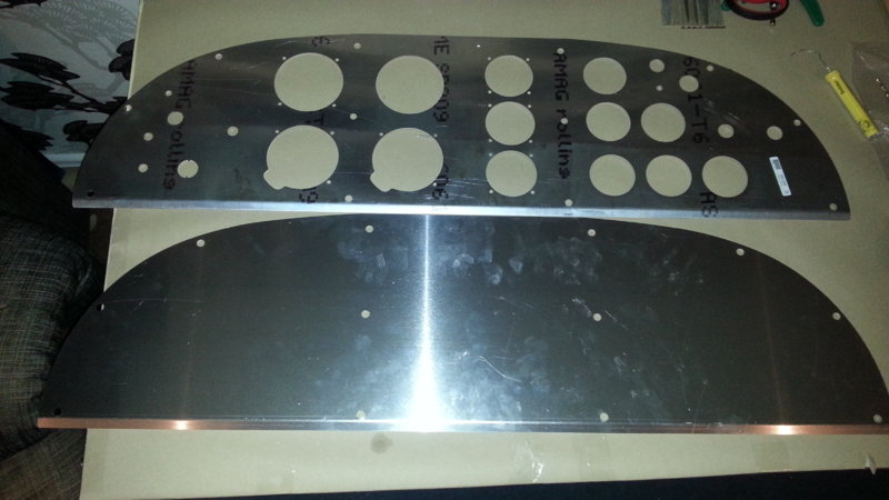

Ohh and icp succesfully sent a new panel, and they had bent the bottom the wrong way, putting it the otherway around so the screw holes match with cabin makes it angle outwards, already got a new one coming again.

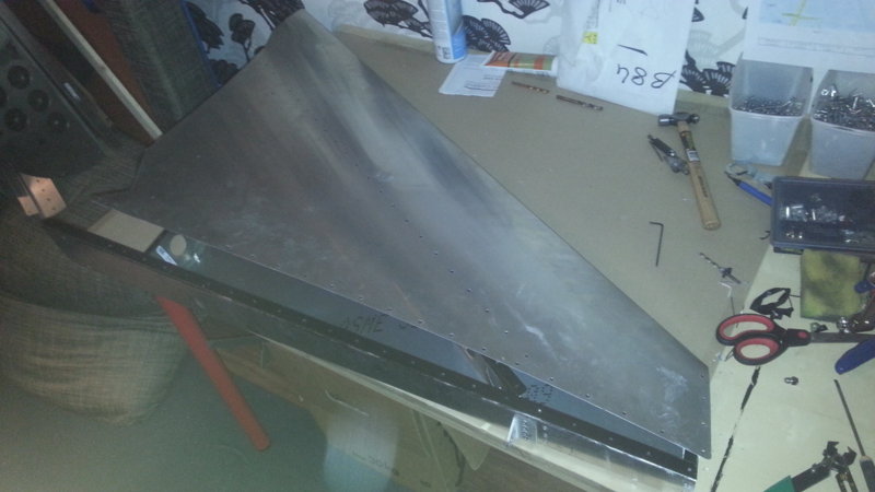

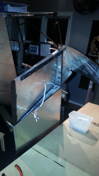

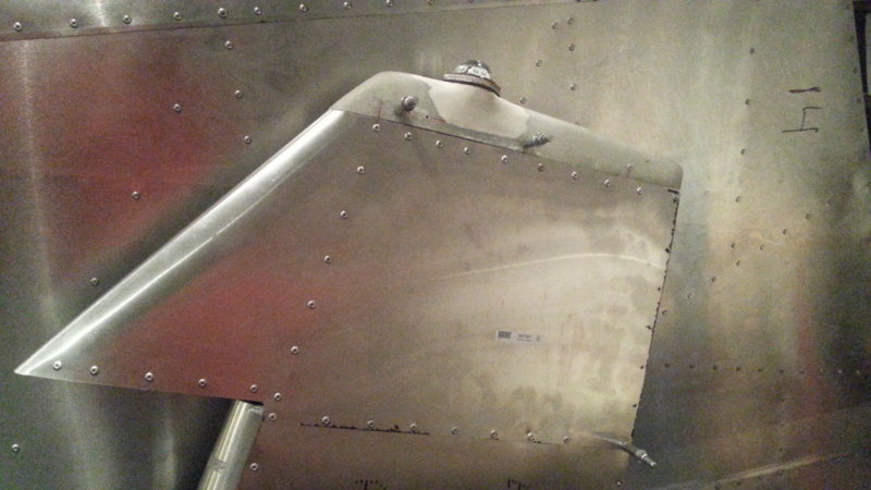

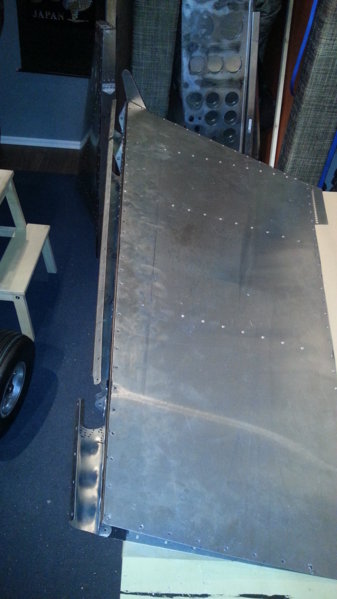

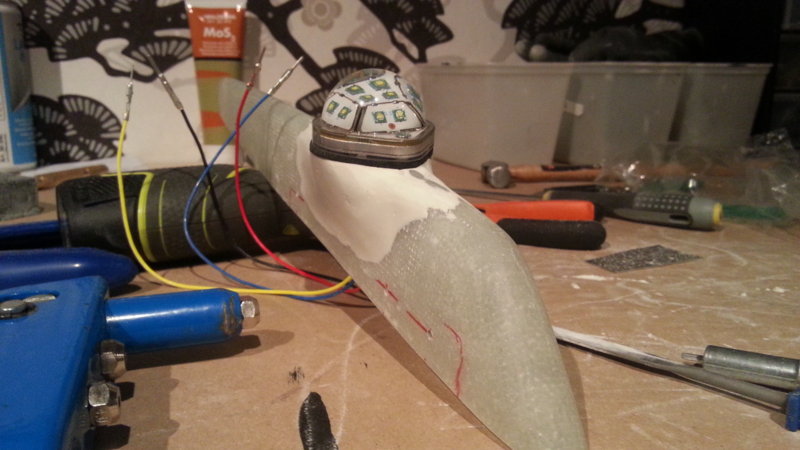

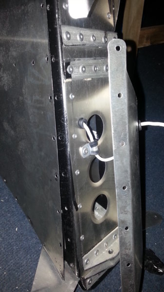

I fixed the extended rudder part.
I had to open side of the fin and remove the old strobe wire and then move it to the rudder by opening 1/3 of it and using grommets to pull it up to the new position.
New plastic tip mold and voila 010_chuffed.gif.c2575b31dcd1e7cce10574d86ccb2d9d.gif DAMN it looks good!!
