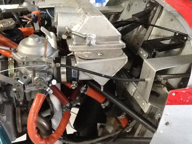

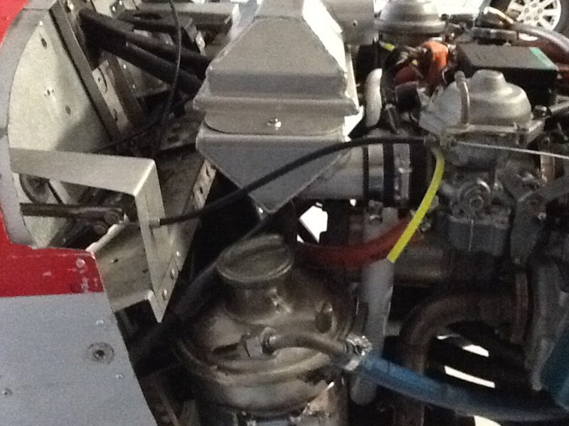

NOTE ALSO the control horns on the throttle bar do not line up with the cable mount when rivetted in the provided holes, the way I first installed mine. Had to drill out and move it out to line up with the fittings on the throttle bar, drill holes in the firewall where required, it almost fouls a larger hole(probrably for a carb heat cable).
Note: the throttle linkage above won't work with the VG bed mount, it is too flexible, may be able to get it to work with more slack in the outer cable.
They sure make carbs sync easier and stay in tune longer.
