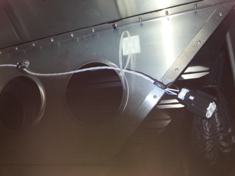

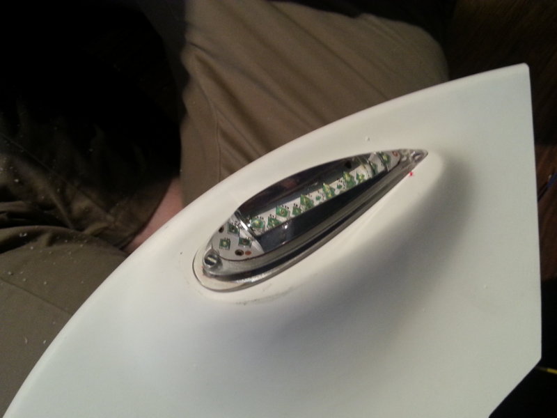

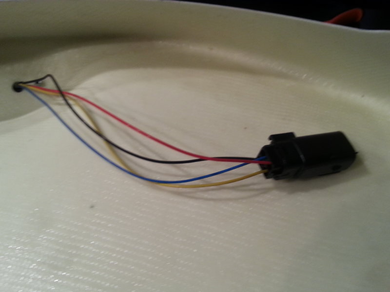

Skee Posted January 4, 2014 Author Posted January 4, 2014 Well its Saturday and i ate a big steak =) And did some electrics, man those strobes are powerful! Molex mx150l plugs are really good. 1

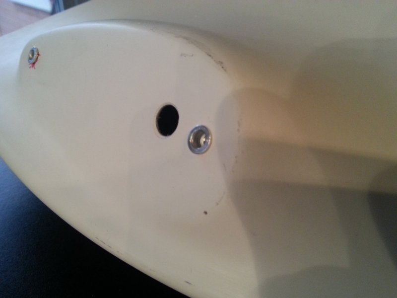

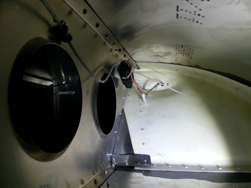

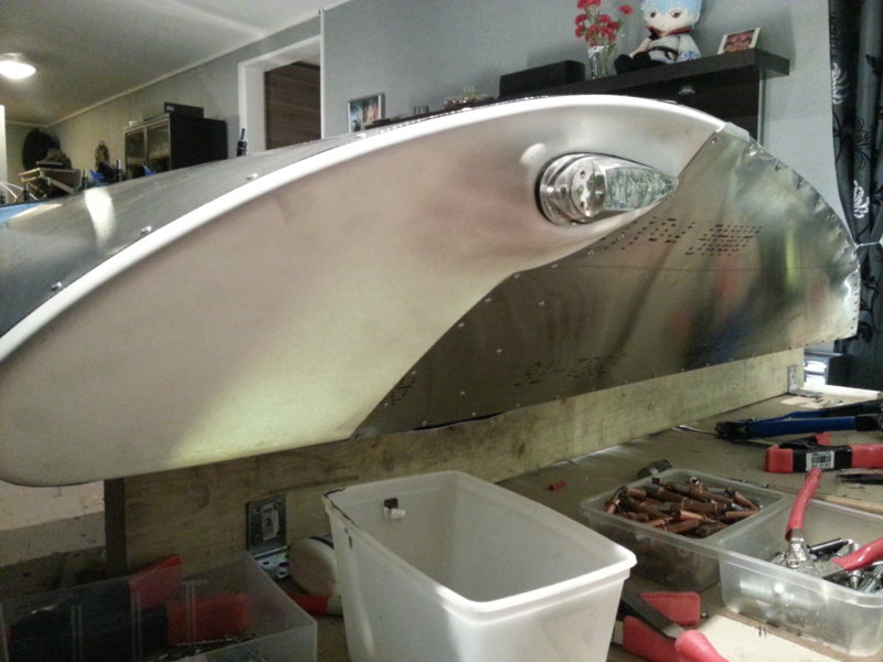

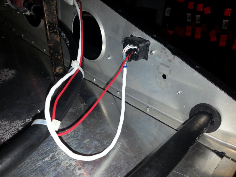

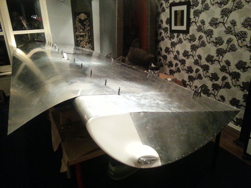

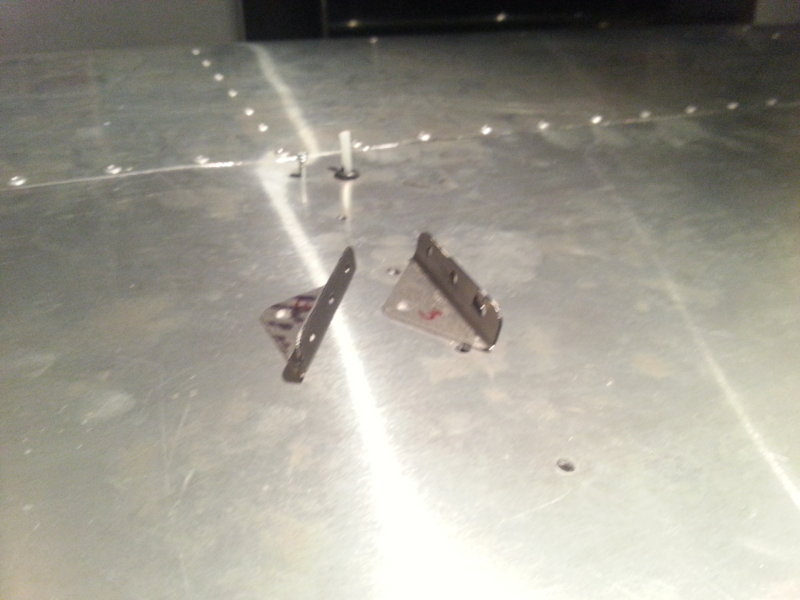

Skee Posted January 6, 2014 Author Posted January 6, 2014 So i spent all day finishing small details and im planning to close the front skin tomorrow. Top skin went on. As last time, the tip details wasn't a perfect fit, i had to make a few customs, also discovered i satten a bracket wrong and had to move it, anyway this tip looked better than the other, al in all it went faster this time since i knew how to do it and had help turning the wing several times witch helped allot. Last photo is of the inspection hatch console, here the manual says, use flush mount rivets, so do they want my to countersink the holes? its very unclear some times. Ended the evening with hanging on the front skin.
rankamateur Posted January 6, 2014 Posted January 6, 2014 Last photo is of the inspection hatch console, here the manual says, use flush mount rivets, so do they want my to countersink the holes? its very unclear some times. They do mean you to counter sink the holes and use flush rivets because the inspection plate, held on with M4 screws in the rivnuts, would sit up on the rivet heads otherwise. 1
Skee Posted January 6, 2014 Author Posted January 6, 2014 I asked Mark on skype but ill also check here. Did you enlarge the inspection hatch screw holes to 4mm, to get som leave, screws are a bit tight? How did you mount the Jury strut mount, with rivnuts?
rankamateur Posted January 6, 2014 Posted January 6, 2014 Only ones that were tight were where the rivnut pulled a bit off centre. Jury struts are still in the box yet!
Skee Posted January 6, 2014 Author Posted January 6, 2014 Only ones that were tight were where the rivnut pulled a bit off centre. Jury struts are still in the box yet! So you havent fastened to consoles above yet?
rankamateur Posted January 6, 2014 Posted January 6, 2014 There is one rivet on each wing I was supposed to leave out, another one to drill out, to install those brackets. I the other holes are drilled when the jury strut is installed after the wings are attached I believe. 2

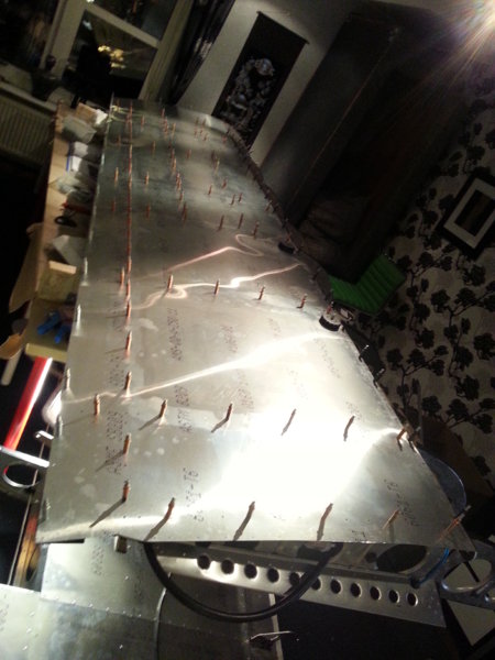

Skee Posted January 7, 2014 Author Posted January 7, 2014 Its 0100 and im using a rivetgun to close up the trailing edge on my wing, suprizingly no neighbours have knocked on my door yet:bash:. Also closed up leading edge today =)
rankamateur Posted January 7, 2014 Posted January 7, 2014 Its 0100 and im using a rivetgun to close up the trailing edge on my wing, suprizingly no neighbours have knocked on my door yet:bash:.Also closed up leading edge today =) [ATTACH]26788[/ATTACH] [ATTACH]26787[/ATTACH] No rivet gun on the trailing edge, use the solid 3/32" rivets. Looks like you did that anyway.
Skee Posted January 7, 2014 Author Posted January 7, 2014 No rivet gun on the trailing edge, use the solid 3/32" rivets. Looks like you did that anyway. Rivet gun for solid rivets ;) It hammers. 1

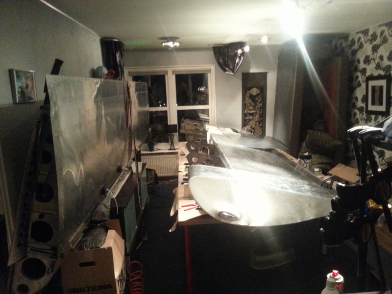

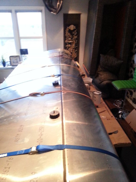

Skee Posted January 9, 2014 Author Posted January 9, 2014 Last wing finally done, now i need ideas how to get them 3 floors down thrue the window, anyone?
rankamateur Posted January 10, 2014 Posted January 10, 2014 Last wing finally done, now i need ideas how to get them 3 floors down thrue the window, anyone?[ATTACH]26804[/ATTACH] Skyhook?
eightyknots Posted January 11, 2014 Posted January 11, 2014 Last wing finally done, now i need ideas how to get them 3 floors down thrue the window, anyone?[ATTACH]26804[/ATTACH] Good question, but I don't have the answer!
Flyinglion2000 Posted January 11, 2014 Posted January 11, 2014 Block & tackle hung from a mechanics engine hoist ?
Kyle Communications Posted January 11, 2014 Posted January 11, 2014 All depends on how big your window is…otherwise it will be an expensive exercise. Making a lifting arm is the easy part
Skee Posted January 12, 2014 Author Posted January 12, 2014 It was outmost intresting getting the wings down,and it just had to snow on the night too. ' 3
