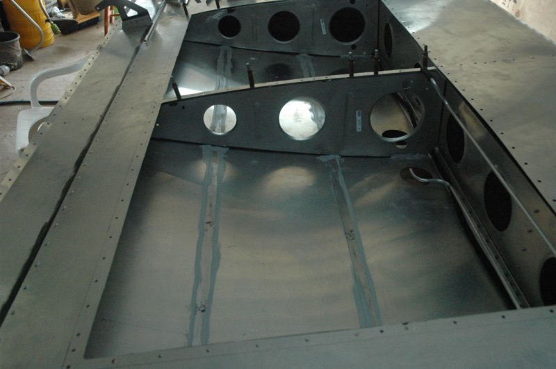

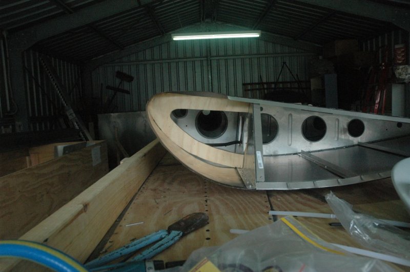

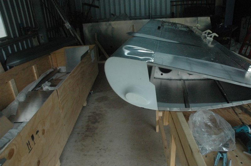

You can see the right angle skin tensioners in the tip of the wing they are in 2 places in the top and bottom skins behind the main spar and full length of the wing skins except where the fuel tanks are of course to stop the oil canning. I also made up flat strips and sikaflexed them to the skin above both fuel tanks in each wing to also stop this they are not right angles but are locked between the skin and rib as the others are.

Kyle, that is the first time that I've seen them going in that direction, The one I've seen are 90 degrees to yours, parallel to the ribs. They are pretty common on 701s and CH just calls them stiffeners. But I have no idea what is allowed in your country as they are not in my plans. There are pics on the US Zenith site and I believe some in the old Zenair news as well. Almost forgot, the reason I replied, lengthways on the wing like yours is much easier to fabricate, I like it.
Kyle, that is the first time that I've seen them going in that direction, The one I've seen are 90 degrees to yours, parallel to the ribs. They are pretty common on 701s and CH just calls them stiffeners. But I have no idea what is allowed in your country as they are not in my plans. There are pics on the US Zenith site and I believe some in the old Zenair news as well. Almost forgot, the reason I replied, lengthways on the wing like yours is much easier to fabricate, I like it.Kevin
Hi Kevin
The wing skin tensioners are just that they give some hold to the wing skins top and bottom. They are basically no weight at all but provide a lot of torsional strength to the wing skins as they are riveted to the skins top and bottom. The ones I made for the top skins on my Savannah do not have the right angle bend as of course they won't fit between the wing skin and the top of the tank. I didn't rivet them either I sikaflexed them to the skin but they still lock under the rivet that goes into the top of the rib edge. This just helps the wing ribs remain where they are supposed to be. The outside panel on the top and the bottom outer section of the tailplane did not have any tensioners in one section either side out towards the tips on the tailplane. So I used right angles left over from the wing to do exactly the same and this made the tailplane so much stronger before you could press the skins in easily now you can not.
