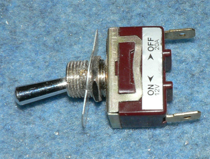

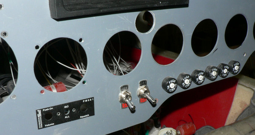

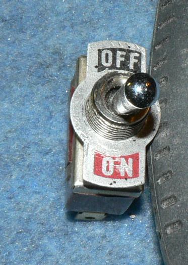

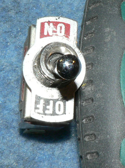

Note the panel switches in previous days pics. The labels are marked the wrong way up for conventional aircraft panel installation.
So have removed the labels and turned the switches so that UP is ON or CLOSED except for the two IGN switches on the far left of the panel.
The IGN switches are set with UP as OPEN circuit i.e. not earthed.
Down for the IGN switches is closed circuit therefore connected to EARTH which should stop the engine if both are closed.

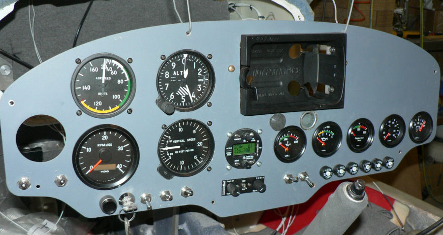

Refitted all instruments (some of them twice:confused:) and wiring.
Inserted extra switch on left of panel. Will do another tomorrow.
[ATTACH]3930.vB[/ATTACH][ATTACH]3931.vB[/ATTACH][ATTACH]3932.vB[/ATTACH]

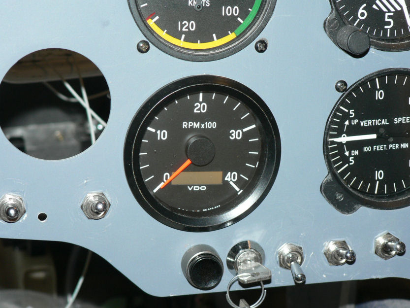

I actually put lights in the instruments - so I could read the hourmeter & see something working.
[ATTACH]3933.vB[/ATTACH][ATTACH]3934.vB[/ATTACH]
Note blank time hours that
you can read in a dim cabin[ATTACH]3935.vB[/ATTACH]
Will have to check that circuit breakers are in the circuits.
Panel was live in the photo with radio scanning traffic as far afield as Melbourne, Mildura, Dubbo and Mount Gambier.
I don't sit in it and go brmm brmm!
There is too much stuff on the seats and on the floor!

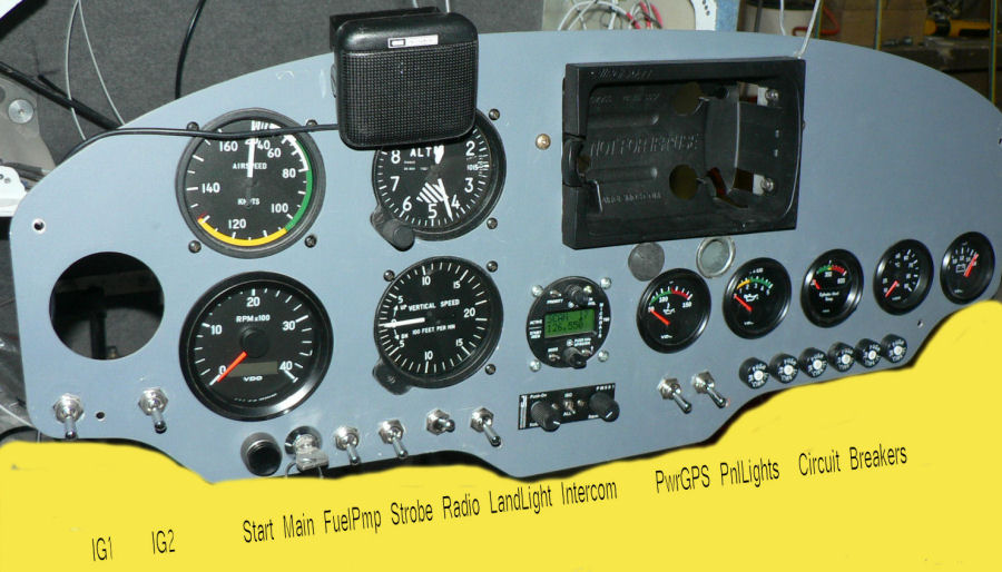

Put a couple of extra switches in the panel.
Checked to ensure the circuit breakers are included in the circuits.
See the switch order in the photo below.
[ATTACH]3939.vB[/ATTACH]
G'day Ross - have you put lights in all of the instruments :;)5:
I didn't think it was possible, my airspeed doesn't have a light built in. 049_sad.gif.af5e5c0993af131d9c5bfe880fbbc2a0.gif
How do you get the light fitting out of the back of the smaller gauges :;)5:
Mine seems to be stuck - tried everything except brute force but I'm worried I might break something. 068_angry.gif.cc43c1d4bb0cee77bfbafb87fd434239.gif
regards
Hi Peter
Not lights in all, only the engine gauges.
Most of the engine gauge light holders can be removed by pushing vertically down on them near the end not close to the instrument and then pulling them out rather than trying to pull them out directly.
Only one of them has to be pulled out. I think it was the CHT gauge.
My flying instruments do not have lights.
My reason for the lights is that I have a tinted windscreen and after experiencing trying to read the hours on the rev counter of the LSA55 Jab at Griffith with a clear windscreen I wanted a light on my hour meter and it gives me something to look at that works before I get to fly the J160.
Also it makes it easier & quicker to to read the engine gauges.
Probably eyes in daylight flying would have smaller apertures while looking out and then would have to open wide to compensate for less light in the cabin looking at the dark instruments with black faces white figures and red hands and would also have to change their focus more than they would if still operating on a smaller aperture.
So changing focus and opening the iris more and then the opposite when you return to look outside all takes significant time some of which could be reduced just by lighting the gauges or better still make them look like my watch.
Maybe they would be better off like the analogue watch battery powered watch that I wear. It has a white face with black numbers, a red second hand and a pale green black edged minute and hour hand (luminous).

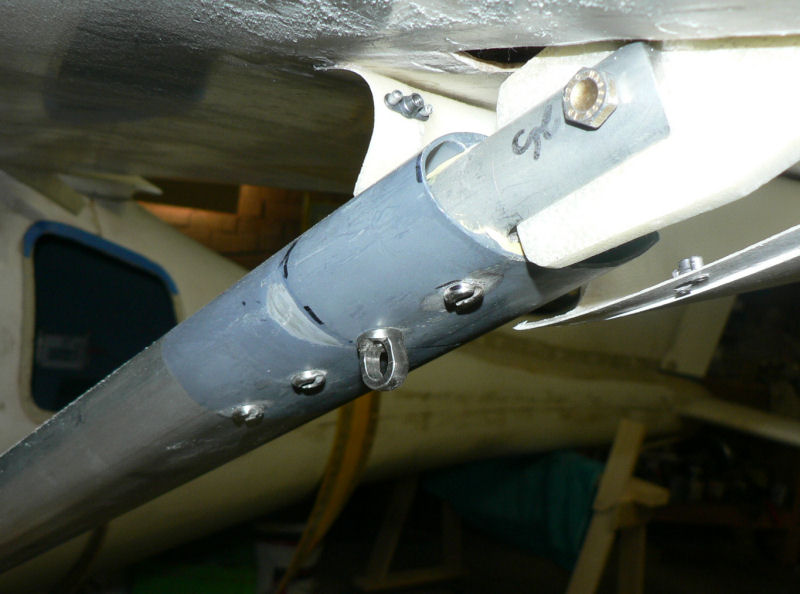

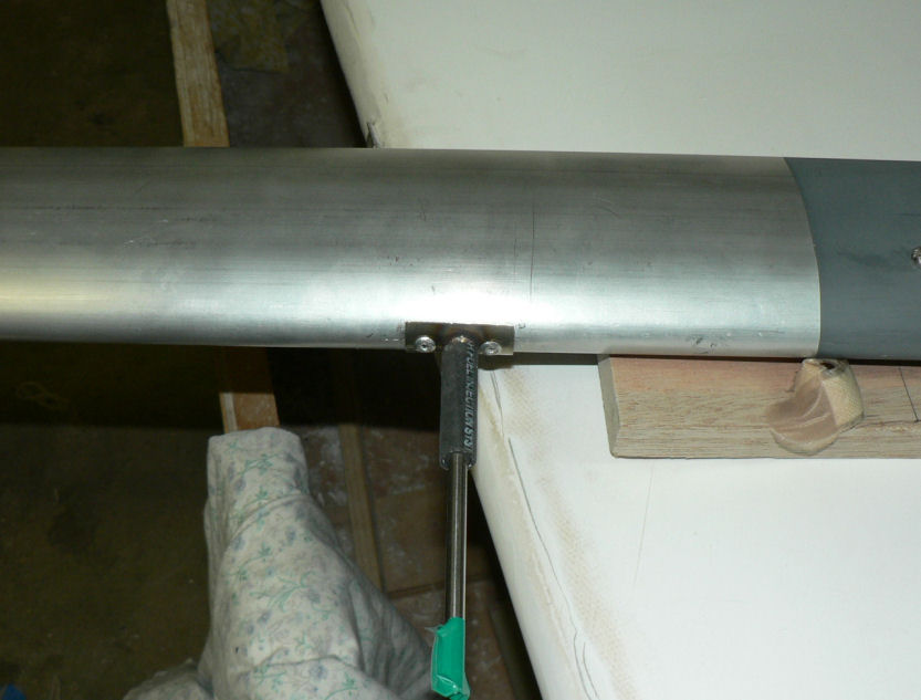

Fitted Pitot tube to RH wing strut 300 mm from top end of the hollow part of the strut with plastic tube attached. Left about 100 mm protruding from bottom end.
Fitted the SS tied-own eyelet to the second last bolt position on RH strut, the same end as the pitot tube.
No tying ropes half way down the strut!

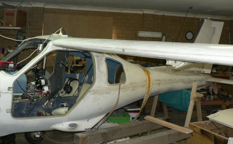

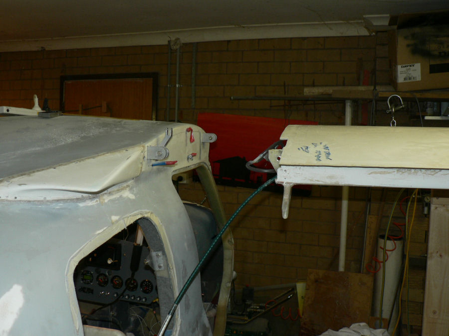

Removed wing root covers from RH wing.
Removed flaps from RH wing
Disconnected RH wing from A/C.
[ATTACH]3940.vB[/ATTACH][ATTACH]3941.vB[/ATTACH][ATTACH]3942.vB[/ATTACH]
Cabin area next

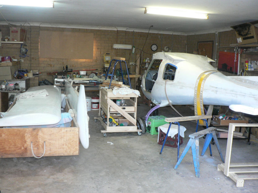

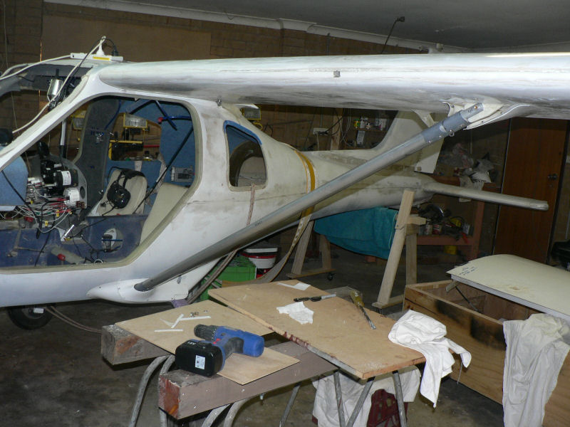

Turned the aeroplane around to enable the wing root covers on the LH wing to be fitted and swept out the dust.
Fitted the LH wing to the ac with inboard bolts only so far.
Bought some SS worm drive hose clamps with rounded edges as the supplied clamps do not seem tight enough and are not worm drive.

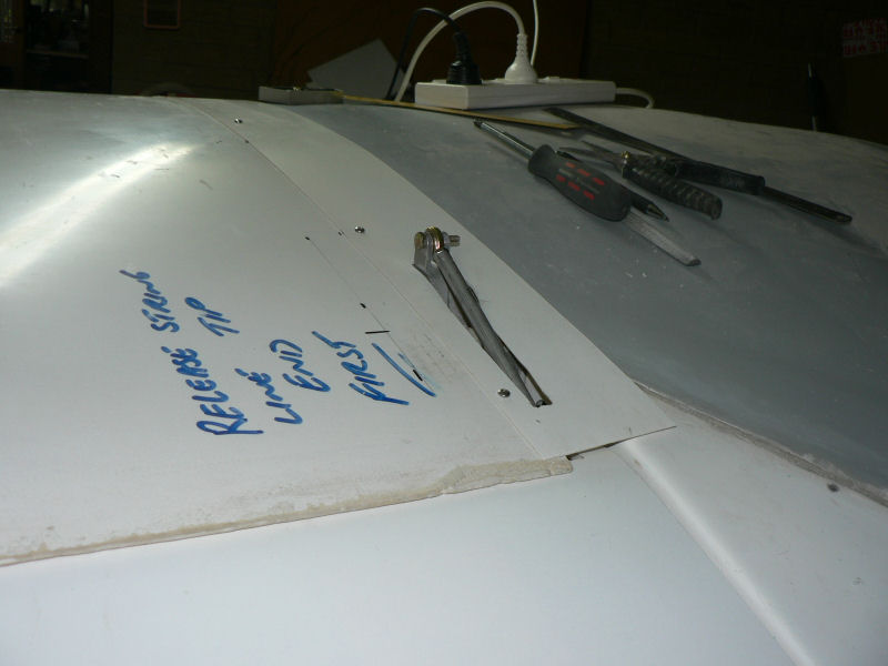

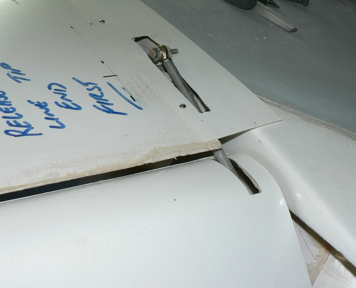

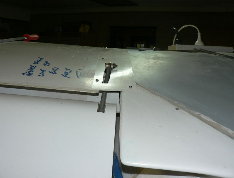

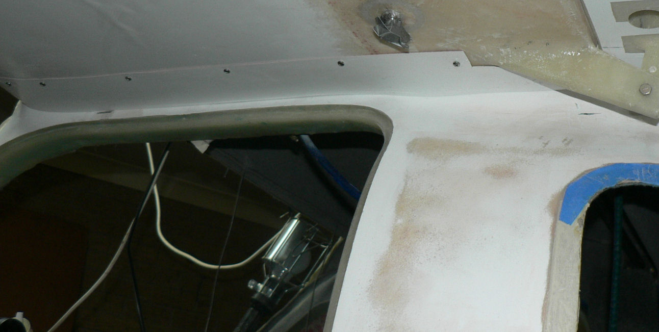

Fitting cover strips to LH wing root area.
Connect LH Strut to wing & fuselage & check fairings for clearance & adjust
Cut top cover strip to fit & drill holes & fit self tappers
Cut slot to fit flap arm & fit flap to LH wing
Extend slot to suit flap rod connection.
Fit & cut to match bottom cover strip'
Drill & fit screws to match
Check flap for full movement up & down
Remove cover strips & remove flap
Disconnect strut & disconnect wing from fuselage.

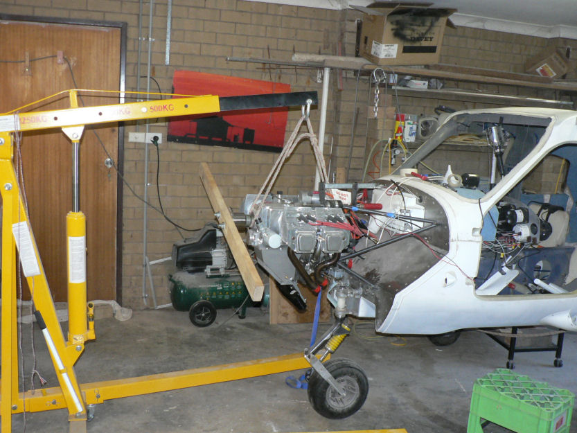

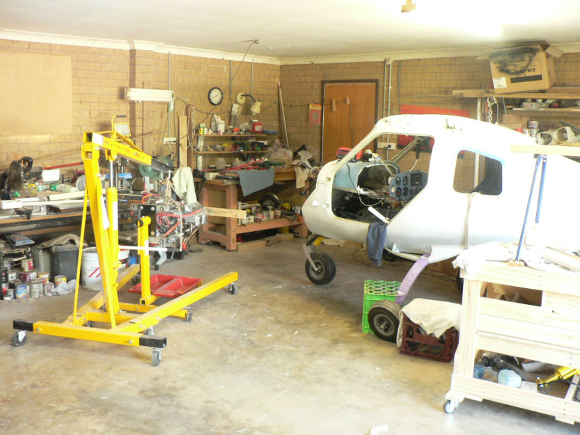

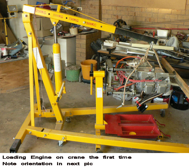

Rearranged a/c in carport for engine installation.

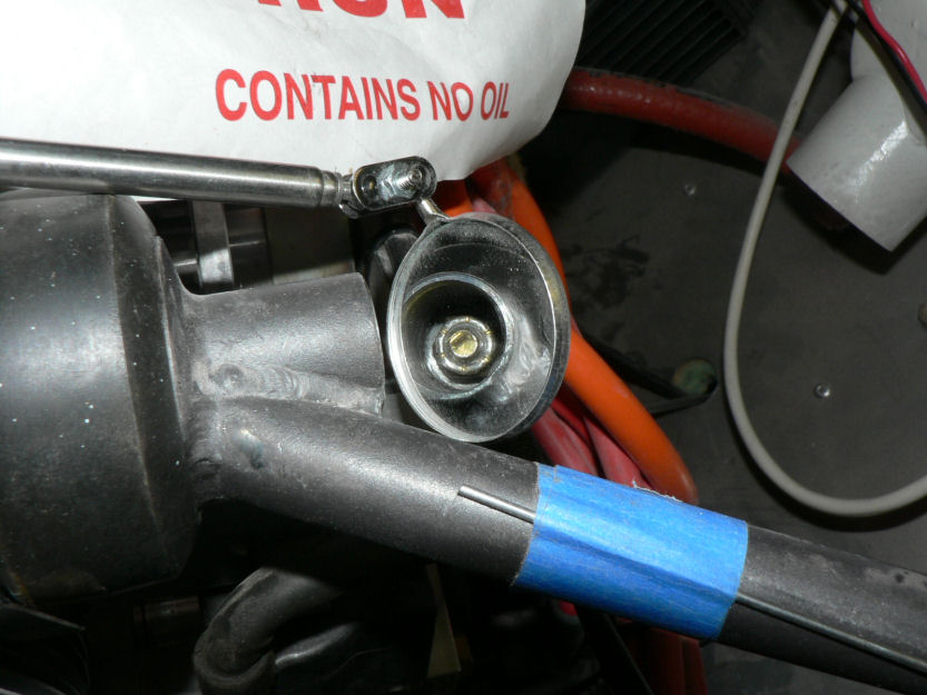

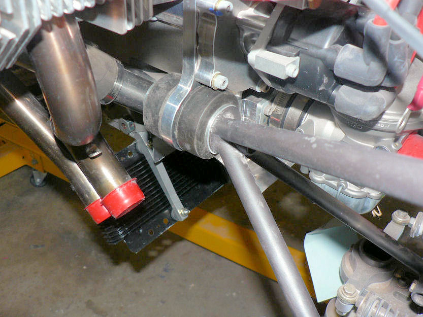

Lift engine Jab 2200A from engine stand with engine crane.

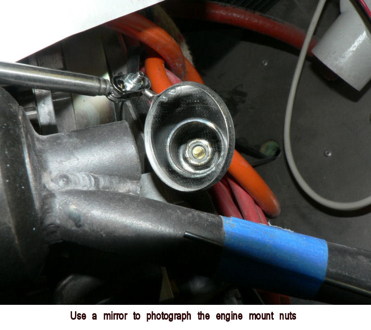

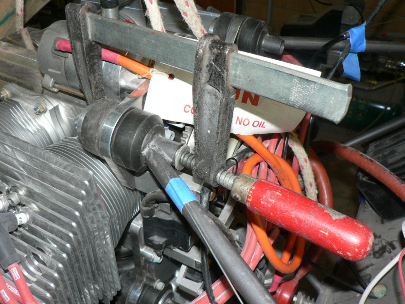

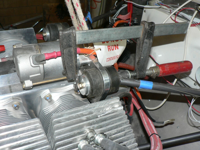

Attach engine to engine mounts with washers and spaces and rubber bushes arranged as per Jabiru drawing - note top & bottom mounts use the same parts but are arranged differently.
Used a 7/16" socket with a nut in it to hold another nut in place while the bolt is turned by spanner in the compressed rubbers and engages the hidden nut. See the pic.
Once the bolt has started in the nut the clamp can be removed and the bolt tightened normally with a socket and an open ender or an offset 7/16" ring spanner.

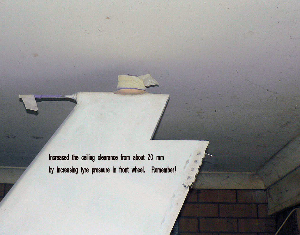

Put more air in front tyre to increase ceiling clearance from about 50 mm to maybe 150 mm.
One of the lessons from this exercise so far - build a shed first.

Had another look at the engine mounting bolts and the construction book- decided I had the bolts in the wrong way and should have had heat proof nuts on them.
Rectified that.
From the pics you can see that the clamp I am using to compress the engine mount rubbers could be modified so that the socket spanner will fit through a hole at the non screw side of the clamp so that the clamp could be kept straight while pulling it up.
I will have to braze or weld a slightly thicker piece of steel on that end with a hole in it big enough for the socket and washer to fit through.
Attached the oil overflow reservoir and fitted the hoses - still need a clamp underneath to locate the overflow hose.
Sat the air ducting on top of the engine cylinders - need to be reinforeced at the join with a couple of layers of glass. Wiil do that once it all looks ok.

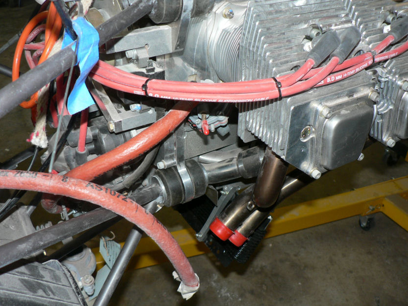

Engine earth strap made up and fitted from battery to engine
Pic 6:
Engine earth strap at battery end.

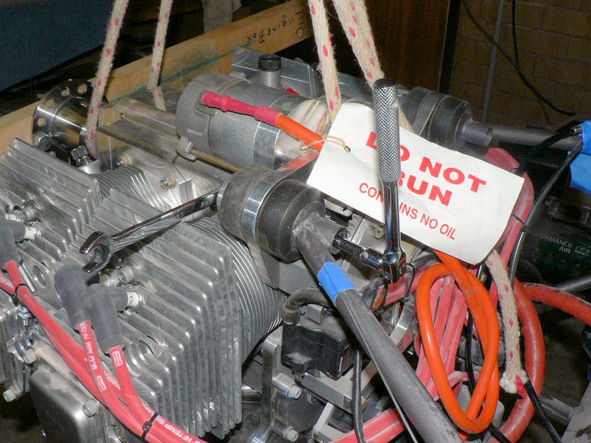

Removed spark plug leads from spark plugs.
Added 2 litres of Shell Aero Oil to engine
Removed 1 spark plug from each cylinder
Removed exhaust pipe and carburettor covers
Turned engine over clockwise a number of times.
Spun engine on starter motor for 20 seconds or so a couple of times.
Pic 7:
Replaced spark plugs, but not spark plug leads, exhaust pipe & carburettor covers and turned on battery charger.

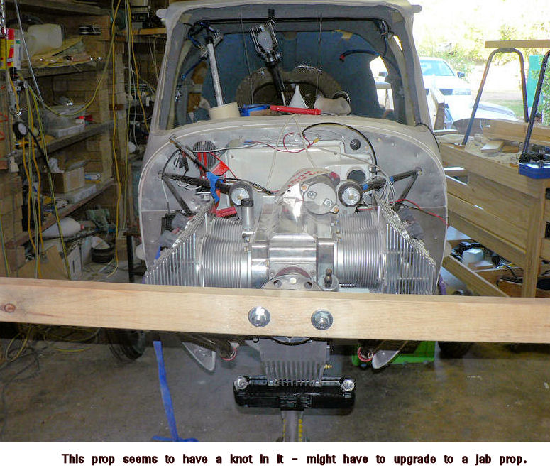

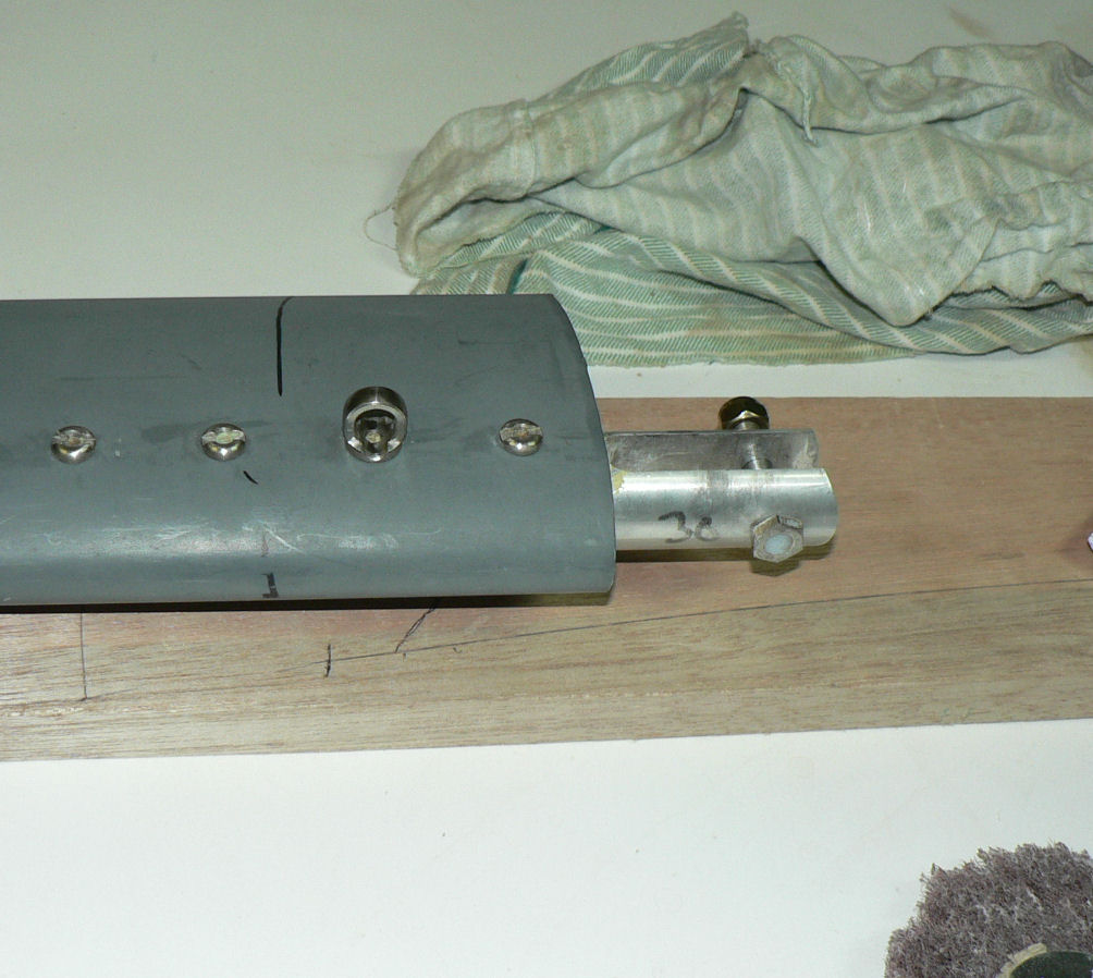

Removed a spark plug from each cylinder to reduce loads when checking the prop tracking.
Set up a stick on the front UC leg to test the tracking of the prop when bolts tensioned to 6 ft lbs = 72 inch pounds.
Prop was out by about 4 mm variation from one blade to the other - first suggestion in construction manual made little difference. It was to torque an extra 2 ft lbs for three bolts on the high side of the prop. So I tried this in two stages increasing the torque each time. No joy.
The high side of the prop appeared a little rough so I did a lite scrape on it. Hooked it up again and checked the tracking of the prop still more than 2 mm difference.
Removed the prop again and sanded it litely on the high side of the wooden prop boss to level up the bumps.

Refitted the prop tried the tracking at 72 inch lbs torque on all bolts and it was less than the 2 mm limit at about 1.75 mm - OK.
Spinner Tracking: Pics 8 - 11
Set up a pencil mounted on a stick to track & mark the spinner.
Spinner was pushed around to optimise the tracking and the screw holes relieved accordingly. Needs a little more to be done after smoothing up spinner & painting.

24-10-2007
Looked for a non magnetic set of feeler gauges in our local engineering supplies shop for the second time; still no stock; so I ordered a set.
Today was a mixed bag and I did not remember to take all the pics to show it.
Fitted small Aluminium brackets to the ram air ducts and lock wired springs to #1 & #2 cylinders to hold down the ram air ducts onto the cylinders. The drilling for bolting to the tappet covers and fitting of the ducts had been done previously.
Had to remove the ducts to get enough room for a hand inside the duct as it requires a 1/8" steel washer on the rivet inside the fibreglass duct to secure the loaded rivet.
I still need to reinforce the join in the ducts with glass and epoxy and also to mount & epoxy the air cooling tubes for the two coils. I need to match the length of the ram air ducts to suit the cowls once they are fitted and also to fit the flat rubber (neoprene?) material on the front of the "ram air ducts".
I rang Jabiru to establish that a 90 mm diameter hole was required not a 90 mm circumference hole??? in the front of the mated cowls.
Myles also said that the engine with full power would pull to the right. So this has to be allowed for in setting up the cowls.
I asked him for the desired clearance from the back edge of the prop spinner to the front of the cowls. He said 6 mm or a bit less but up to 8 mm was OK.
The cowls were taped together with duct tape - some cleaning up of mating surfaces is required. They were drilled with 2 x 1/4" holes to take the quick couplings at the front inside the air holes.
The centre of the joined cowls was found and a 90 mm diameter circle marked out and cut out using a jig saw.
I decided to start with the top cowl. The oil cooler will make the bottom one impossible to fit without modifying the old style cowl #14 kit.
Sat the top cowl on its rear mounting position to find that it is too long by a few mm and will need to be turned a bit to the right and lifted at the front to centralise the spinner in the cowl face and allow for engine movement under full power.
This means that the back edge of the cowl has to be trimmed a variable amount from each side towards the centre top rear of the cowl which would be the biggest trim. It will also need more off the right hand side than the left to lean it to the right - how much to allow for moving under power ??
Once I get that cowl looking to be a good fit I will work on mating the bottom cowl to it.
All this is assuming the engine is mounted in the right place with the correct alignment and clearances.
I have no way of knowing more about that until the engine is fired up to full power and ultimately until the test flight.
At the stage of the last two pics the top cowl still needs to come up at the front by 10 mm or more requiring more material to be dressed off the rear end of the cowl.
The cowl in the last two pic is attached by 2 temporary SS self tappers, one on each side at the bottom rear edges of the top cowl and the front is sitting on the prop boss in both pics. The cowl had been trimmed by about 4 mm along the rear edge before I anchored the bottom left corner.

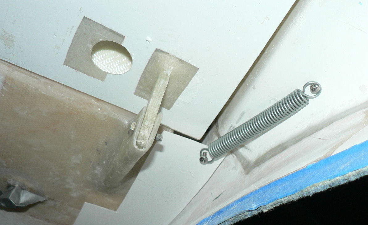

25-10-2007
The non magnetic (brass) feeler gauges arrived today @ $16-45. They actually phoned to say it had arrived!
Continued to trim the top cowl until it fitted OK.
Installed the cam locks as per the drawing on the top cowl - Not OK. They were in conflict with other parts of the aeroplane - I should have learnt by now.
Removed cam locks.
Reinstall cam locks for top cowl in different locations. Needed to relieve the installation location of the cam locks as the material was too thick to allow the camlocks to work by a couple of mm.
Filled old cam lock holes with epoxy flock.
Pics 1-3: New cam lock locations and filled holes
Pic 4 : Duct retaining springs lock wired onto #1 & #2 cylinders.
Battery Earth wire connection to engine.
Pic 5: Glass over the extra holes in the top cowl - hope I have filled the right ones.
[ATTACH]4123.vB[/ATTACH][ATTACH]4124.vB[/ATTACH][ATTACH]4125.vB[/ATTACH][ATTACH]4126.vB[/ATTACH][ATTACH]4127.vB[/ATTACH]

For RPM initially had to find the small Hall effect probe for the tachometer which I had put in a safe place - so looked where I thought I had put it months ago but could not find it on the first try. Eventually found it there after searching the rest of the workshop.
As usual the 8 pin socket for the tacho was not supplied with a multi pin socket. So a visit with the tacho to the local auto electrician resulted in a socket with some spare contacts for $5-08. The tacho has 5 contacts in the 8 pin socket enclosure and has 4 of them in use according to the Jabiru wiring diagram.
The Hall effect probe wiring was so fine that I had to solder the leads to the connectors to stop them falling out.
The Hall effect probe uses two small tabs on the back of the flywheel to trigger a signal so I presume that means 2 pulses per revolution of the flywheel.
So using the sunken button on the rear of the tacho I set it to "Pulse" and then 2.0 pulses per revolution.
The motor was spun up on the starter motor but as there was no flicker on the tacho I presume (hope) the low voltage caused by the starter motor was not enough to operate the tacho circuitary assuming I have set it up correctly.

Decided to install new style cowls top & bottom for J160 as my has a long oil cooler mounted across the sump. The new style cowl already has a lip on the bottom to improve air flow but still needed the oil cooling air intake to have a few cms removed from the inside edge to avoid fouling the oil cooler and to match the angle of the oil cooler.
The aluminium piano hinges for the cowls were marked very carefully along their length with a carpenters marking tool - don't know the name- then at 95 mm centres using a steel compass they were marked off and then centre punched for drilling both sides of each hinge together with the hinge pin installed.
This made it possible to use either half of the hinge as a template when marking and drilling the cowls for the rivets to hold the hinges.
It was decided not to exit the hinge pins into the cabin area because of their alignment and the possible effect on the structure but to bend them over and cover them with the top edge of the bottom cowl. So the top couple of SS CSK screws need to be removed from the bottom cowl to facilitate removal of the hinge pins. This is necessary for removal of the top cowl.
Once I started using the cable ties to tidy up the wiring in the engine compartment and behind the panel I found my self cutting more wires, cable ties and crimping more fittings onto wire. As each lot was tied it made it more obvious what had to be done.
I shall take another wiring photo inside the engine compartment when the cowls come off again.
All the scat hoses need fitting and the holes to be cut in the bottom cowl for air intakes. I am not going to fit the optional supplied fibreglass cabin heater but will eventually fit the one that Jabiru put in their certified A/C. at $A510 (Plus GST of $51 for Aussi customers) for parts.
The wiring is a work in progress.

Secured the oil breather overflow hose and the fuel pump drain with a clamp & cable ties.
Fitted scat hose & fitting from carburettor to air cleaner.
Rearranged engine earth cable routing & cable ties in engine bay. Added a couple of saddles to carry wiring across the firewall.
Removed #3 exhaust pipe for welding of EGT fitting to hold EGT sensor.
Tried the extra terminal on the oil pressure sensor as a sender for low pressure warning light. As Jabiru say in the manual - not used.
Noticed the carburettor needs to be earthed to the engine to help reduce any possible radio interference. Not done yet.
Removed spark plugs and checked the gap. All within spec. Replaced with anti seize on thread.

Connected the throttle cable to carburettor & set the stops approximately. Fitted a low throttle stop. Still need to flock in a maximum throttle stop in the cabin floor under the throttle lever.
[ATTACH]4506.vB[/ATTACH][ATTACH]4507.vB[/ATTACH]
Note if throttle cable disconnects from carburettor, the throttle goes to wide open - maximum setting!
Connected the choke cable & set the stops.
