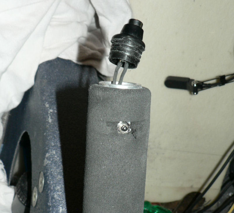

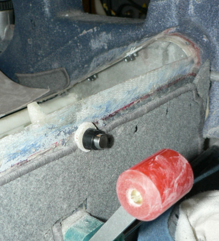

Some pics of where we are up to a few days ago now.
[ATTACH]821[/ATTACH]
Co pilot PTT button - packed out to help tank clearance under seat

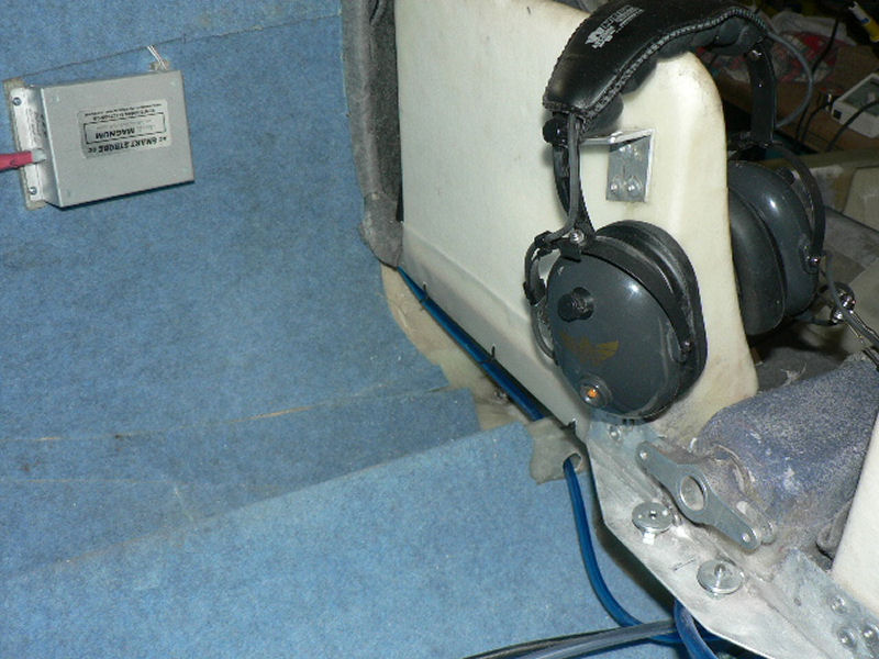

Co_Pilot PTT Cable Ties_ under Passenger seat Header tank
[ATTACH]823[/ATTACH]

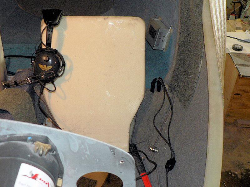

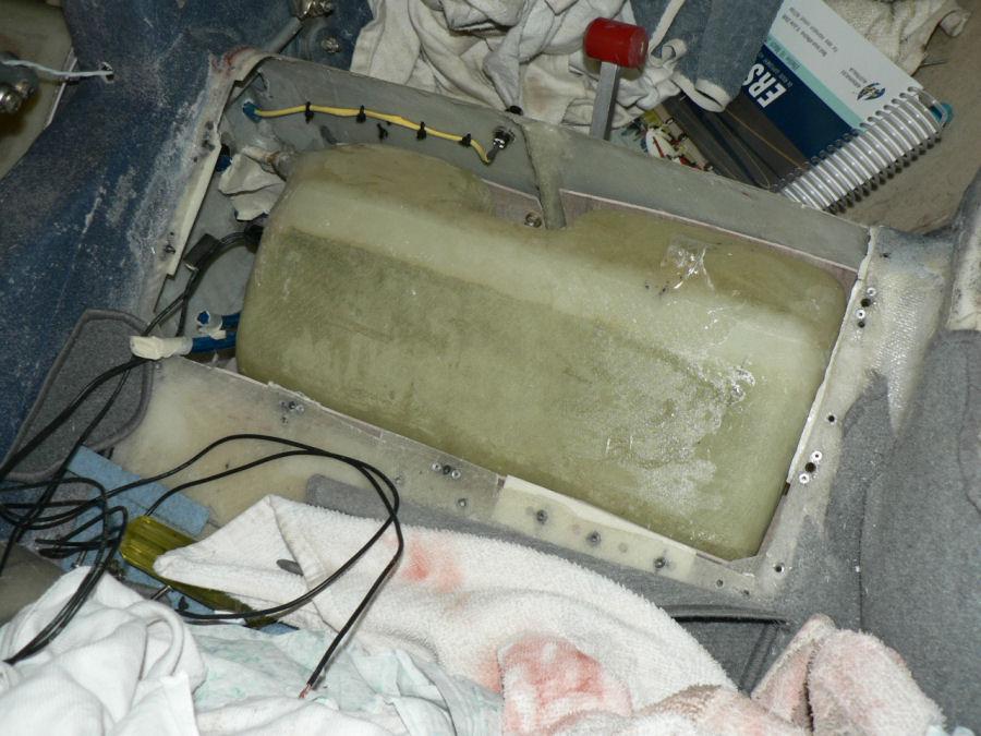

Radio harness - Header tank under copilot seat- note lining all around tank to prevent fibreglass to fibreglass contact.
[ATTACH]824[/ATTACH]

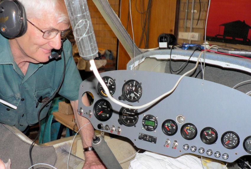

Hi Crew
A bit more work done today.

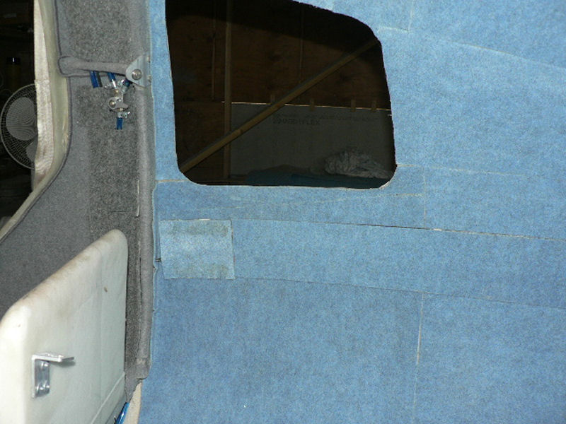

Vacuumed the luggage compartment & covered the strobe output wires, the aerial wires in the luggage A & B compartments and some fuel lines.
Made up some new covers for wiring & fuel hoses and put more goo on them than previously because the velcro was coming loose on previously done covers - disaster the goo went right through the felt and is showing up on the other side. They will work but look terrible. I will have to do them again - later! Apply a sealer first then the adhesive perhaps.
Made another mistake. I should have fitted both doors before fitting the instrument panel. It is going to be possible but more awkward fitting the pilot side door. The passenger door was pre-fitted so that the hinge holes are drilled for that side but not the pilot side yet.
I am waiting on a parcel from Jabiru which includes some more 10 gauge wire to make up for some rearranging of the wire behind the panel.

Covering the strobe high & low voltage wiring - the 12V supply is up over the pilot side door.
[ATTACH]827[/ATTACH]
Pilot side - radio jacks with instrument panel suspended in the foreground
[ATTACH]828[/ATTACH]

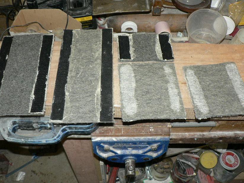

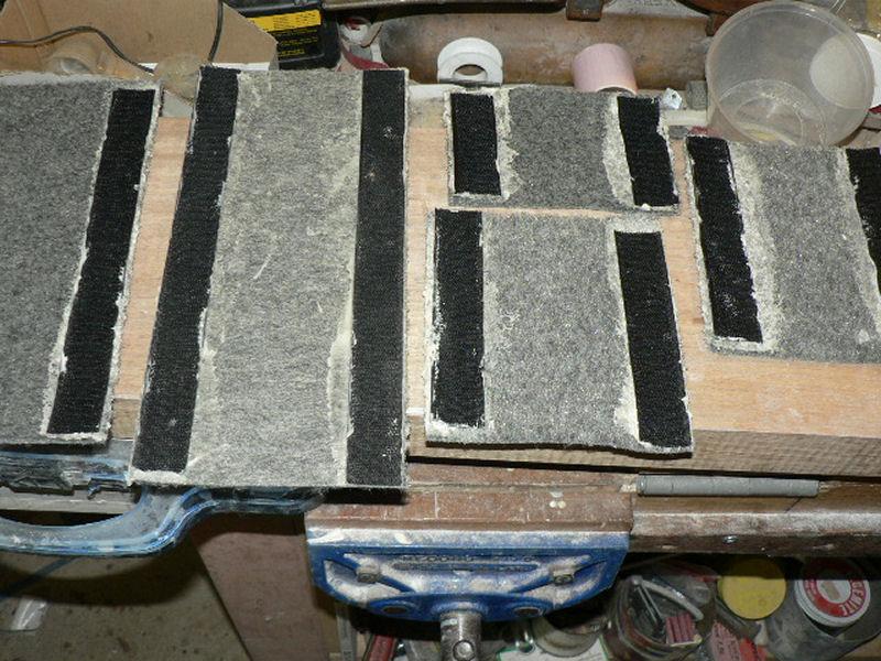

Making up some new velcroed covers
[ATTACH]829[/ATTACH]
Disaster - the adhesive is showing on the outside of the ones I have turned over and the felt (not Jabiru felt) is a different shade of grey on each side and I have mixed them up!
Maybe I should just put dark curtains on the back windows!
Regards Ross

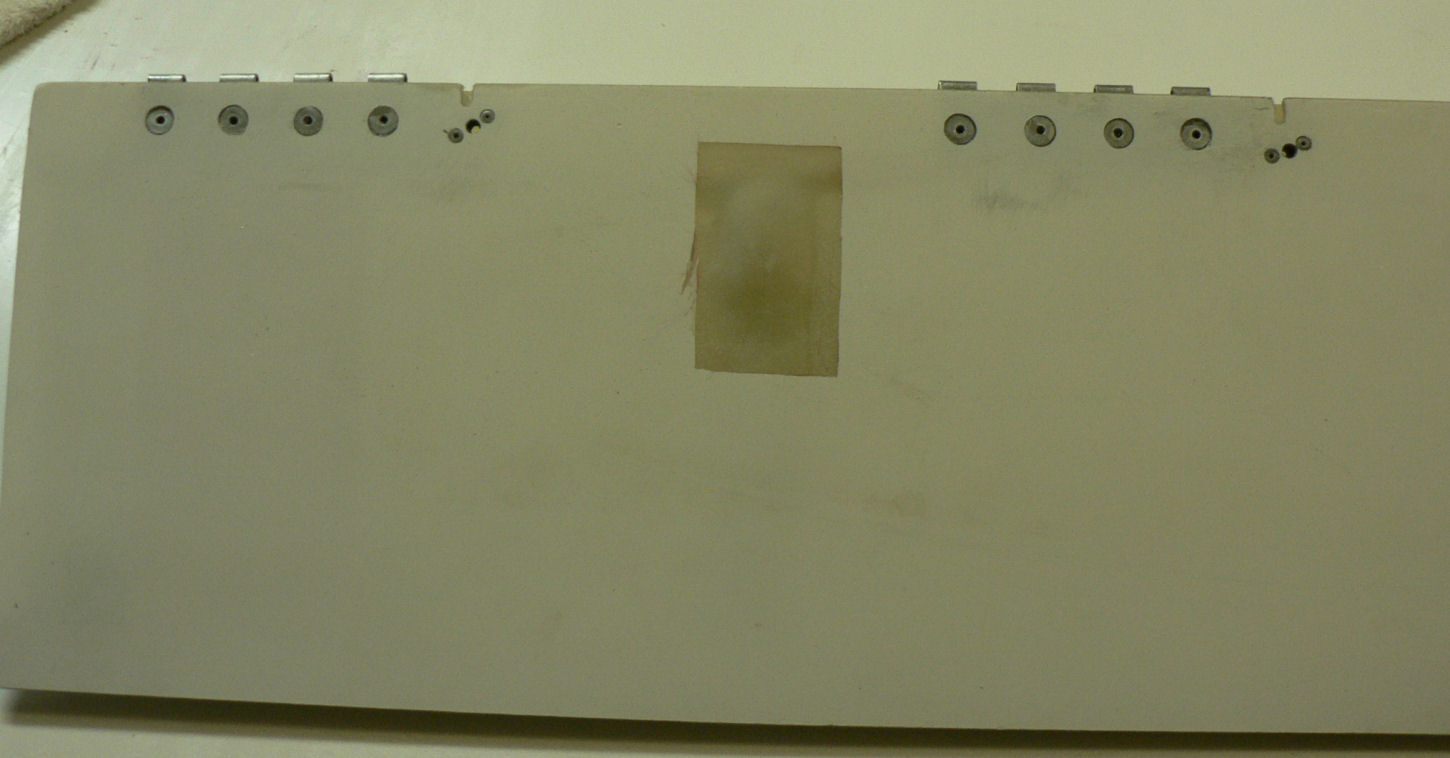

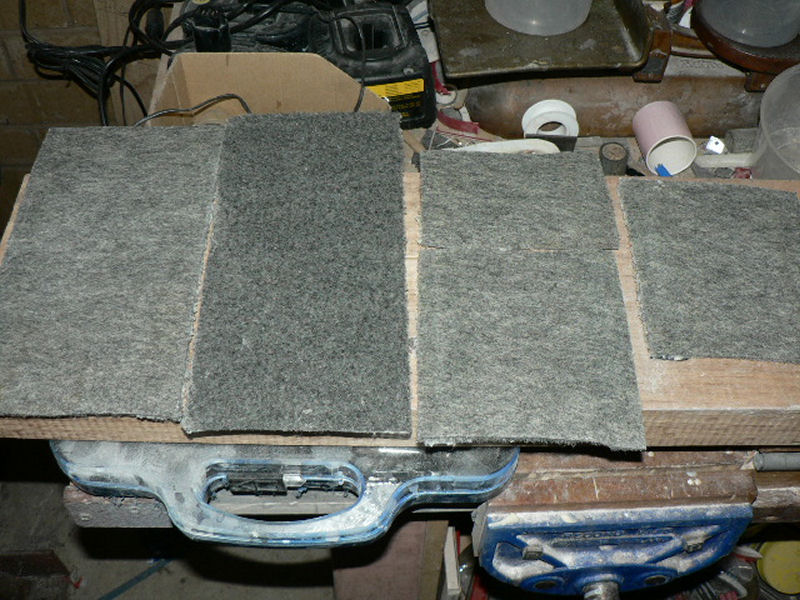

Hi Crew
It looks like the white adhesive colour on the back of the covers largely dissapeared once it had dried overnight.
[ATTACH]830[/ATTACH]
But you can clearly see the colour difference from each side of the felt of the two pieces on the left of the pic - nothing to do with the adhesive!
Ross

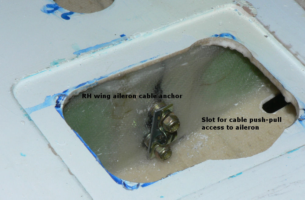

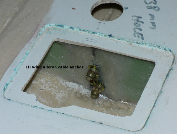

Hole for aileron cable installation has been made and 38 mm hole cut for access.

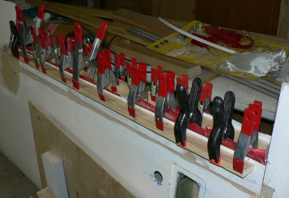

Some four plastic spring loaded clamps purchesed a short time ago all failed when opened and used to clamp the trailing edge of the flap to the timber. These four clamps were all manufactured in a country a fair way to the North of Australia.

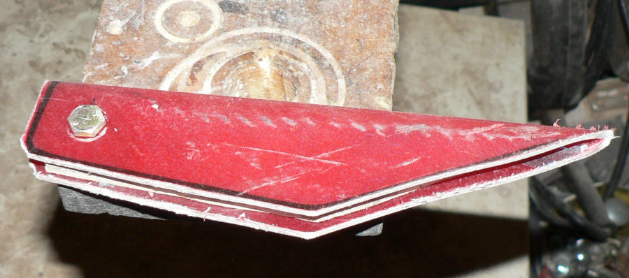

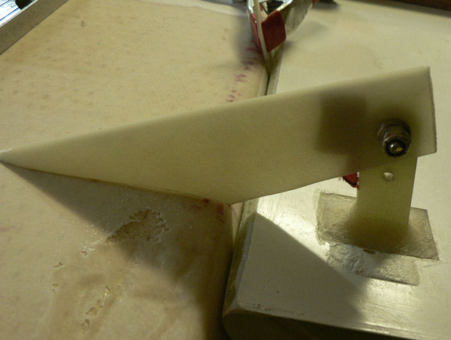

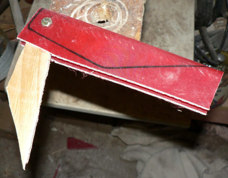

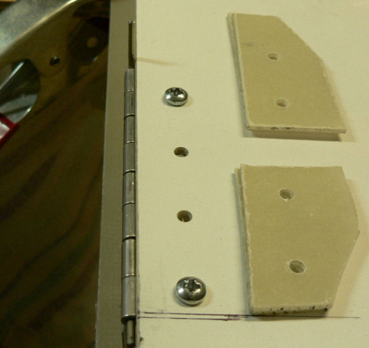

Drilling flap support brackets to take AN3 bolts (3/16")
[ATTACH]1993[/ATTACH]
Bolting flap support bracket with temporary wooden spacer to work bench steady ready for trimming by jig saw.
[ATTACH]1994[/ATTACH]

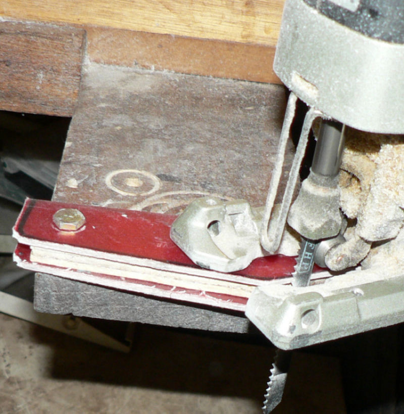

Trim flap support brackets with jig saw
[ATTACH]1995[/ATTACH]
Trimmed flap support bracket
[ATTACH]1996[/ATTACH]

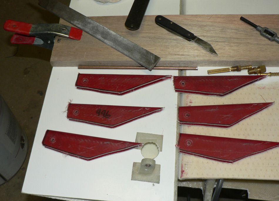

Flap support brackets for two wings
[ATTACH]1997[/ATTACH]

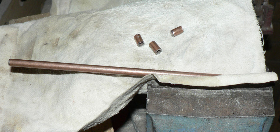

Cut steel flap bushes from 1/4" Bundy steel tubing 2 mm longer than than SS bushes in flap supports.
[ATTACH]1998[/ATTACH]
Bundy bush inserted into flap support bracket SS bush after reaming to fit with total of 2 mm extrusion
[ATTACH]1999[/ATTACH]
One of three wooden supports for each flap before attaching flap support brackets and inserting temporary 2 mm spacer between wing and flap.
RH Wing continued - Click on images to enlarge
[ATTACH]2003[/ATTACH]
Holding Bundy steel bush flush with one side of SS flap bush for dressing up by file.
[ATTACH]2004[/ATTACH]
Newly dressed up wing to Flap support bracket ready for epoxy & flock
[ATTACH]2005[/ATTACH]

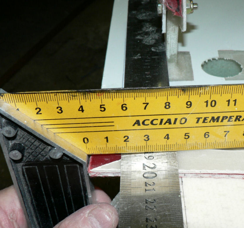

Checking flap position 45 mm from line through outer edge of wing mountings to edge of flap bracket

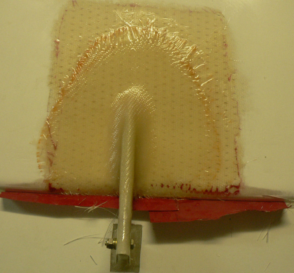

RH Wing continued
Drill the wing flap support brackets to suit AN3 bolts 3/16" & cut the wing flap brackets as marked.
Dress up the brackets by file to sit flush on the wing.
Cut 3 Bundy steel bushes from 1/4" Bundy tube to be about 2 mm wider than the flap support brackets.
File the steel bushes to size and square off.
Set up the wing flap support brackets with 2 mm space between wing and flap for the RH wing and 45 mm from the inboard end of the wing beam carrying the SS bush to the flap support bracket.
Flock inside the wing flap brackets and epoxy on the wing where the bracket seats..
[ATTACH]2009[/ATTACH]
RH Wing inboard flap support bracket flocked to wing after curing
[ATTACH]2010[/ATTACH]
RH wing Centre support bracket flocked to wing after curing

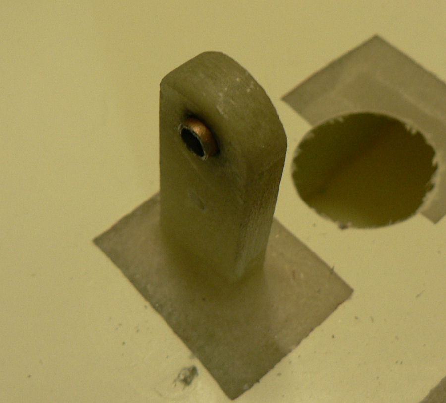

Each of the flap support bracket will be reinforced with three sheets of fibreglass reo epoxied to the bare patch.
Regards

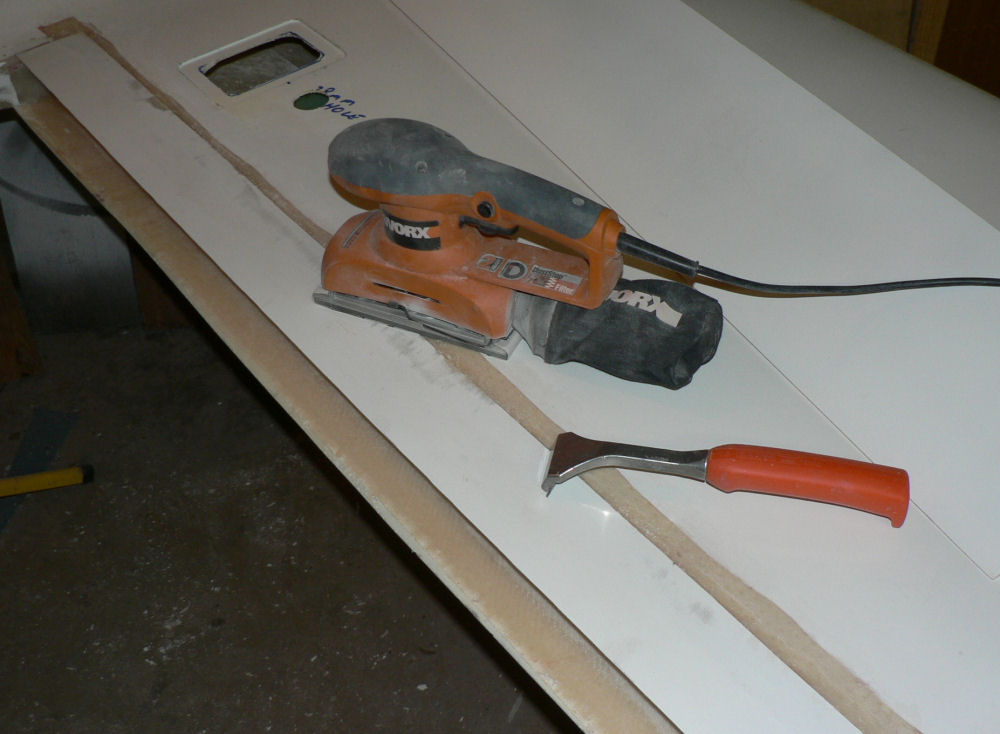

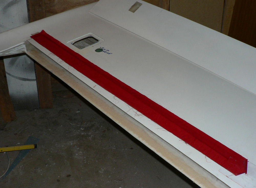

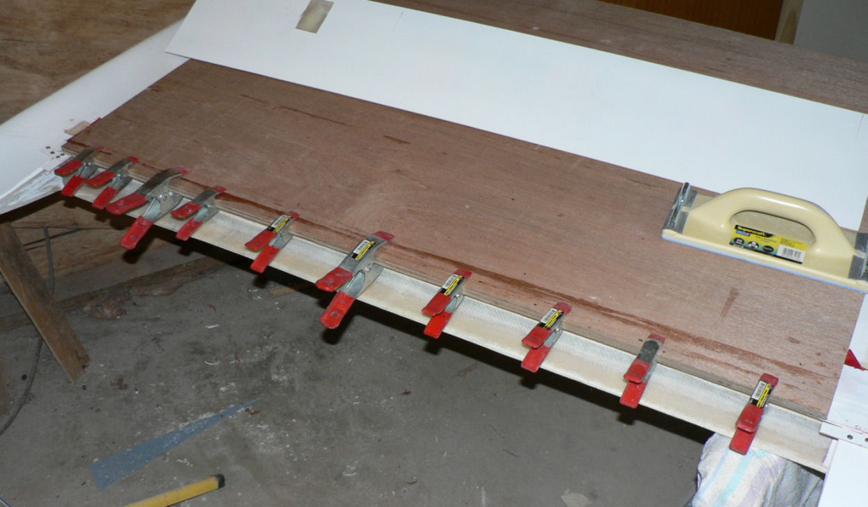

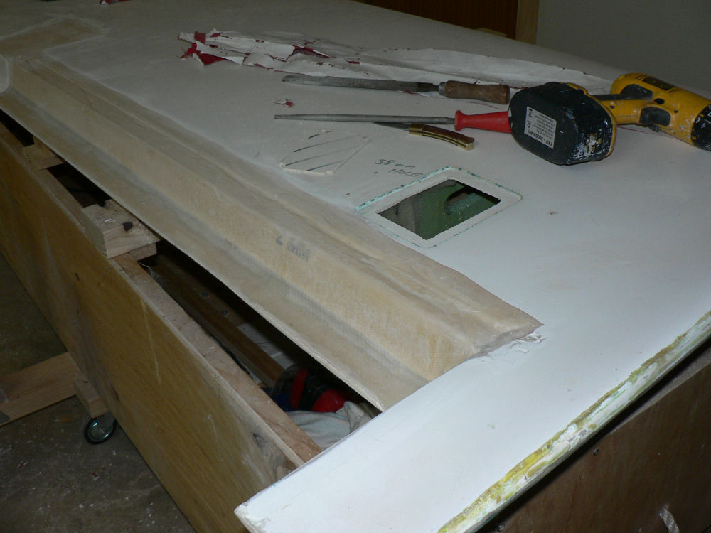

RH wing Aileron base
The RH aileron base was cut to match the recess precast for it in the outboard rear end of the RH wing so that aileron when mounted with hinges on it will be aligned with the trailing edge of the flaps.
[ATTACH]2011[/ATTACH]

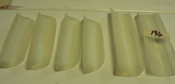

Two sets of premoulded fibreglass reos that are part of the reinforcement to be used near each of the aileron hinges
[ATTACH]2012[/ATTACH]

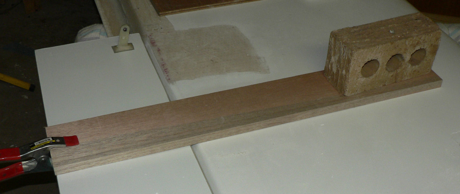

The aileron mounting plate is supported by the wood sheet so that it is held up above the wing recess filled with epoxy & flock.
Each of the three hinge positions will have a premoulded fibreglass reinforcement plus two lots of reinforcement.

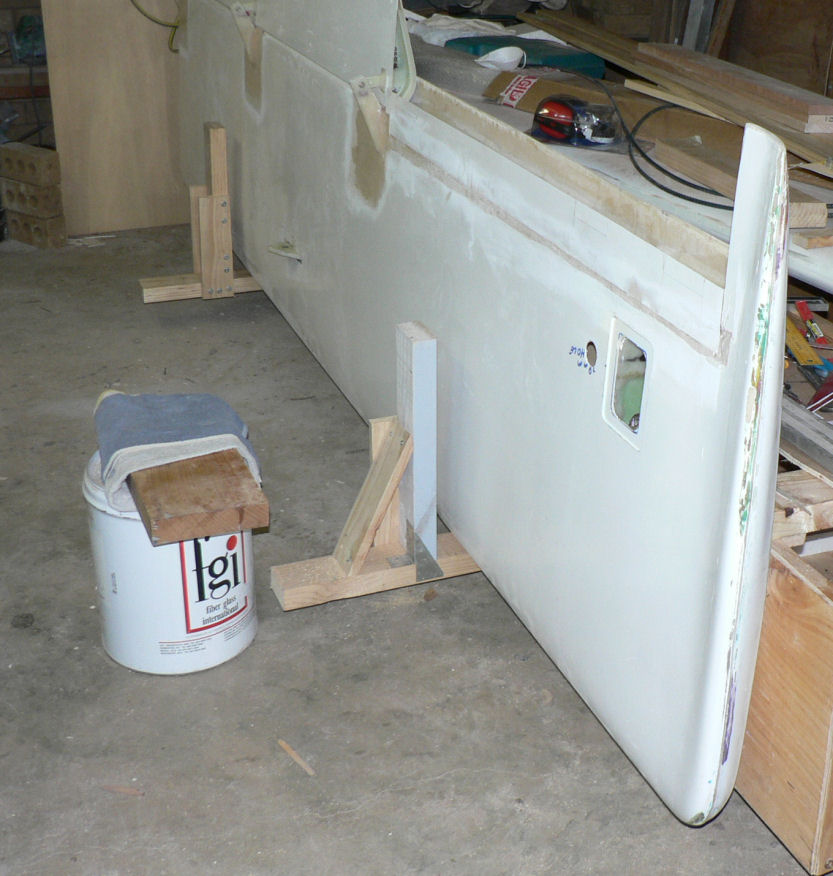

Today rearranged the garage a bit to get a bit more working space around the plane. Got castoring wheels on the wing box and made the garage door wide enough to get the plane out w/o wings (done some time ago). I also started mounting a timber frame support for a wing on its edge on the edge of the wing box and one in or on top of the portable wing box which has been cut back to the length of a wing.
[ATTACH]2020[/ATTACH]
Can sit one wing vertical & one horizontal or two wings horizontally on top of wing box.

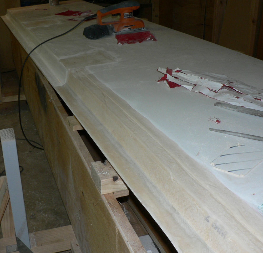

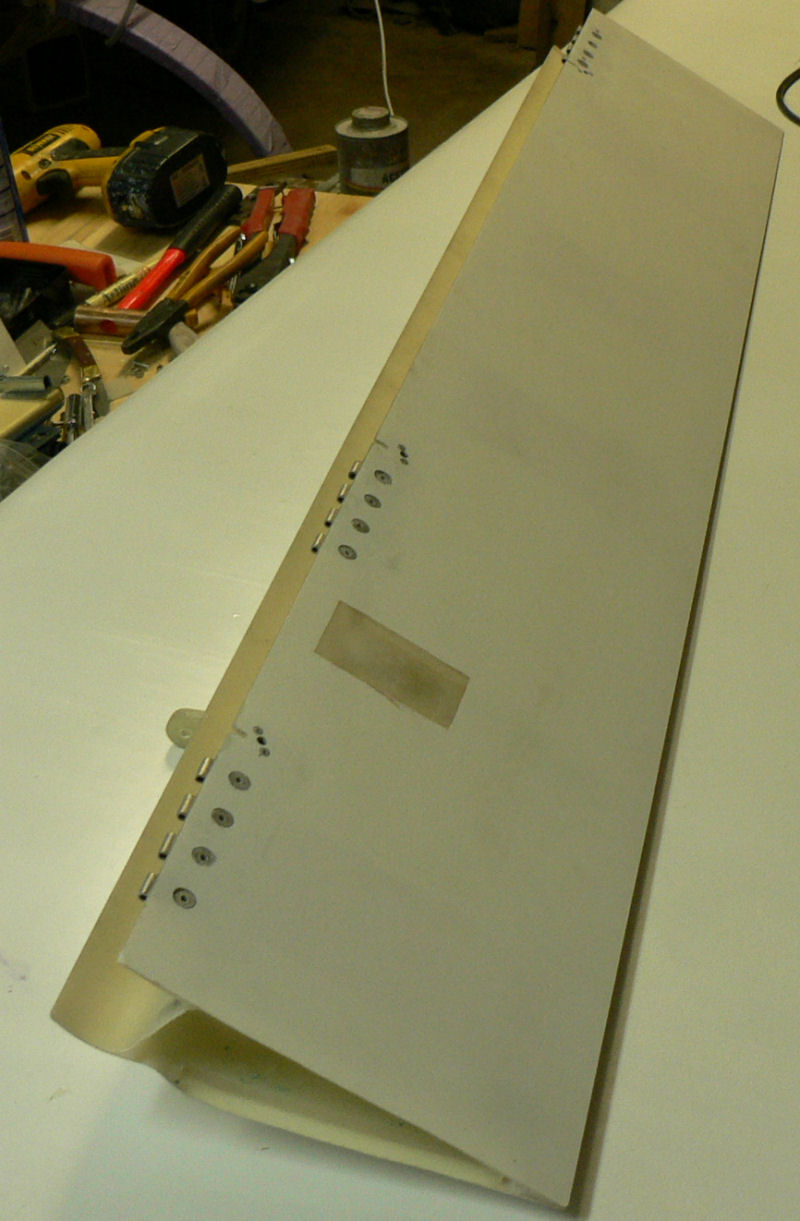

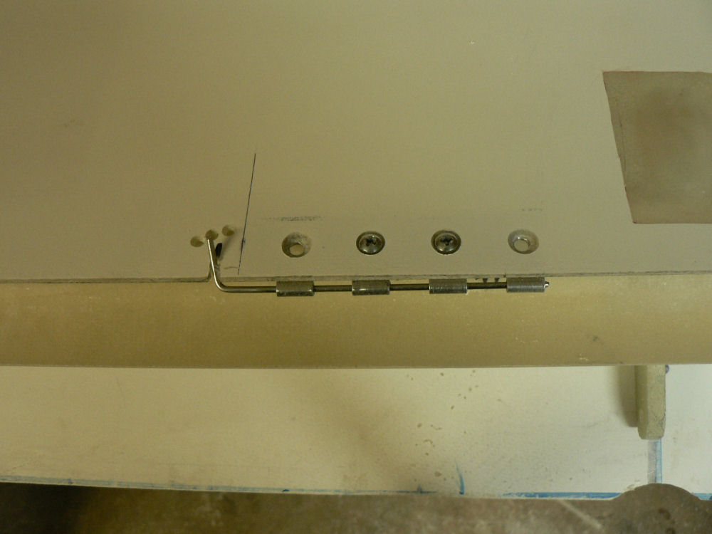

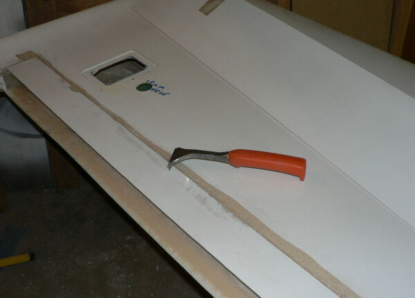

Cleaned up the aileron hinge mounting strip after flocking in place.
[ATTACH]2022[/ATTACH] [ATTACH]2023[/ATTACH] [ATTACH]2024[/ATTACH]
After building the frame on the wing box and mounting the RH wing in it, flocked in the three aileron pre-moulded reos for the RH wing. Hard to photograph no contrast between the reo covered on flock & background with flock on it as well.
Also made up drilled spacers to facilitate drilling the holes to hold the hinges on the ailerons at their correct location. Two layers of scrap fibre-glass off cuts from trimming the flap supports were used as packers rather than trying to hold the hinges in place on a curved surface.
[ATTACH]2025[/ATTACH] [ATTACH]2029[/ATTACH]

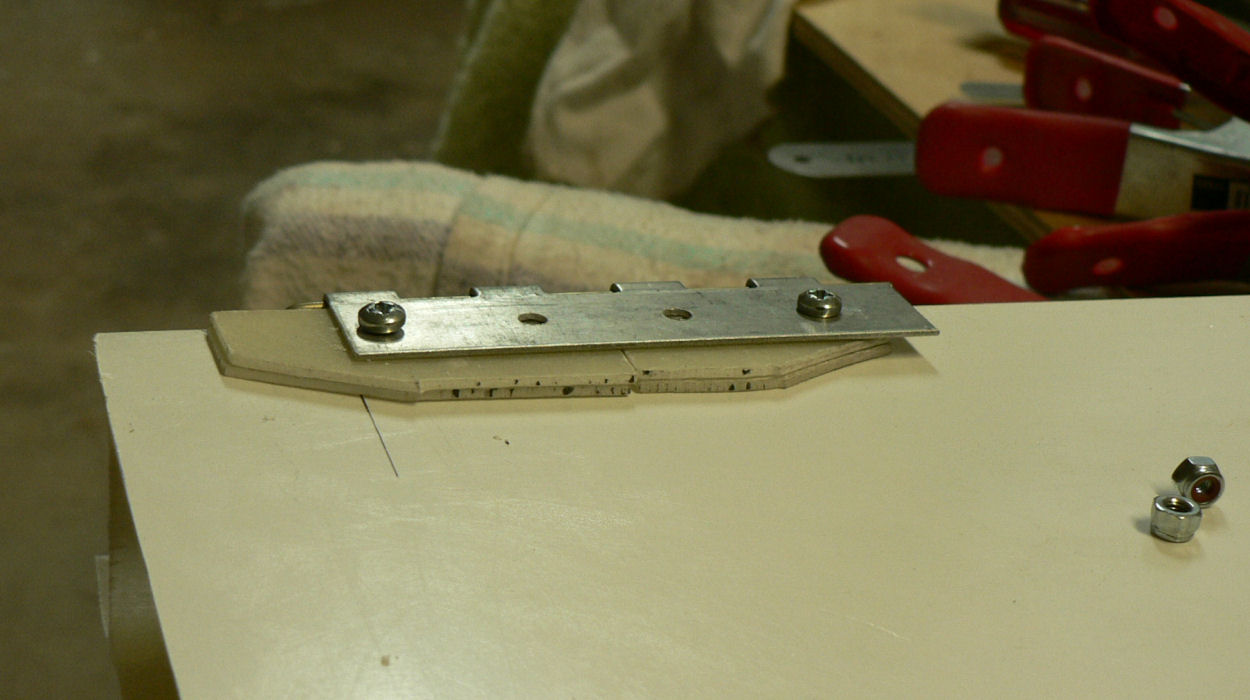

Hinge set so space between aileron & wing will be thickness of hinge pin. Hinge held in place by M4 bolt.

Using the hinge packers made a couple of days ago so that the hinge can be temporarily mounted on the outside of the channel until all the holes are drilled, prefit RH aileron & drill 5/32" outer holes in aileron hinges first before wing hinge positions. Insert M4x12mm hex bolt & nut in outer hinge rivet positions. Hex bolt is easier to get on & off than the Phillips headed pan bolts using a ratchet 7mm spanner and 7mm ring spanner.
Set hinges so that the space between wing & aileron is equal to the thickness of the hinge pin when the bottom surface of the wing is in line with the aileron bottom surface.
Once holes are drilled mount up hinges using outer holes in each of three hinges with bolts to aileron & wing positions.
Check alignment and adjust if necessary maintaining hinge pin clearance between wing & aileron and even end clearance between flap & aileron and aileron and end of wing.

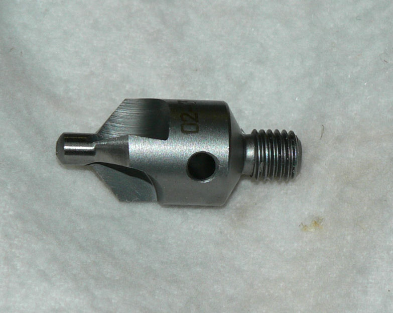

Countersink all rivet holes so that rivets will be flush with surface.

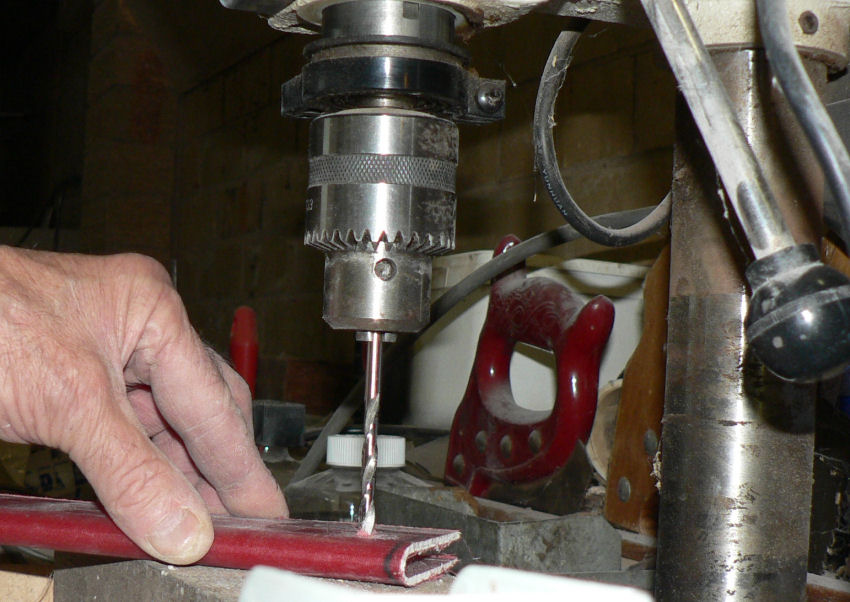

Drill rivet holes and access hole for retained nuts for hinge pin locking tabs.

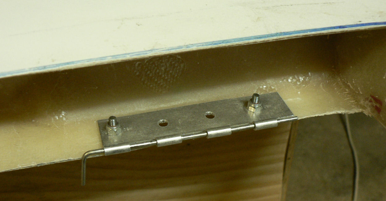

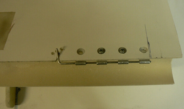

[ATTACH]2073[/ATTACH] [ATTACH]2074[/ATTACH]

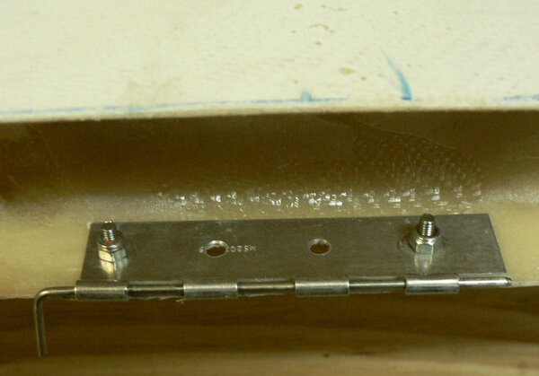

Outer two aileron hinges in wing channel
[ATTACH]2075[/ATTACH] [ATTACH]2076[/ATTACH]

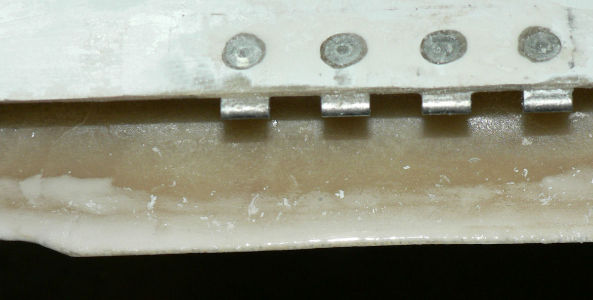

Outer two aileron hinges on RH aileron showing CSK holes for hinge rivets and locking tab position

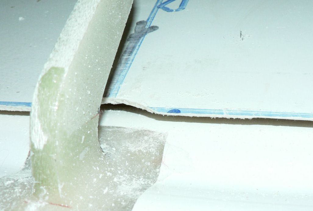

Mount RH aileron by inserting hinge pins as previously fitted

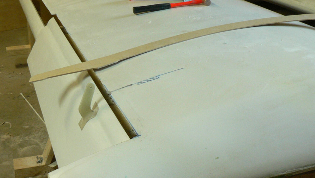

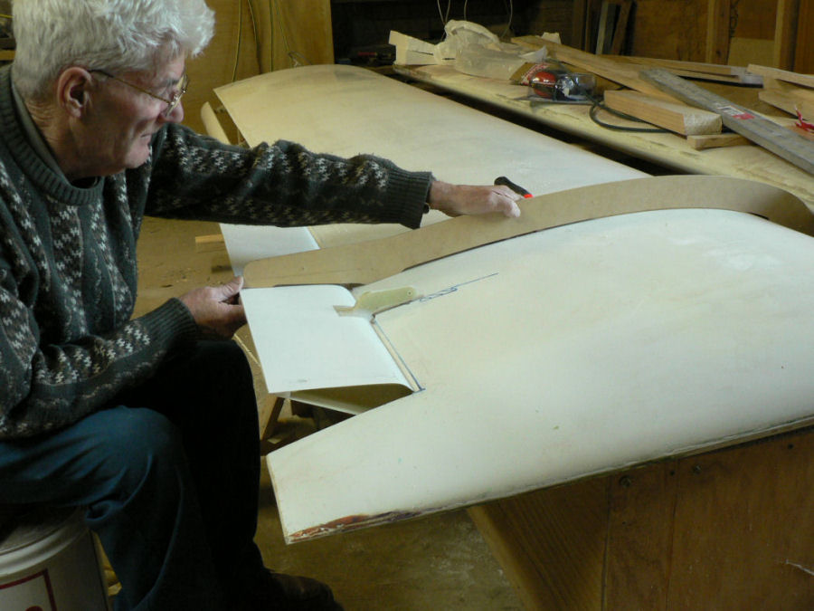

Check clearance around aileron arm on wing and trim glass to fit
Check clearance of aileron for full control movement using factory templates.
Trim waste with jig saw and angle cut with jig saw checking clearance with templates.
Will dress up edge with flock and file to fit.
[ATTACH]2077[/ATTACH] [ATTACH]2080[/ATTACH] [ATTACH]2078[/ATTACH] [ATTACH]2079[/ATTACH]
Aileron pins in; Dress to fit; Check templates for up & down full & free

Countersink hinge positions on aileron, sand hinges and fibreglass and then clean all surfaces to be flocked with Acetone.
Flocked in RH aileron hinges and hinge pin keeper retained nuts maintaining alignment.
Set 3/16" CSK rivets with pop rivet gun.

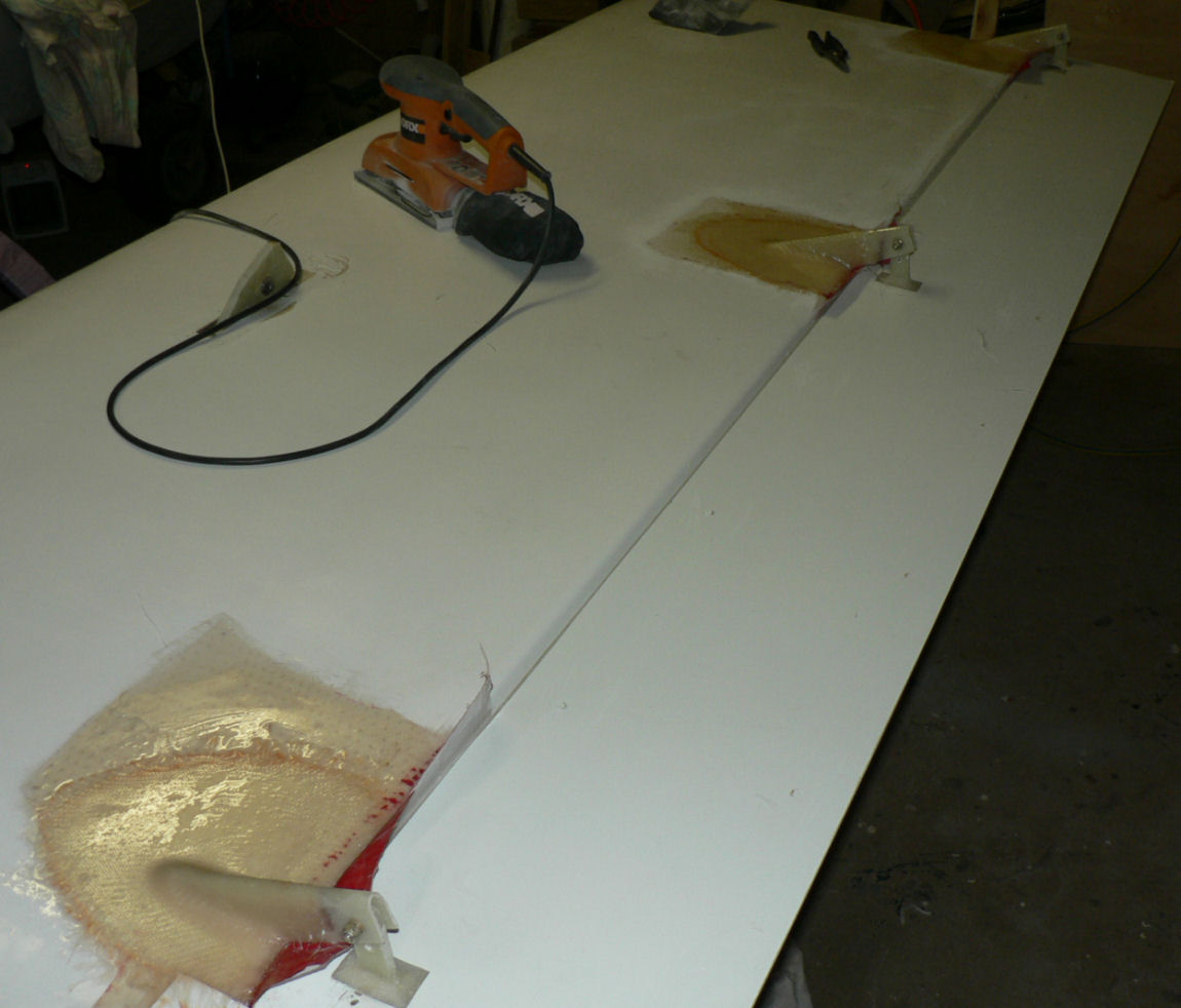

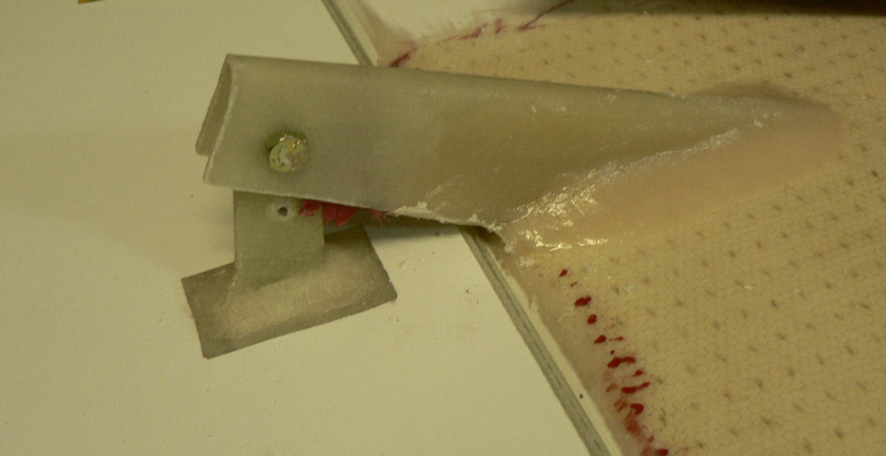

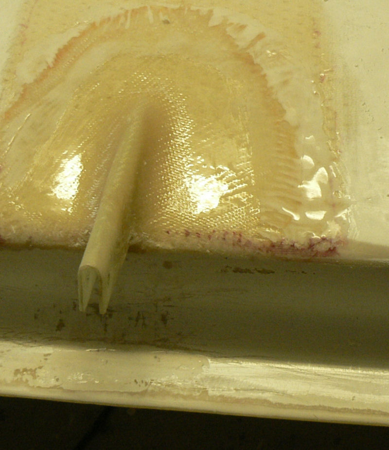

Apply three layers of REO cloth to RH wing flap lever positions.
As temp dropped below 20 degrees Centigrade by the time I had done the job I turned on the fan heater to low setting when temp was 19.9 at about 16:00. An hour later it was still 19.9 so turned it up to high.
Hopefully I will get it to set hard by midnight or so.
23:45 Temp 19.1 still dropping turned heater fan off. I will give it another go tomorrow when it is a bit warmer.
The epoxy is still soft but not sticky so needs more heat for some hours.
[ATTACH]2103[/ATTACH] [ATTACH]2104[/ATTACH]
RH flap with flap hinges with 3 layers of reo applied and epoxied
Peel cloth inserted between wing & flap to stop them being epoxied together.

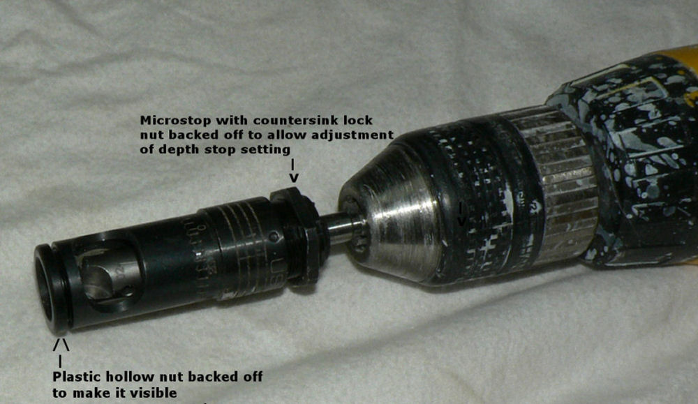

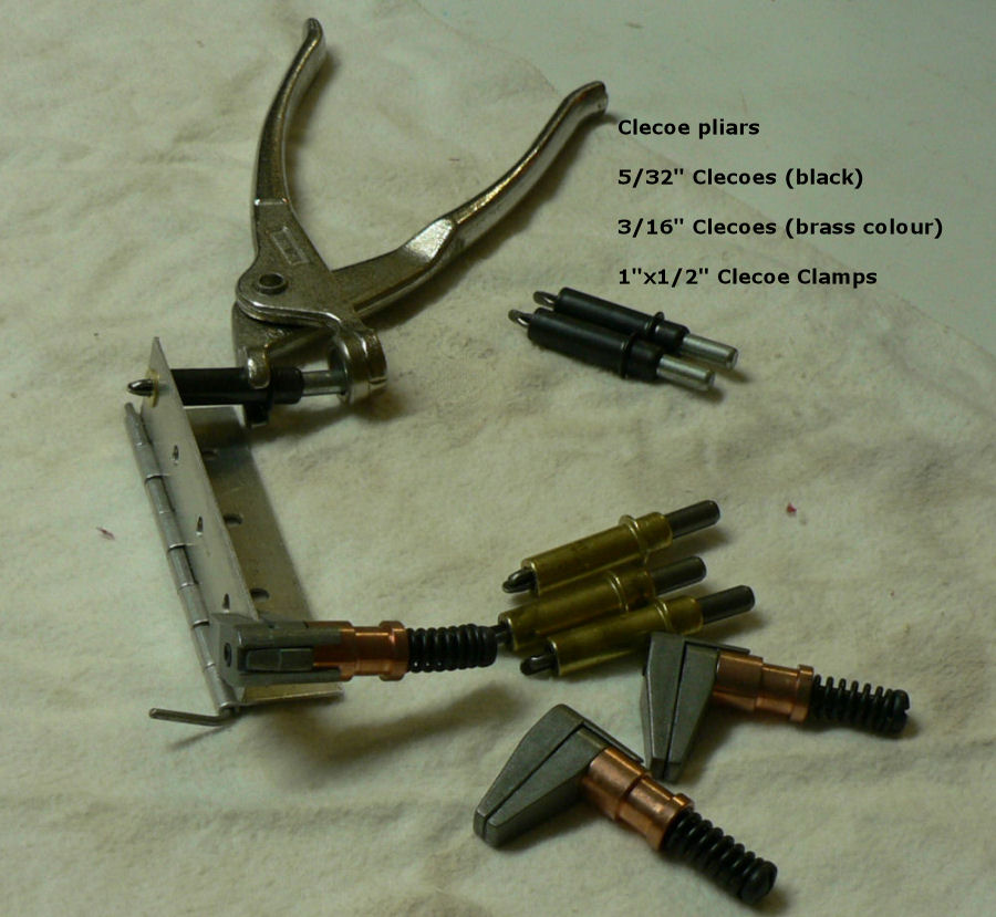

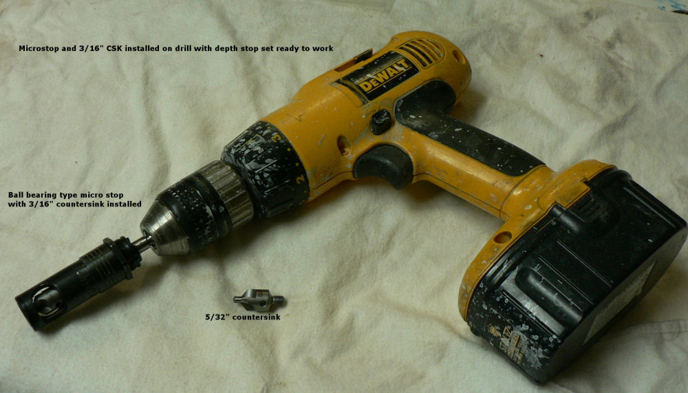

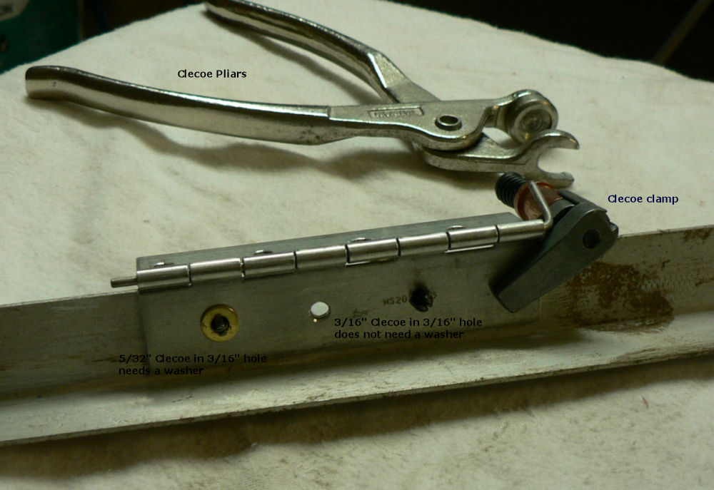

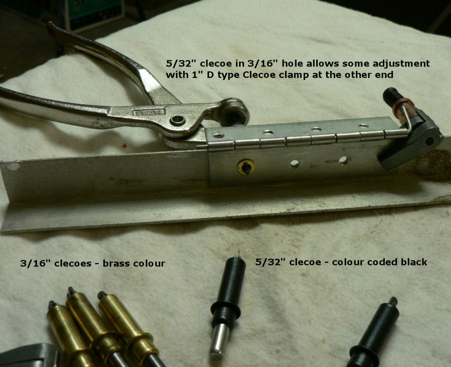

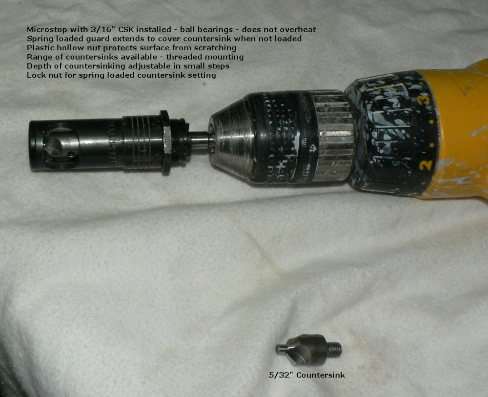

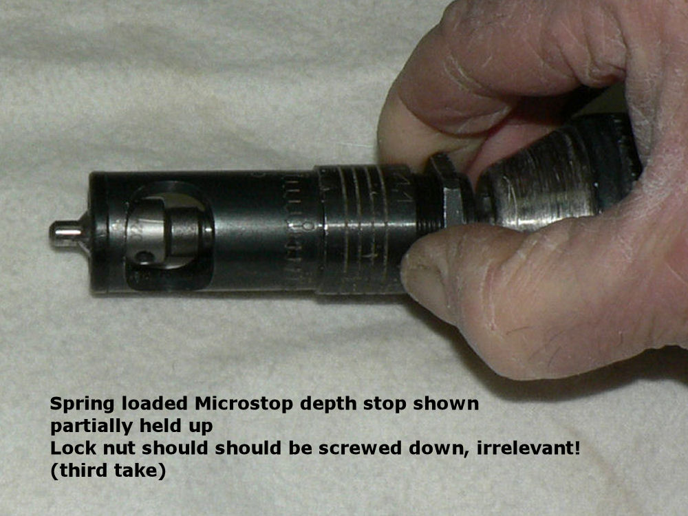

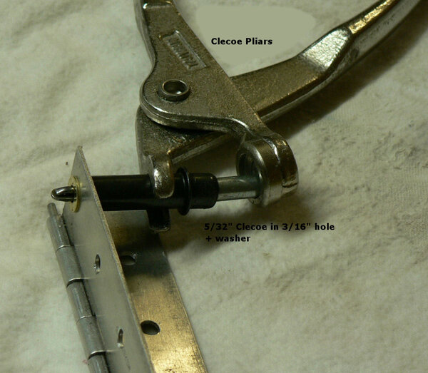

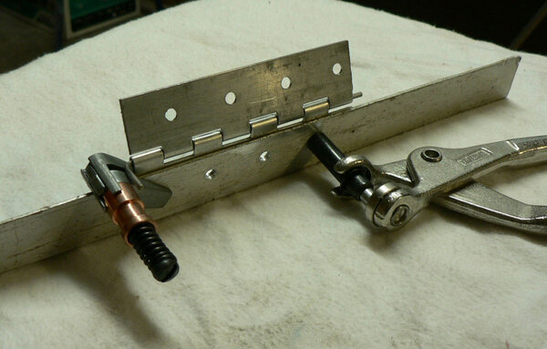

In the middle of last week I bought some 3/16" clecoes plus pliars and ball bearing microstop with countersinks and have some more 5/32" clecoes and a few clecoe clamps on order. I have used the 3/16" clecoes half way through setting up the RH wing aileron hinges.018_hug.gif.8f44196246785568c4ba31412287795a.gif
These tools just make the setting up of the Jabiru flight control hinges so easy compared to how I have been doing them. I just wish I had them from the start of the project but I really did not know how useful they were or how they worked.

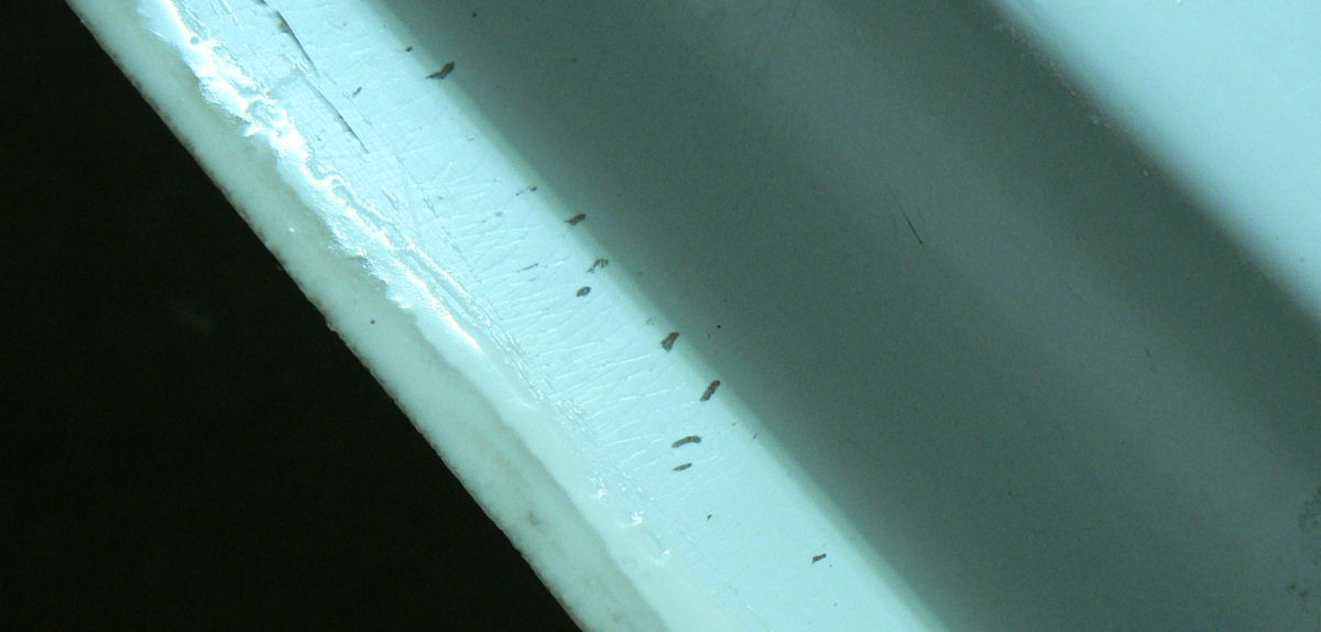

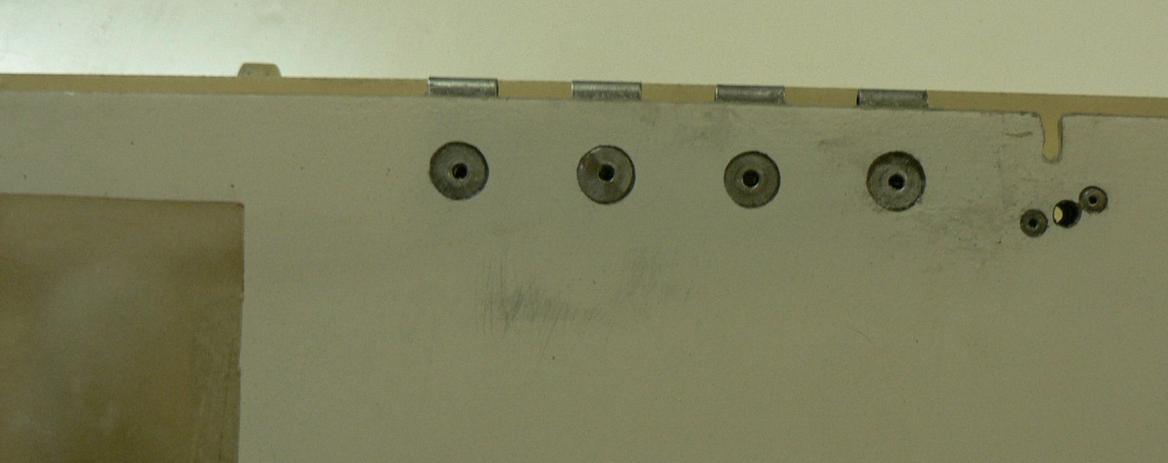

[ATTACH]2215[/ATTACH]
RH Wing middle aileron hinge and sharp edge below filled with epoxy microball before dressing up
[ATTACH]2216[/ATTACH]
RH Wing sharp edge behind flap position filled with epoxy microball before dressing up
Biggest problem in the garage at the moment is keeping the temperature as much above 16 deg C as possible and preferably around 25 C during epoxy curing sessions. At the last look it was sitting on 21.1 C and slowly dropping despite the heaters. Another hour or two and it will be cured enough to be safe and will be boosted as other items are completed and epoxied and then cured.
It was still holding 21.1 C at 23:30 when I turned off the heaters and the epoxy was quite solid. After November temperatures of as much as 40 C in the garage will contribute more to that curing but a nuisance as it goes off sometimes faster than you want if you are doing a long difficult job.
Regards
1534266906_J160RHWingEdgeAileron_20070603017.thumb.jpg.a634698804c5b804eb08568e8c42bc80.jpg
2016674036_J160RHWingEdgeFlap_20070603012.thumb.jpg.ff47d34f16c4094a78dd966f671b457a.jpg
Clecoes, Clecoe Pliars, Clecoe Clamps
some shots of some clecoe tools
[ATTACH]2230[/ATTACH] [ATTACH]2231[/ATTACH] [ATTACH]2232[/ATTACH] [ATTACH]2233[/ATTACH] [ATTACH]2234[/ATTACH]
819082933_J160ToolsClecoesPliarsClamps20070604_001.thumb.jpg.dab443f46d87b45692eeefe498e94912.jpg
1678171375_J160ToolsClecoesPliarsClamps20070604_002.thumb.jpg.0bf0c56a6a77c6fc7a95c81ced2ffc8c.jpg
1753308036_J160ToolsClecoesPliarsClamps20070604_003.thumb.jpg.5459f362d501f4a7d07ad8e680ae9c0c.jpg
1781424524_J160ToolsClecoesPliarsClamps20070604_004.jpg.f7fea841d3e2143dbb0e54a6a94a2fbe.jpg
124115434_J160ToolsClecoesPliarsClamps20070604_005.thumb.jpg.f199c6eb90ed168812522ef59e1d5505.jpg

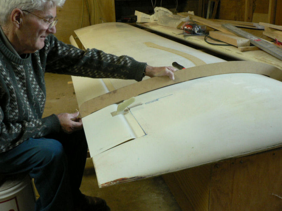

RH wing + LH Wing
Rough dressed the RH flap trailing edge & around flap brackets
[ATTACH]2237[/ATTACH]
[ATTACH]2235[/ATTACH] [ATTACH]2236[/ATTACH]
Stripped Peel cloth from LH wing for flap hinge positions & aileron mounting position and cut out access hole for aileron cable clamp installation.
620040828_J160WingLHRemovePeelCloth20070604_001.thumb.jpg.d67cdd550f4fd05261a4db49f14072b4.jpg
1566812391_J160WingLHRemovePeelCloth20070604_002.thumb.jpg.9e92f948853eb5c2d8911b2ae5dfcfbc.jpg
1400226467_J160RHWingRoughdressing20070604_001.thumb.jpg.2f46216abb6586661336a2a84f1a97dd.jpg
Microstop with Ball bearings
This tool makes countersinking a much happier experience 018_hug.gif.8f44196246785568c4ba31412287795a.gif
[ATTACH]2238[/ATTACH] [ATTACH]2239[/ATTACH] [ATTACH]2240[/ATTACH] [ATTACH]2241[/ATTACH] [ATTACH]2242[/ATTACH]
Major tip: Only do the lock nut up with "fingers torque" set on low.
Viewing from the drill motor side:
Turn the Lock Nut Clockwise to release it
540465353_ToolsMicrostopballbearing20070604_001.thumb.jpg.2a7dcf77f1027b42b6e11d7cc0d1eca5.jpg
2142490465_ToolsMicrostopballbearing20070604_002.thumb.jpg.02950977cee2a305c5df82acee578c12.jpg
315665369_ToolsMicrostopballbearing20070604_003.thumb.jpg.d4b696690f5915bb5eb9b4237e0e5ce1.jpg
995462006_ToolsMicrostopballbearing20070604_004.thumb.jpg.434ae61d8367e17d4a1b0c4ea6c073fc.jpg
224992978_ToolsMicrostopballbearing20070604_005.jpg.216ea32ae11176c41cbf79fa156959b3.jpg

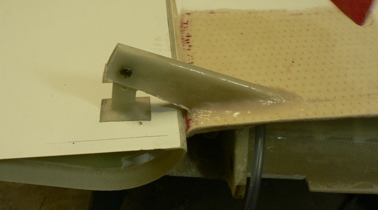

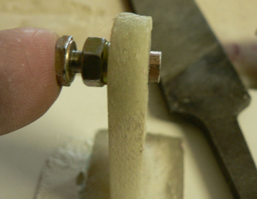

Prefitting the RH Wing and LH Wing aileron anchors
[ATTACH]2260[/ATTACH] [ATTACH]2261[/ATTACH]
Now that I have posted these two photos I can see that the two anchor setups are radically different.
They may or may not be OK. I will have to trial fit the cables to see if the mounting holes need shifting to get full aileron movement which cannot be done for the left wing as the aileron is yet to be mounted with its hinges.
I already had to move the LH wing 38 mm anchor bolt access hole to match the location of the anchor bolt holes and to place it closer to the mounting plate to facilitate getting a spanner on the end of the bolt. The sunken rectangular shaped inspection hole is a different distance from the aileron mounting position and the trailing edge of the wing compared to the RH wing.
The slot for the LH wing aileron cable exit is not yet cut.
I cannot check all this until the LH wing has flaps & aileron mounted.
