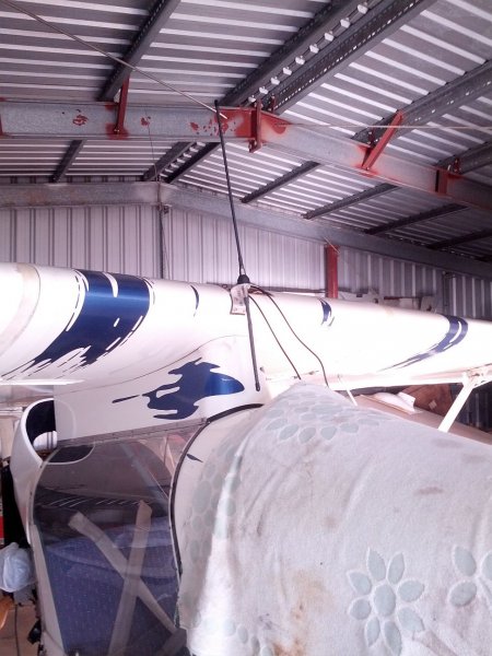

I'm using a Vertex handheld in a streak shadow, and have no problems with others hearing my transmisions when on the ground, even when taxying. When I'm flying, I can hear others quite well, but it seems others cannot hear me.
i'm using a coax feed from the radio to a whip antenna, and the antenna grounded to the metal boom tube (so technically not a good ground plane, i suppose).
Anyone have any ideas what the problem might be? I may replace the antenna with a dipole type, but the bottom section of the new antenna would be next to the boom tube, so dont know if that would be satisfactory.Any thoughts?

If you're using a quarter-wave whip without a decent ground plane (metal plate or whole fuselage), the signal is probably heading for space instead of horizontally or downwards.

Thanks to all for your suggestions,but especially to Kyle, who took time out to look at the aircraft. It does seem that the antenna's ground plane (the aircraft boom) is fairly unidirectional, as well as very inefficient. So either a new ground plane, or a ground independent dipole antenna is in the offing.

Hi Dave. I bit the bullet, and bought an AirKit ground plane independent antenna a while back - it fixed the problem, and now I have great Rx and Tx performance.
