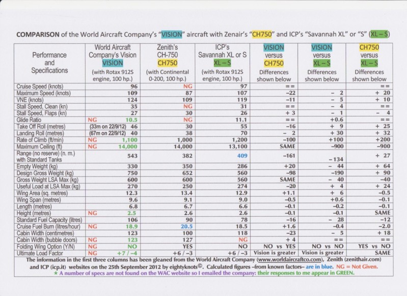

eightyknots Posted September 25, 2012 Posted September 25, 2012 I find the World Aircraft Company's Vision aircraft an interesting plane, designed by Max Tedesco. It's quite an interesting exercise to compare this with two other planes that Tedesco had a hand in designing: the Zenith CH-750 which was a design based on the CH-701. The 701 was co-designed with Tedesco and Chris Heintz almost three decades ago. Tedesco then designed a "new and improved" version of the plane, the MXP series which ICP somehow got hold off. This is the basis of the original ICP Savannah. The Savannah itself has undergone changes recently and morphed into either the square fuselage XL or the round fuselage S. I started to draw up a comparison of the three planes when I realised that the World Aircraft website only had limited specifications published on it. I emailed them and today I received enough info to compile this comparison. I trust this will lead to some interesting discussion among interested Forumites

eightyknots Posted September 25, 2012 Author Posted September 25, 2012 In my opinion the CH-750 is clearly the inferior aeroplane out of the three. I couldn't get any official figure on the CH-750s glide ratio but I read of one owner's experience on the internet a few months ago and I understand the glide ratio was pretty poor. The take-off and landing roll is better for the Zenith than either the ICP or Vision but in almost all other respects it ranks third, in my opinion. I also found out -via email- that World Aircraft Corporation won't support 'alternative' engines such as the Viking; they only support the Rotax engines. PS: I often wonder how a Sav/Viking combination would go. To me, 110 hp with a better fuel economy for only an extra 6-7 kg is pretty good. Someone in the USA did it, they were taxiing it on youtube but I never heard whether (or how well) it actually flew. 1
