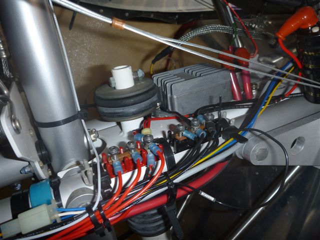

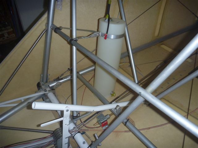

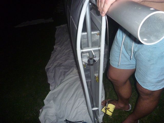

These are images of the collector / surge tank fitted, the fuel tank fitted into the wing (note retaining clamps not yet adjusted) and some images of the buss bar and some wiring.
The tank seems to be a little bit too far to the rear. normally align the front of the tank with the stitch line in the lower wing fabric. it is not critical but the tank will probably fowl the upper wing battens in that position. Greg.

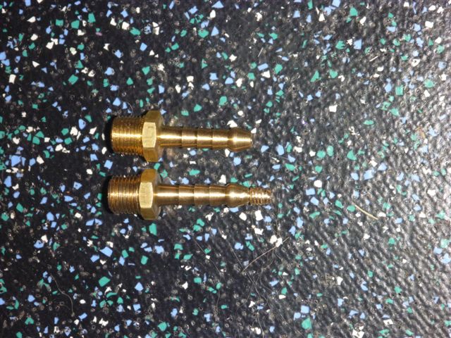

Made the fuel return line 3/16" barb and pressed the restricter into the end [ see comparison in image of a standard barb and one with the restrictor pressed in]. This makes it obvious as to which is the return line.

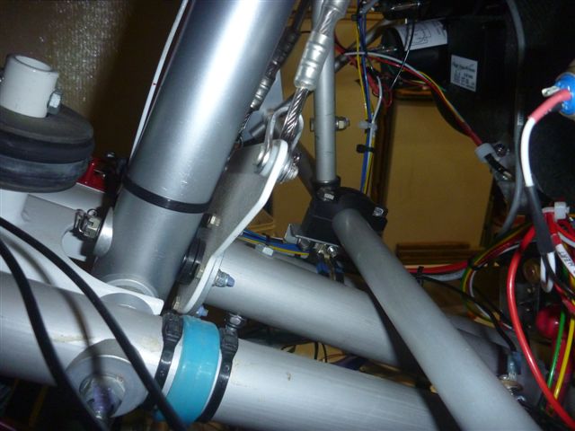

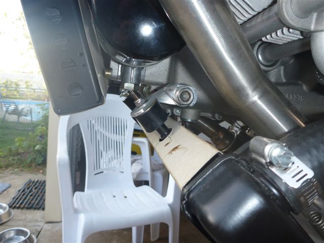

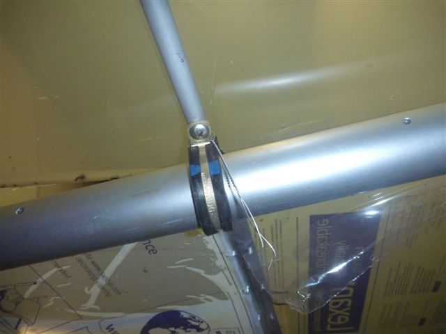

Also used a WDG pipe clamp and a nylon tube block to support the mid section of the throttle torque tube against bending movement when working against the carb throttle spring action; it rotates freely for throttle control and also attached is a smaller 'P' clamp to hold the wire harness away from the aileron bell crank.

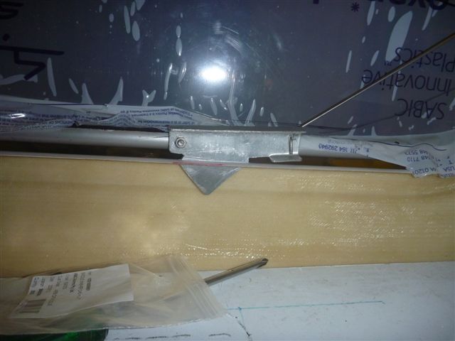

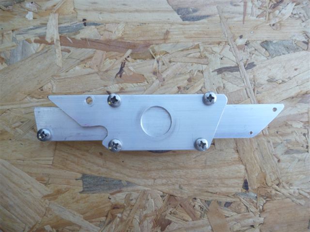

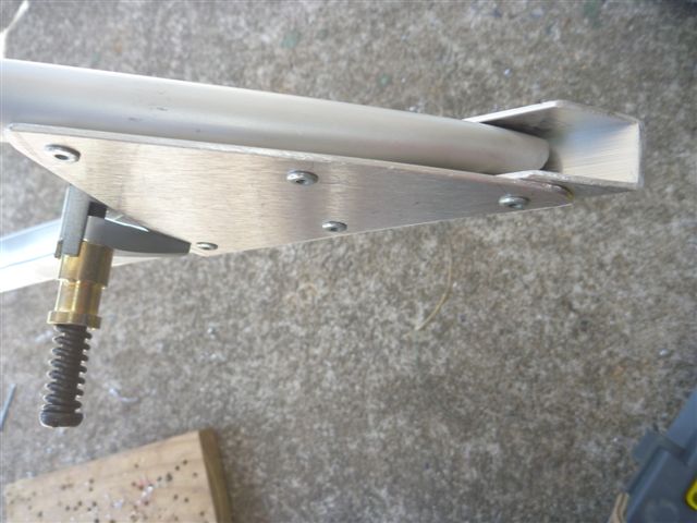

Hi Chris

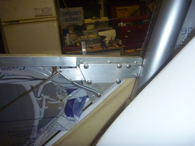

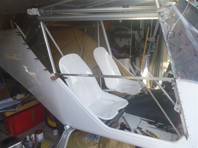

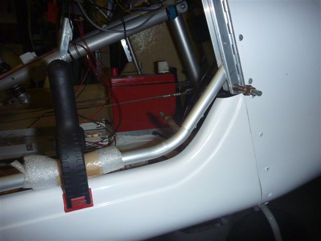

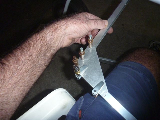

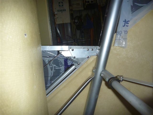

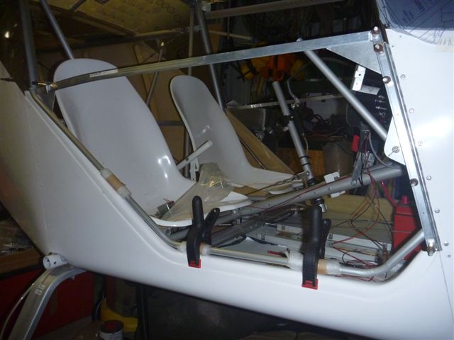

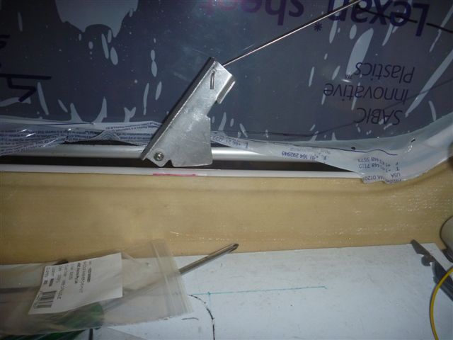

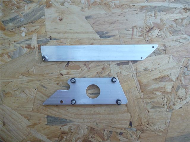

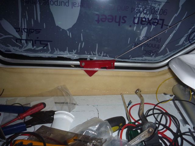

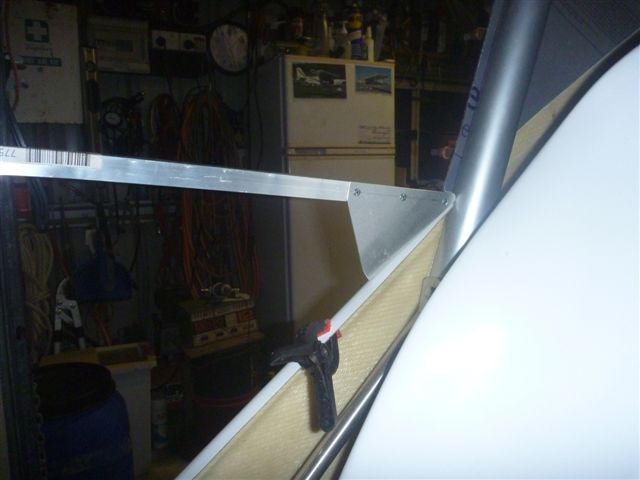

These are some images of door and latch setup.
Re the door 16mm 'U' aluminium used for the upper frame and forward door frame piece that hinge rivets to. The front end of the top piece is cut so the top is intact and the two side are bent to tuck inside the hinge 'U' piece. Also the round bottom piece is squashed a bit to fit inside the 'U' at hinge. (You will see this in one of the inmages.) and then secured with a counter sunk rivet.
The Lower red latch is pivoted up to unlock the bottom and then pulls the rear latch tounge away to allow the door to open. I havn't fitted the lock striker plate lands as yet but you see the method.
Let me know what you think.
Cheers Mike

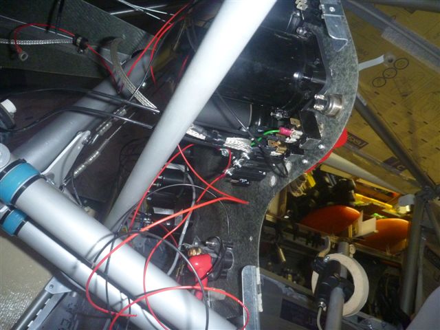

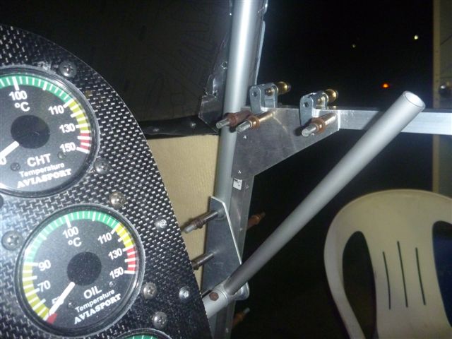

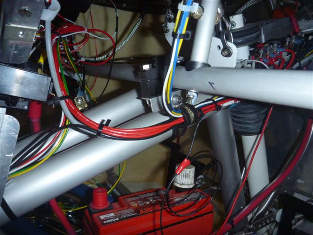

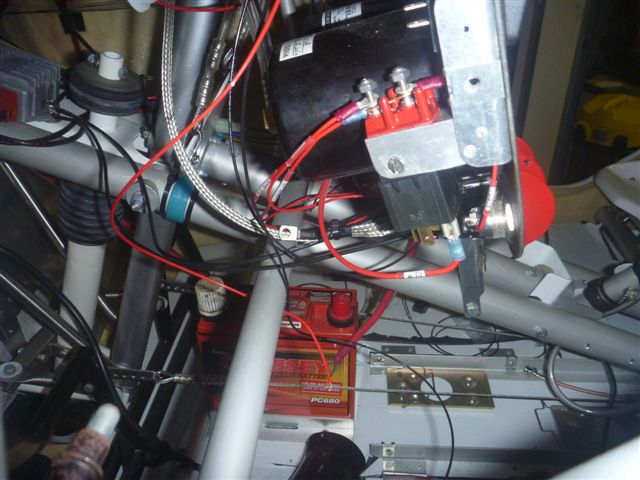

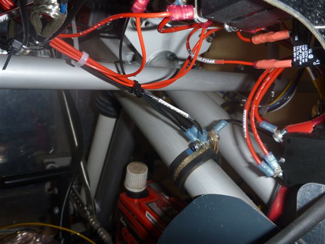

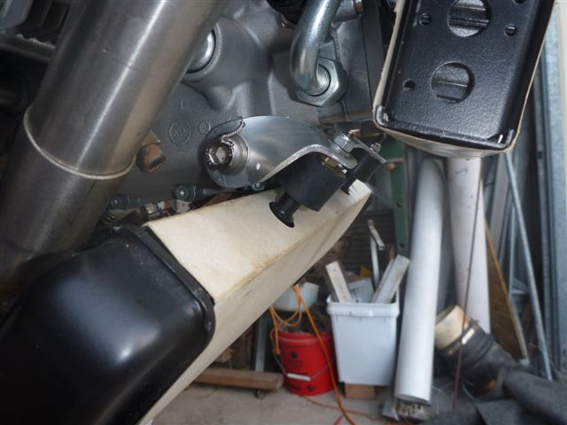

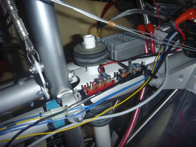

Redid the radiator mounts to allow for engine movement. And have the grounds going to three main posts; one behind panel, one behind seats and another buss bar as the main. [Note the grounds arn't tightened as still finishing off the wiring.]

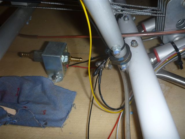

Looking at the fuel pump, is that a Facet Automotive fuel pump?
Hi Geoff. Yes, solid state, its the low pressure one that they use for the Rotax's.
Regards
Mike

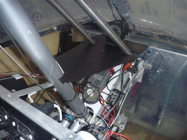

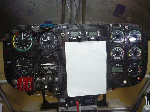

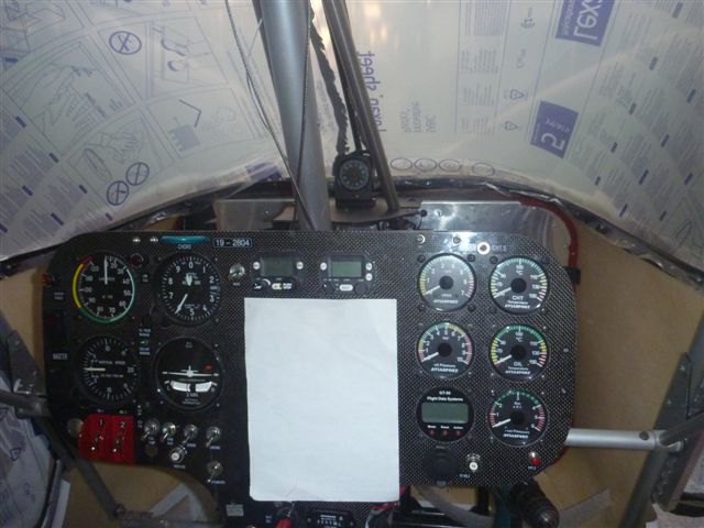

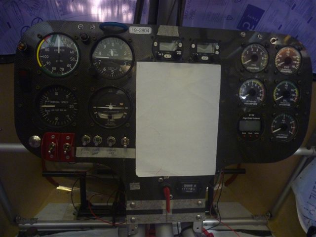

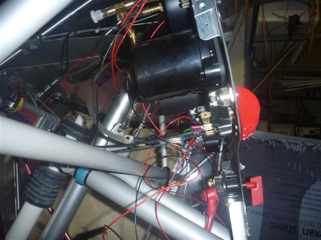

Getting on with the panel, labled up some bits so now know what's what:)
Hoping to complete the checking and test of wiring this weekend and then power up some of the panel units.
Wow! The panel looks great Mike!
Thanks Scott.
Getting there. I've got tomorrow and all next week off so should get alot more done. I'll work on some small things tomorrow and clean up then on Saturday I'll start on the checking and testing of the wiring and should finish by Sunday. Not hurrying anything. Only have half a day Sat; mates birthday catchup.
Don't want any smoke, sparks or sizzle when bringing on the volts.

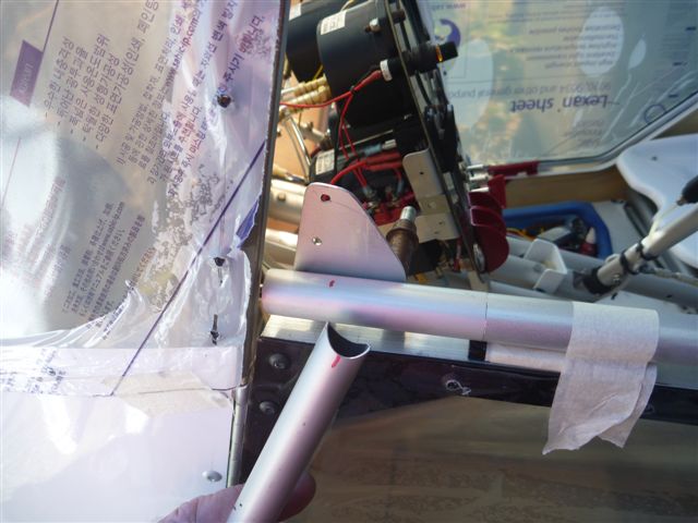

Then I'll look at finishing that centre tube for the windscreen at the front centre and to the back tube. then fit the prop and read up on the engine sb's and initial sart prep procedures; so hoping by the next weekend may have done a start up. Its still at home and aiming for everthing ready just after mid August.

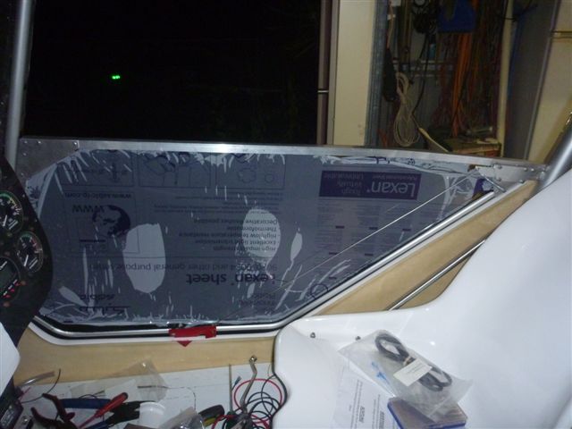

I put did silcone under the lexan for the windows etc.

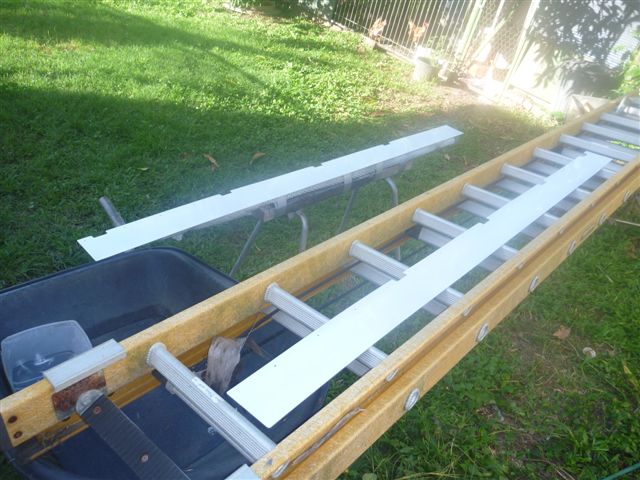

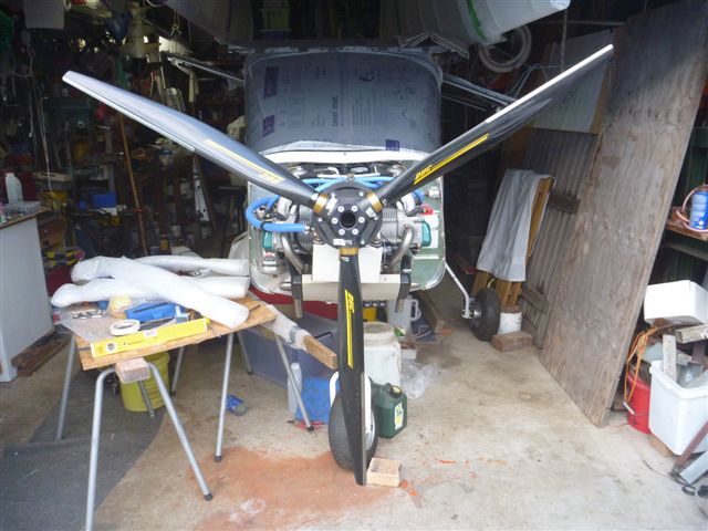

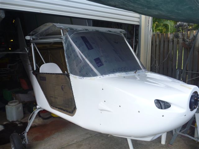

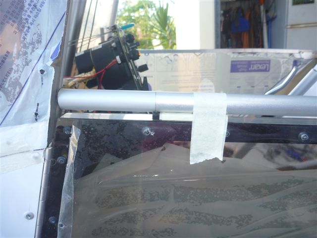

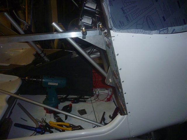

I got the 5 pin relay today. Got a bit more done painted the flap fairing pieces, put prop on and pitched, put covering on the binacle top piece also got the centre support tube for cabin roof lexan / windscreen in place now.
Cheers
Mike
Looking kind of airplane-ish now mike! Won't be long before that bird takes to the sky where she belongs.

Did you get a socket for the relay? You can connect the relay with just the utilux connector pins on the wires, but a socket makes replacement, or removal for troubleshooting much easier.
Hi Scott
No did not get a socket; I will next time in town. Did you mount yours on top of the whiye steel support forward of where the front wheel supension o rings are?
