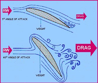

Ballpoint 246niner Posted July 15, 2012 Posted July 15, 2012 Best angle will give max height for a given distance, perfect for clearing obstacles etc but while lift is greater- so is drag so we now have a situation where thrust is losing the battle over drag therefore airspeed is now declining. Starting to make sense?, get your CFI to explain with pics, if necessary of lift/ drag curves and where the polar curves intersect. Â

djpacro Posted July 15, 2012 Posted July 15, 2012 best angle of climb is a steady state condition therefore sustainable (until the ceiling is reached) but in many airplanes not a good place to be at low altitude with engine problems  1
