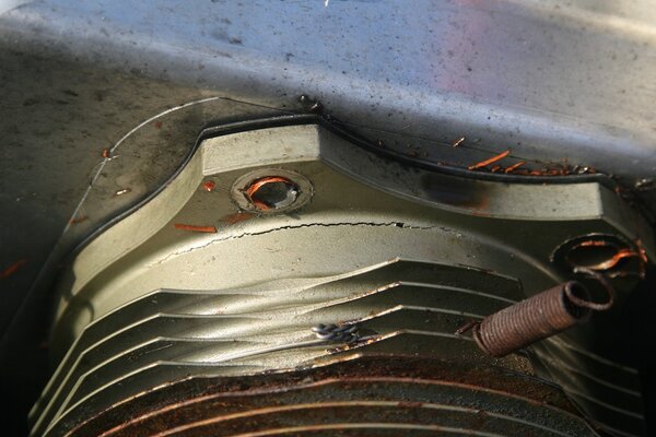

For those that are interested, heres what the cylinder looks like when this occurs.[ATTACH=full]17404[/ATTACH]
Look at the silastic around the cylinder base. How the hell can you torque a cylinder head bolt if you have squishy stuff in between the mating surfaces?
This is what I have said before, and what Motz also said - Jabiru won't listen to those with experience in engine asembly. If they did, they would drop the use of silastic; torqu down onto metal-to-metal, and the problem would go away.
As for detonation - the jabiru con rods aren't strong enough to withstand bad detonation. They would bend.
What's an easy way to see if detonation has occurred? The top of the piston will not have the usual combustion deposits on it because the shock of the detonation will blow the scale off the top of the piston
