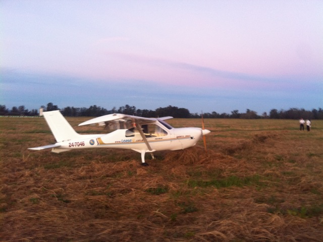

jetjr Posted May 8, 2012 Posted May 8, 2012 Call me an idiot BUT if its true there was maint done 19hrs prior, an unintentional mistake is pretty likely. Isnt the first 50hrs to 100hrs after major work a "red zone" for engine failures? Older Jabirus had fibreglass mount to front leg and the leg was much smaller, more problems then A big point here is an aircraft had a forced landing and no one was hurt, well done. 1
turboplanner Posted May 8, 2012 Posted May 8, 2012 I wouldn't be worrying much about the flip over the nose wheel. The land around Mildura is very rough.
damkia Posted May 8, 2012 Posted May 8, 2012 Call me an idiot BUT if its true there was maint done 19hrs prior, an unintentional mistake is pretty likely.Isnt the first 50hrs to 100hrs after major work a "red zone" for engine failures? Older Jabirus had fibreglass mount to front leg and the leg was much smaller, more problems then A big point here is an aircraft had a forced landing and no one was hurt, well done. Known as the bathtub failure curve http://en.wikipedia.org/wiki/Bathtub_curve

i_like_planes Posted May 8, 2012 Posted May 8, 2012 Yes, but does the nose-leg have to fail everytime they need to do an outlanding, as is often the case, and often with an experienced instructor flying ?......But yes always nice when all get out ok...........Maj... They don't always.. This one scorched a 400mm trench in the dirt for 20m and still hung on...
Bandit12 Posted May 9, 2012 Posted May 9, 2012 Given the number of fatalities in jab accidents that Turbs put up, I'd be happy to consider the nose leg a crumple zone in an out landing if it meant walking away. I'm not so sure about accepting the incidence of engine outs though...
