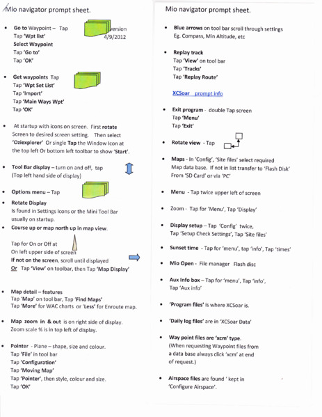

Blueadventures Posted September 5, 2012 Posted September 5, 2012 I have attached a copy of the reminder / cheat sheet for XCSoar that I share with some friends and also has Mio on it for WAC charts in Ozi explorer type programs. May be of assistance to people who are new to using the program. Cheers Mike Mio device prompt sheet 4.Sept.2012.doc Mio device prompt sheet 4.Sept.2012.doc Mio device prompt sheet 4.Sept.2012.doc

Blueadventures Posted September 6, 2012 Posted September 6, 2012 Hi Attached is the PDF version, page one in Black and white and page 2 colour. Hope its helpful. Cheers Mike
Blueadventures Posted September 12, 2012 Posted September 12, 2012 Hi Exadios Following is the words but the images did not copy over from the mio / xcsoar cheat sheet I did. If you still want a copy send your email details and i'll email it to you. Cheers Mike · Go to Waypoint – Tap version Tap ‘Wpt list’ 4/9/2012 Select Waypoint Tap ‘Go to’ Tap ‘OK’ · Get waypoints Tap Tap ‘Wpt Set List’ Tap ‘Import’ Tap ‘Main Ways Wpt’ Tap ‘OK’ · At startup with icons on screen. First rotate Screen to desired screen setting. Then select ‘Oziexplorer’ Or single Tap the Window Icon at the top left Or bottom left toolbar to show ‘Start’. · Tool Bar display – turn on and off, tap (Top left hand side of display) · Options menu – Tap · Rotate Display Is found in Settings Icons or the Mini Tool Bar usually on startup. · Course up or map north up in map view. Tap for On or Off at On left upper side of screen If not on the screen, scroll until displayed Or Tap ‘View’ on toolbar, then Tap ‘Map Display’ · Map detail – features Tap ‘Map’ on tool bar, Tap ‘Find Maps’ Tap ‘More’ for WAC charts or ‘Less’ for Enroute map. · Map zoom in & out is on right side of display. Zoom scale % is in top left of display. · Pointer - Plane – shape, size and colour. Tap ‘File’ in tool bar Tap ‘Configuration’ Tap ‘Moving Map’ Tap ‘Pointer’, then style, colour and size. Tap ‘OK’ · Blue arrows on tool bar scroll through settings Eg. Compass, Min Altitude, etc · Replay track Tap ‘View’ on tool bar Tap ‘Tracks’ Tap ‘Replay Route’ XCSoar prompt info · Exit program - double Tap screen Tap ‘Menu’ Tap ‘Exit’ · Rotate view - Tap · Maps - In ‘Config’, ‘Site files’ select required Map data base. If not in list transfer to ‘Flash Disk’ From ‘SD Card’ or via ‘PC’ · Menu - Tap twice upper left of screen · Zoom - Tap for ‘Menu’, Tap ‘Display’ · Display setup – Tap ‘Config’ twice, Tap ‘Setup Check Settings’, Tap ‘Site files’ · Sunset time - Tap for ‘menu’, tap ‘info’, Tap ‘times’ · Mio Open - File manager Flash disc · Aux Info box – Tap for ‘menu’, Tap ‘info’, Tap ‘Aux info’ · ‘Program files’ is where XCSoar is. · ‘Daily log files’ are in ‘XCSoar Data’ · Way point files are ‘xcm’ type. (When requesting Waypoint files from a data base always click ‘xcm’ at end of request.) · Airspace files are found ‘ kept in ‘Configure Airspace’.
