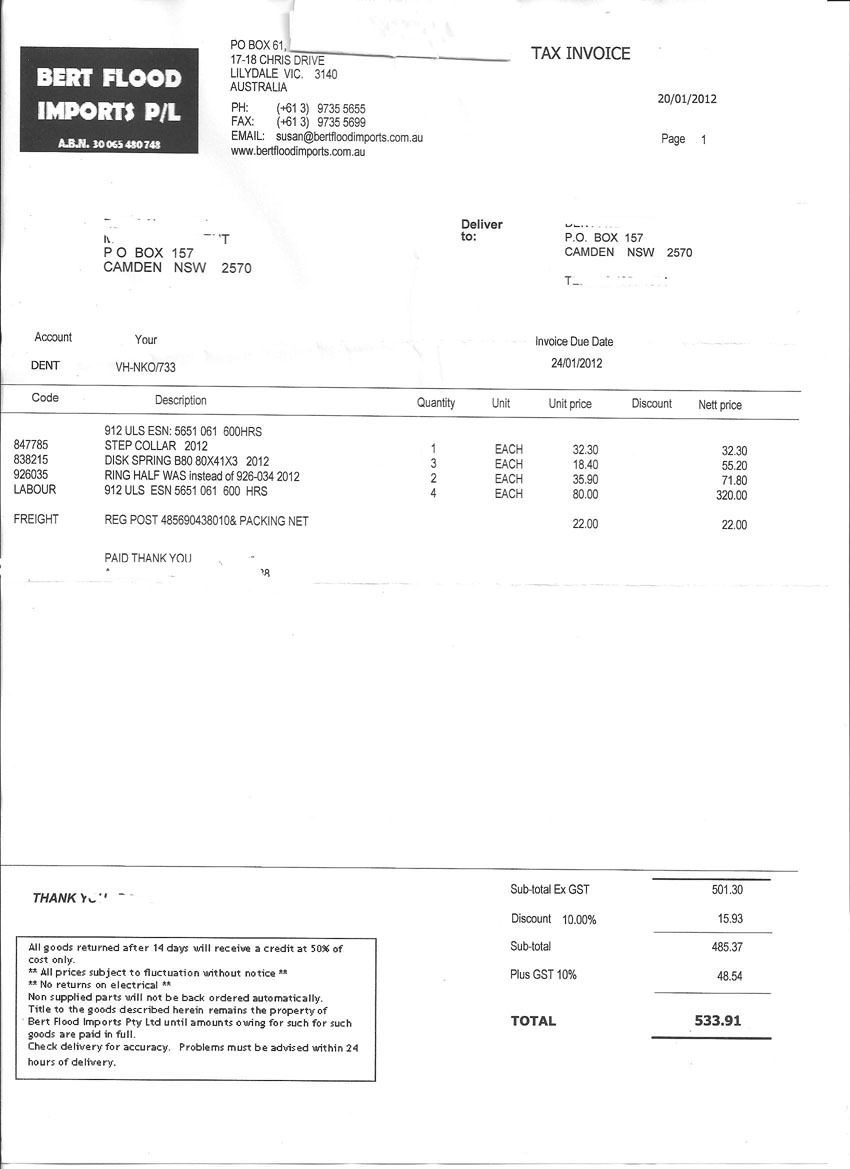

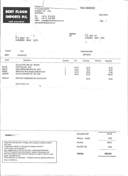

That gearbox arrived back from Bert Flood today. 600 hour inspection cost $535 including return postage. If I get a chance I'll copy the invoice and you can see what was done.
That means that gearbox maintenance would cost you just on $1 per hour (including an allowance for inflation).
OME
