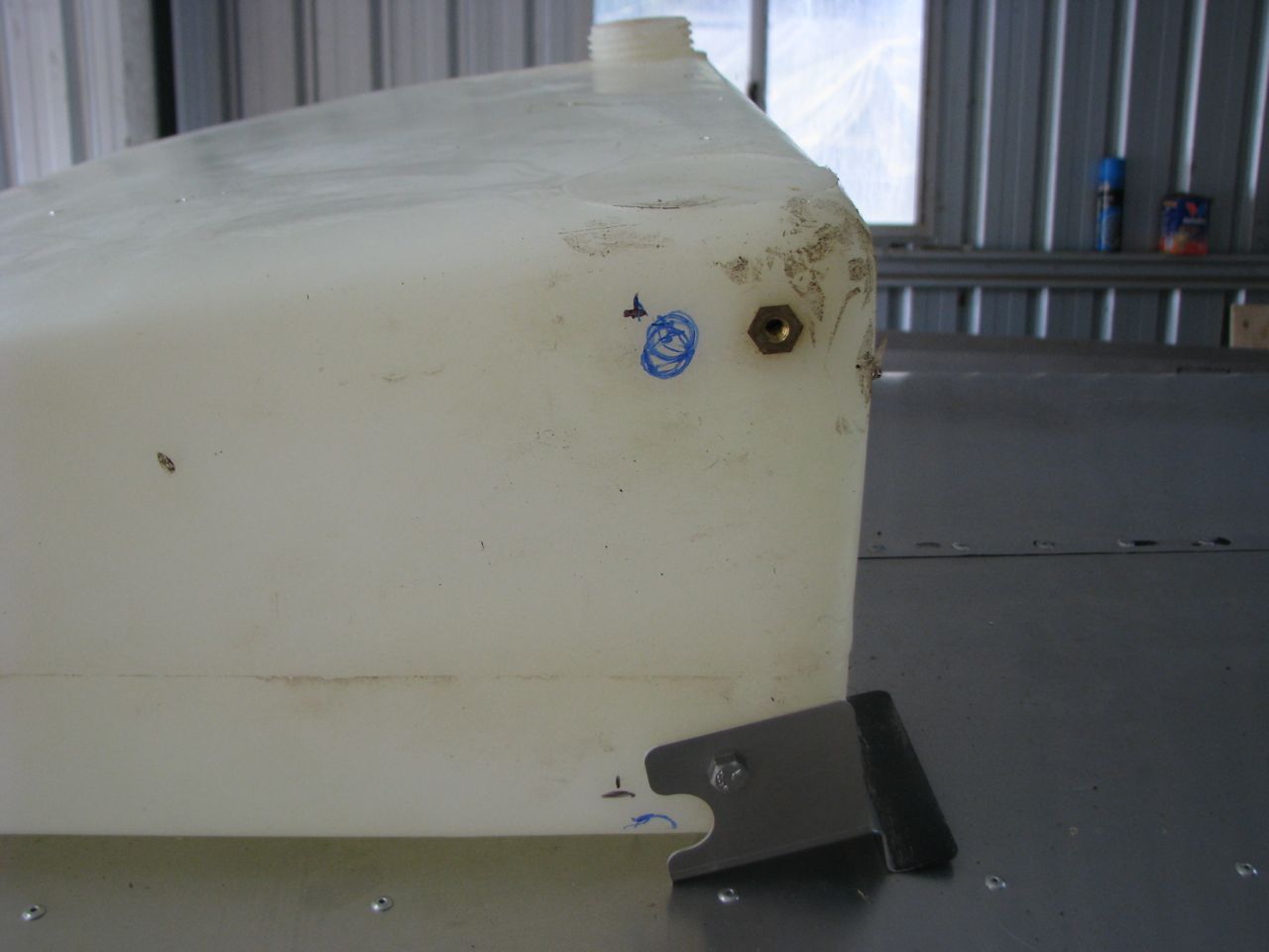

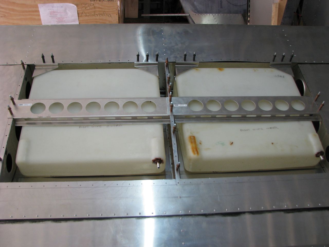

The Savannah tanks are a blown moulded plastic sort of tank. Don't know the actual material its made from but they feel nice and strong..and I have 4 of them in the wings total fuel is 140 litres
