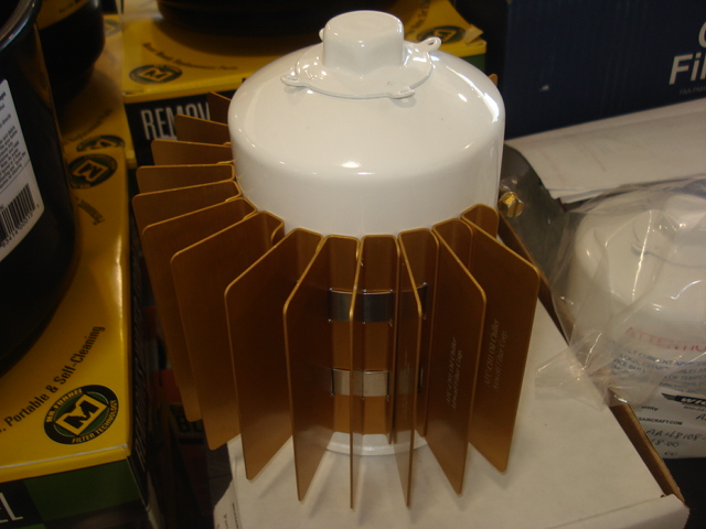

Guest ozzie Posted November 21, 2011 Posted November 21, 2011 Oil coolers in the big boys toys are flushed then X Rayed for metal particles/blockages. You can get a small ali tube and put a small slit in it and use it as a tool to straighten the cooling fins. Wasn't to impressed with those repco types when i replaced one on a jab storch. Better to get a custom stronger one built that's more efficient. I found these in my travels. oil filter cooler. Ozzie
