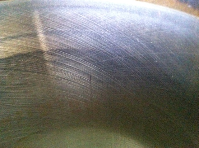

Tomo Posted October 24, 2011 Posted October 24, 2011 Just for interest sake, and or those wondering what we're on about... this is the cross hatch in a bore of a 436 International engine I rebuilt today. Believe it or not, this bore has done 11,000 hours, and look how good it is. Pity about water corrosion on the outside of the liner otherwise it would have lasted a lot longer. 1

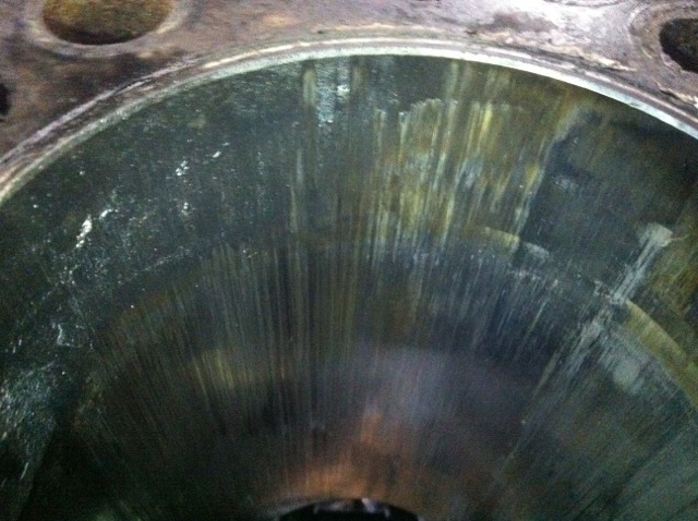

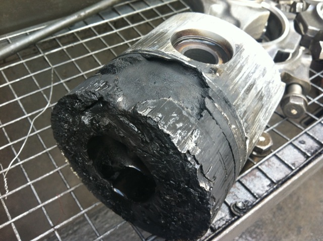

Tomo Posted October 25, 2011 Posted October 25, 2011 Not particularly relevant either, but since I was working on this today I took some quick shots with my phone for other to see what can happen... Hino truck engine. This is a pretty badly glazed bore Not real pretty in this one! And the consequential damage...
