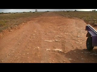

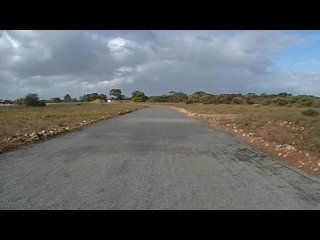

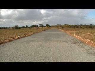

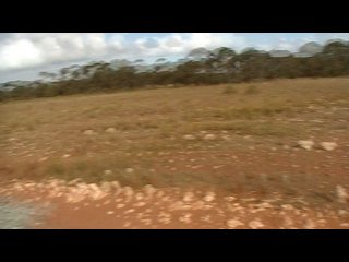

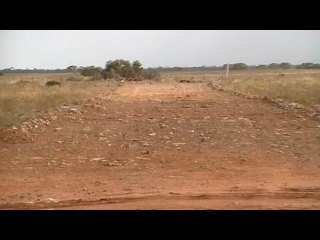

pics relly dont do justice but any way they show 150 mtrs of unsealed compact bitchumen and 150 mter of runway ready for gravel and bitchumen..no pics of widening yet....I have about 80 mtrs to go and now widen the whole thing so will be a couple months off finishing...ahhhh ....what a way to kill time.....bugger ............yep all by hand ,by myself, just me and my shovel,all alone,,no one but me,,,yep just little ol me...any one getting the hint??? lol

put some pics for up you

put some pics up of the runway for you

put some pics of the runway up
Thanks for the pics, mmmmmmmate your a legend. That's a lot of manual labour, but when a man's on a mission a man's on a mission.
Looks like you are going to have a great little airstrip there... especially incredible considering the hand tools!!!!
