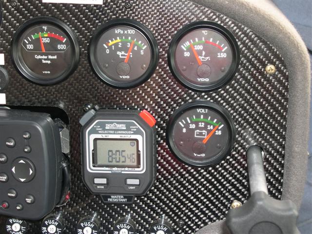

BC,
The temps you are looking for are I hope in the photo below. This was photo was taken when levelling out following take off climb to 1000ft - having throttled back to 2750rpm.
The aircraft had started out at 570Kg and had flown three circuits prior to this climb out and this photo. The airtemp was 27°C. I climb out at 80 knots

Alan, great thanks for that. Oil temp is about right. You wouldn't want much more than that, particularly at 27 deg as at 40 degrees things will start getting a little warm. Your CHT is quite high though given the conditions. There are a few little tricks you can use to lower that regarding the ram-air ducts if required.
Let me know if your oil temp gets up near 100 deg as there's a little mod that can be done to bring it down closer to 80.
I try to climb out a bit faster than 80 as it gives the engine a chance to rev out more which results in more power and better cooling.
Mine is the 400 short wing, however I try to climb out at 100 knots, rather than 80. 100 will actually give me a higher climb rate, although there's a small sacrifice in climb at first whilst the speed builds up.
