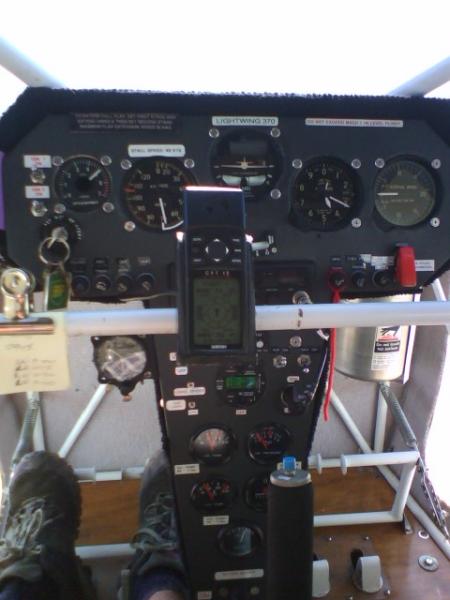

Guest Maj Millard Posted March 12, 2011 Posted March 12, 2011 I bought my aircraft with a Microair VHF installed with intergrated intercom. I then deactivated the internal intercom and installed a Sigtronics SP4 intercom, which is about as good as you can get, and the one everybody else has copied. I use cheap Xcom headsets (before Ian offered his) and these are the same as the Rec Aviation ones Ian now offers. The reception /transmit is clear as, at all times, both on the VHF and intercom. You could not possibly want better. Buying the world's best (or most expensive) headsets won't give you good radio/intercom if the system that they hook to are shxx. If the radio/intercom system is installed correctly, you'll get great performance, even from cheap headsets. I believe Ian now also offers the Sigtronics range of intercoms on the forum shop, and I can highly recommend them. The Icom 'flip-flop' panel mount is a good system and does give you the option of quickly changing frequencies. It is widley usd in GA aircraft, and is reliable. The latest Microair VHF does also have the same 'quick-change feature and also a second freq monitoring capability. As with any avionics installation, the wiring up of these systems is key, and must be done effectivly for top reliable performance with both radio and intercom. The Sigtronics website has all installation wiring diagrams which you can easily download, and in understandable format so you can actually follow, and come up with a professional installation that works. There is nothing nicer than crystal clear radio and intercom operation at all times, and nothing more annoying or distracting than a system that isn't up to scratch. They have all diagrams for most radio installations including Microair, Icom and Xcom etc.............................................Maj...
